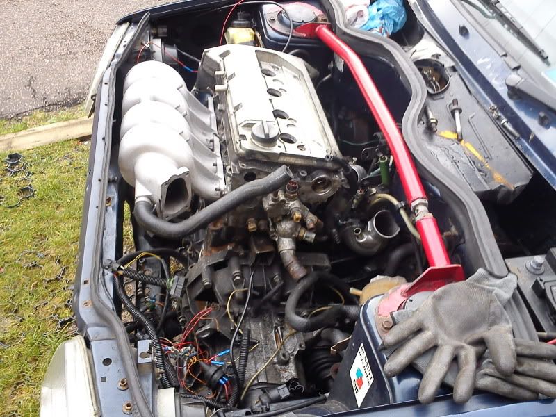

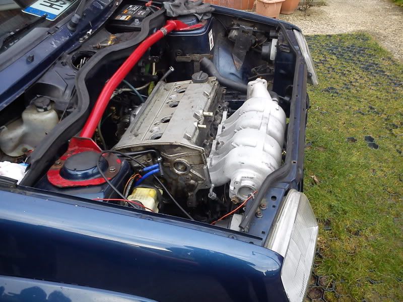

Complete engine & wiring loom inc the aux fuse box from a phase 1 as the ecu isn't coded. You should end up with a brown & white plug.  If you are taking the gearbox you need the clocks as well as they are cable driven & the GTT is electronic pick up.
You will need a GTX mount for the block, these are NLA from Renault so more than likely you will need to modify the GTT one, I will add pictures at a later date of my modified mount.
Manifold & downpipe will be needed as well unless you are going turbo  :twisted: .

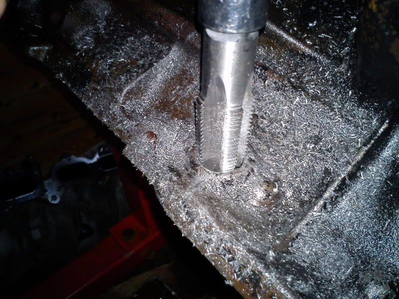

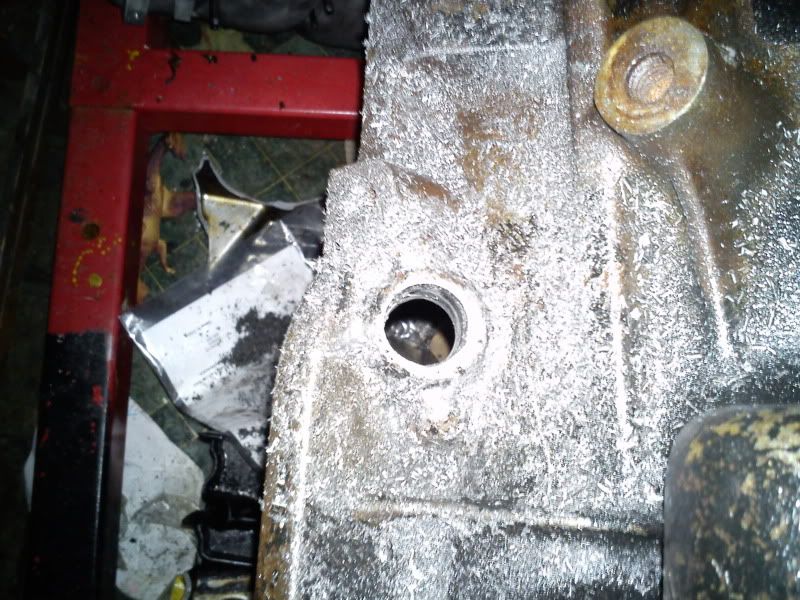

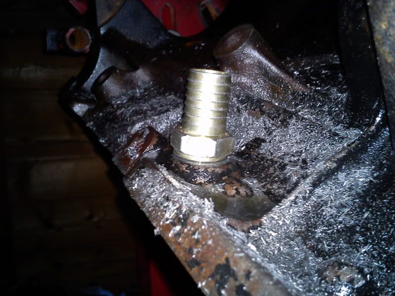

Oil drain for turbo conversion.
Hole drilled
1/2" NPT Tap
Oil drain fitted in place.
