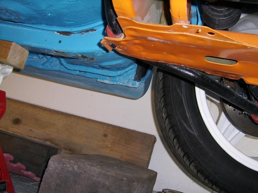

Managed to do a few bits today, applied underseal to areas under car that had come away due to my poor prep work :oops: it was mainly under where petrol tank would have been and then painted over once dry.

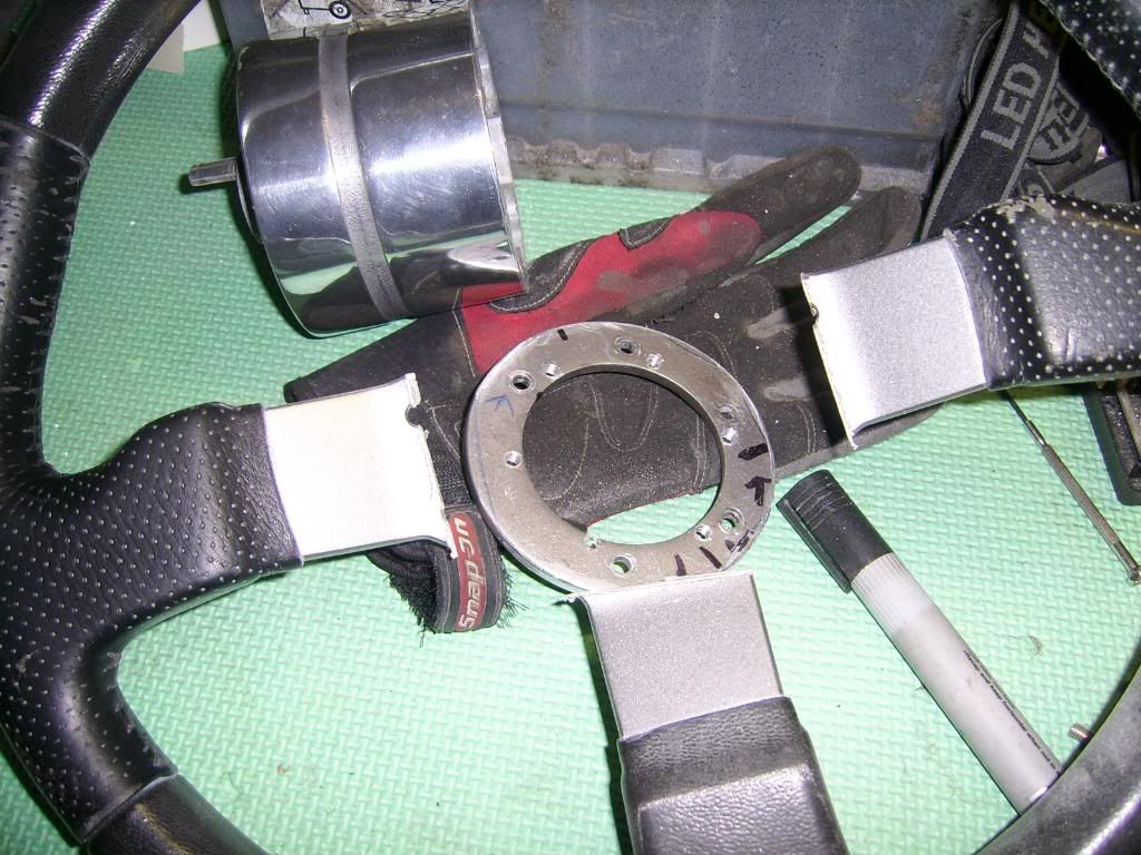

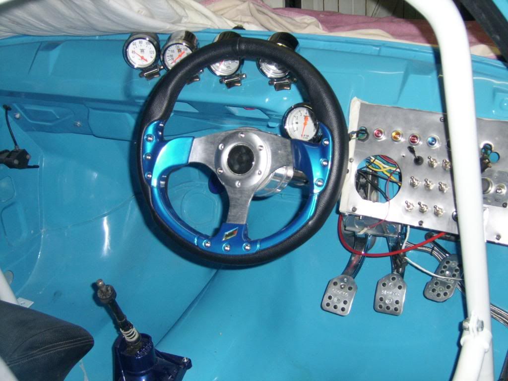

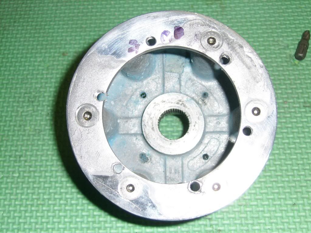

I bought a steering wheel ages ago thinking it would fit the gt boss but no it didnt  :roll:  , so i cut up the old gt steering wheel bolted that to boss & then tapped in new threads to then bolt new steering wheel in, also got the dremel out and done abit more polishing to the boss (i think ive got a bling problem )  :lol: .

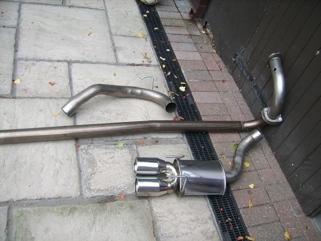

I recently bought a nye on brand new powerflow exhaust system on ebay only prob was it didnt marry up with me downpipe so i had to get it where it needed to be then bolt it up in position and get it welded so a big thanks to 5mission for welding it up for me cheers peter, i have got a lamba sensor thread to be welded in but i need to get some more drill bits to make hole bigger  :roll:, hopefully ill get that done and welded in by end of week. On that note im after a good 2nd hand afr/wideband thingymebob let me know if anyones got one for sale.

paint flaked off :x
undersealed and top coat put on :D
Err under car  :lol:  :lol:
cut out part of old steering wheel to bolt to boss
filed to size with new threads tapped in to accept new steering wheel :roll: all aggro
in car (switch panel is only a temp mock up will be using carbon fibre)

And to top it all off ive finally put exhaust on thinking it would be last time ( ive had trouble with this because main section was different size to downpipe and had to be welded together ) and have found that the backbox sits pissed so ive got to cut pipe off the backbox move it round slightly and get it welded back on but thats going on the back burner coz ive had enough of that exhaust for time being.
