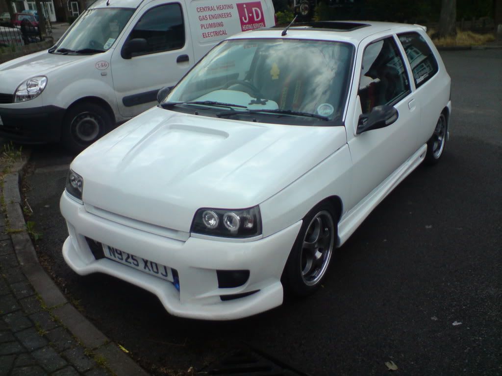

Here are afew pictures, not anything decent, will update tomorrow when uploaded the rest of the pics :)
Re: My GTT engined clio mk1
« Reply #1 on: 15:29, Wed 29 September 2010 »
Car doesn't look too bad on outside, very white! :D
A nice tudy up in the engine bay wouldn't go a miss though.  :wink:

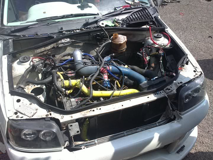

I hate to burst your bubble mate but the engine spec you gave, some of those bits aren't in the engine bay from what i see. I remember you mentioning it from the previous thread you weren't sure.
With that spec also 260bhp+ is very unlikely, did the person you get it off give you reciepts for it all at all?
I do hate it when someone gets stung into believing there car has this and that when its not even on there.
Do hope you don;t think i'm having a pop mate, just like to put people in the know :wink:

What doesnt look like its there mate?
I am greatful for you to be honest, i'd rather people be honest now and then atleast you aint fake ennit.
I got afew receipts like the pistons, rebuild and lil things like that, but half of what 'apparently' i got i never had receipts for so i aint sure what to say on that 1.

From the pic it has a standard intercooler, standard rad with the oil cooler pipes going to it still so no external oil cooler, turbo looks like a T25 size on front as i can't see any bolts holding the housing on, standard breather pot and swirl pot and no catch tank as you have a breather filter there.
what does the reciept say for the pistons by the way, does it mention forge items?
Sorry to put downer on it but as you say best to know what you exactly got rather then not knowing.

Ah yeah, the KTR intercooler isnt fitted currently (i have got it in my garage), a big silver thing lol), yeah its the standard rad with built in oil cooler so ive been told, ive got an external 1 but apparently its pointless fitting it, is that true? Thats the same situiation as the catch tank, i have 1 but apparently its not essental so any suggestios on them?
As for the turbo ive looked into it and it is a t25 mate, thanks for pointing it out :).
On the receipt it says forged internals, doesnt say what internals though.
