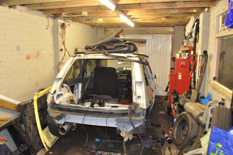

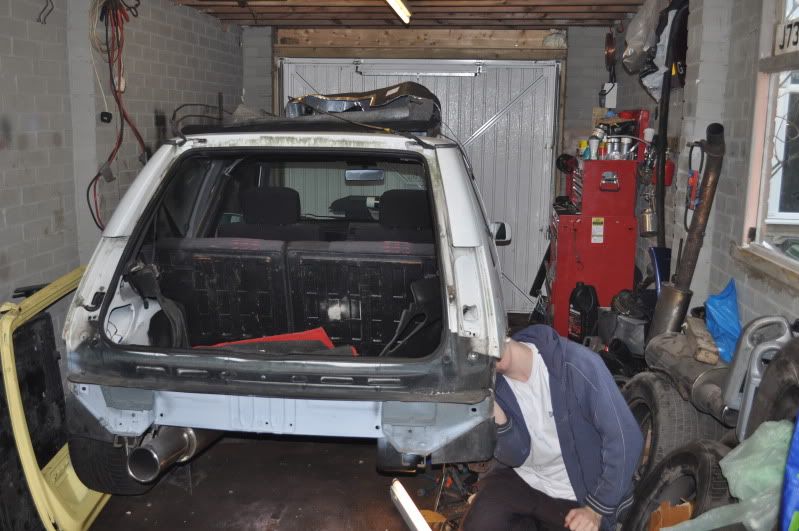

started working again now the snows over
Before
My little helper making sure i dont grind my fingers again
And After
Doesn't look like much but we've done a fair bit.

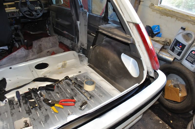

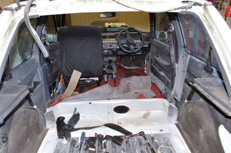

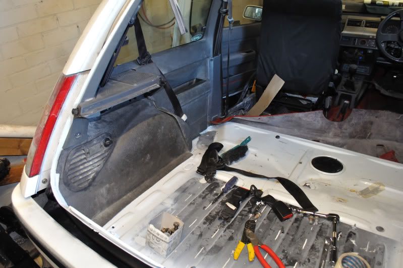

Removed the tailgate as its scrap but kept all the wiring safe.

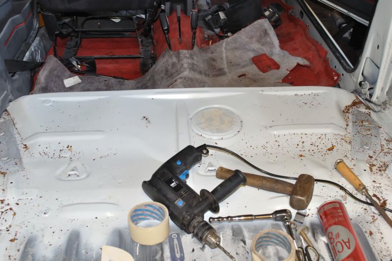

Removed the rear seats, drivers seat, boot carpet and under back seat carpet.
Removed the show roll cage.
Fixed the rust hole on the rear bumper mount and fuel filler neck mounting.
Fixed the captive nut so the bolt that holds the drivers seat frame to the body so it actaully screws into something and the seat dont flap about . :lol:
Hammered off all the renault sound deadening from the boot floor and rear arch sides.  :muahaha:

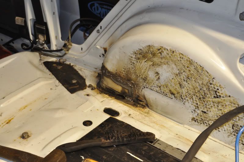

But i got pokey screwdriver happy and found another 2 rust holes
So i've crossed a few things of my to do list but added a few aswell doh!  :)
The worst rusty hole less than 1 inch away from the rear seat belt mounting point  :D
Some of the weld went shit near to the end as i ran out of gas and the gas regulator packed up  :x
This is just the inside part of the panel i've fixed, got to do the part in the wheel arch tonight  :)
Oh and you can see where i removed some of the sound deadening on the arch and floor

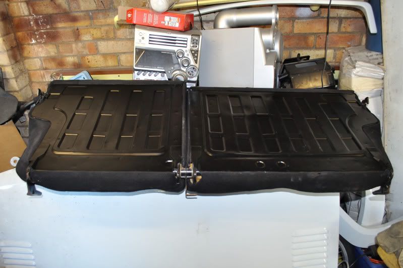

Rear seat backs repainted black
Interior going back in

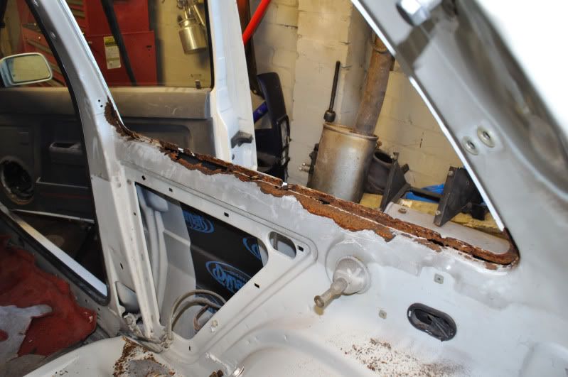

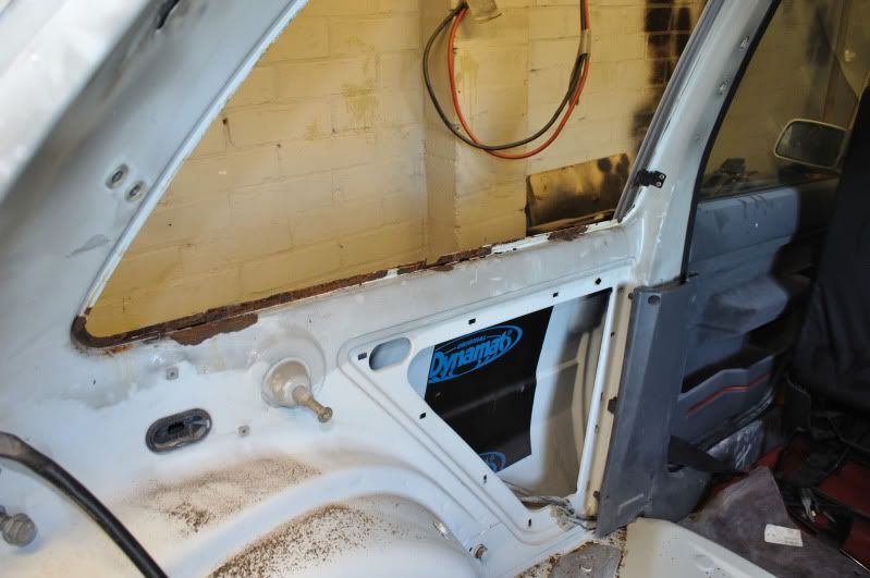

Took the rear windows out to change the 3 little rubber bits and well i'll let the pictures do the talking.......
My newly paint floor is going to get ruined :( even tho it'll be recovered in sound deadening anyways
Looks like the welder is coming out again..... surely there cannot be anymore rust after this?

My rear windows went like that, not quite as bad though.
I had no idea until it went to be painted and i pulled the rubber off, a load of red dust just fell out.
I'll have to check my rear arches, not the first time i have seen it in that place and the tin worm on mine is cropping up all over the place.

Pretty much got the drivers window bit all fab'd up out of metal and clamped up in place just needs welding into place. Glad i found it now before we took to the car to be resprayed

Driver side has all been welded and fixed just needs some paint, welding took quite a bit of time having to let the panel cool down so it didnt warp but its looks fine  8)  :D
