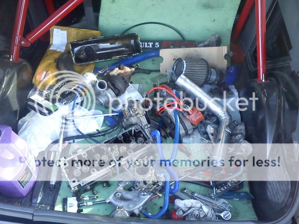

things have been s**t for my 5 the last fortnight. was out for a run then It suddenly felt like running on 3 cylinders. I got home (slowly :( ) and did some investigating.
one of the retaining nuts on the rocker arm came loose so valve no7 was not opening.
to make it worse. the nut went down one of the pushrod channels in the head so the only way I could remove it was to remove the head   :(
back of the 5 now looks like this...
whille head was off, did some tests and it looks like one, possibly 2 piston rings are worn.
so the 5 is off the road for the forseeable future till I can afford all the parts.

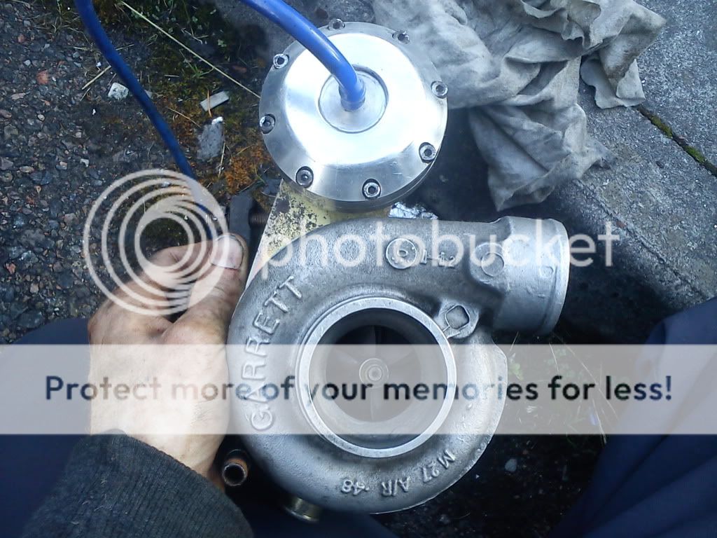

I am also considering selling my turbo to raise funds, its a turbo technics stage2 T25/2
http://www.turbotechnics.com/turbo/s117.htm
it has .48 cold side and now with a .47 rear. minimal side play, no in-out play.
will come will a k-tec T3 actuator. Anyone interested drop me a PM.

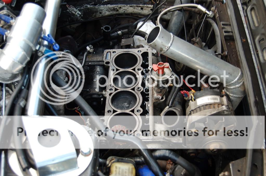

removed pistons & liners this afternoon with engine in situ....
was pretty straight forward, although I found it a bit awkward teasing the sump out between the subframe and engine mount - any tips to make it easier going back in?
just need to order up all the new parts and get the pistons to the engineers for new rings to be fitted and hone the liners  :D

Easiest way is to find something to take the weight of the engine and remove the engine mount that gets in the way. Although with some carefull manovering it is possible to refit it with the mount in place.
You will find it twice as hard to refit without smudging off the new sealant. A pig of a job which i have had the misfortune of doing more times then i would like.
