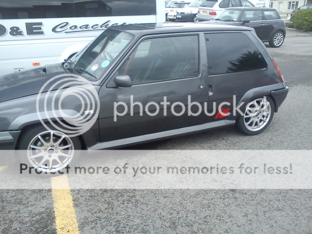

i've decided to go back to the standard bonnet for now due to all the rain recently - with my engine & heatwrap mega damp whenever I put the fan on, sh1t loads of steam gets pumped through the vents rendering my windscreen useless!!!! :shock:
as she is.....
over the next week i will need to make a new actuator adjustment bitty cause max i can adjust the current (pikey) one to is 17psi and its way rich so bit more boost is needed :mrgreen:
