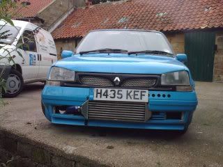

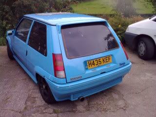

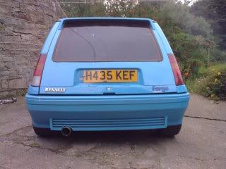

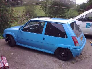

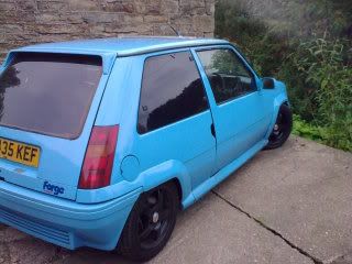

well got some pics sorted, how it arrived after 160miles on the back of my trailer so looking rather dirty  :o
main prob currently is body work

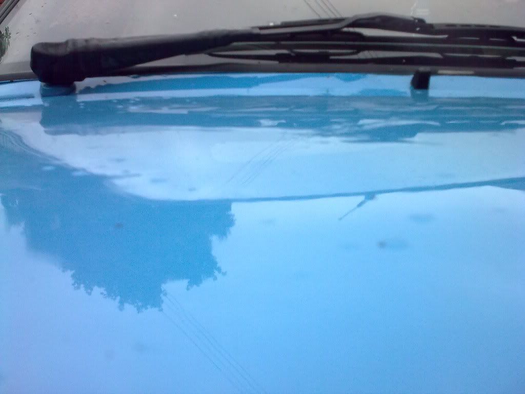

bonnet
as can be seen rather chiped on front edge and must have had a lot of filler in at some point and the heat has made it rise up as the bonnet has bumps all over
mirror

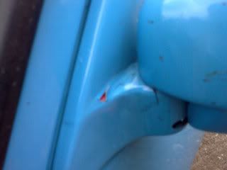

lifting slightly not bad just un sightly
top of door
bit scabby

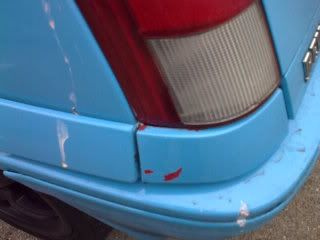

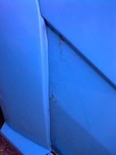

rear quarter

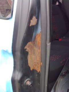

agian just surface rust really
the worst culprit

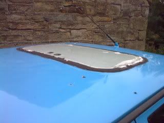

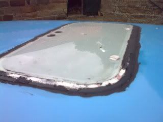

what do you do if your sunroof leaks, pop to b & q and buy out all there roof and gutter sealant ffs!!

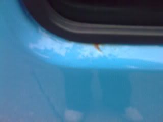

bit of paint lift again but not bad, its had 3 colour changes in its life!
the colour and large fmic made me buy it i'v always had a soft spot for large intercoolers, il post a pic of my old astra later

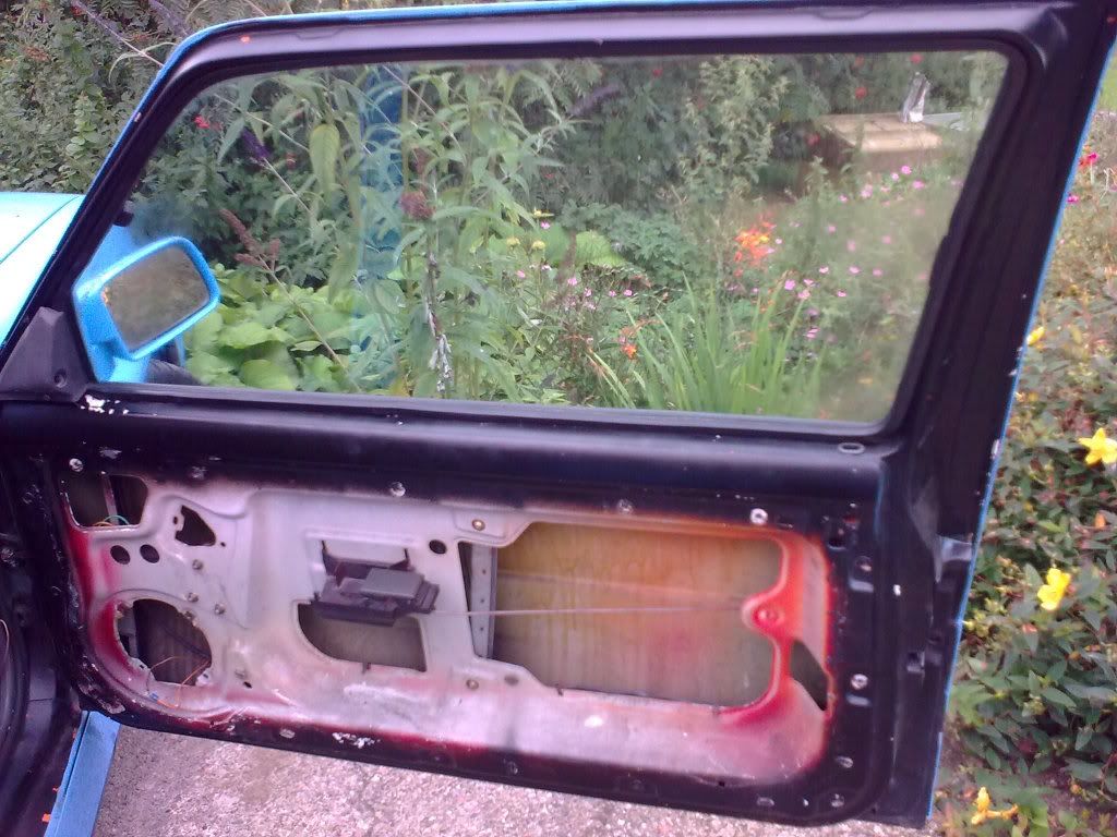

evidence of its many colours, door card removed as window wont go up under its own steam

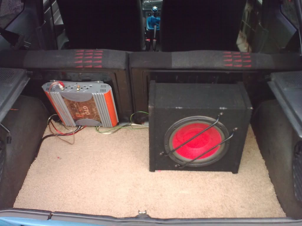

custom cream carpet added to back to tidy it up and of course keep it looking street
obviously had a cheap doors shut windows masked over respray and negeleted door shuts etc so its been done in black with a rattle can, i wondered why it looked flacky! proper job
neighbours new car  8)  warrented a pic its stunning!!
plans are really to remove sunroof and have it plated and filled spray all the rusty bits, sort bonnet and spray, spray inside doors and shuts etc, then its moving on to engine to get a bit more power, got new oil and fiter and going to thourghly flush cooling system as its not very clean, got new external oil cooler to fit aswell but will keep posted! let me no what you think good or bad

You'd never know from the 1st 4 pics! It's a shame someone stuck loads of mastic all over the sunroof instead of sorting the leak properly. Good luck getting it plated - could possibly be quite a job getting that perfect.
With a little bit of work you quite a decent 5 there. :D
« Reply #6 on: 08:56, Tue 25 August 2009 »
Yeah looks good, shame about the roof, you may be better trying to sort the sunroof out as the roof is so thin it will prob distort if you try to seam it, spot & fill may work but then it will only crack again at some point due to the flex in the roof
Shame someone did a half arsed job on painting it as well :(
« Reply #7 on: 15:02, Tue 25 August 2009 »
most leaking sun roofs are just down to the rubber seals perishing , top tip save some money and get down to Renault they still sell the rubber seals , will be oh so much easyer than trying to identify the blue , i went into a paint shop for my white renault and asked for a colour chart , they handed me over 5000 slips of white ........ besides will be cheaper , Good luck with the project tho!
