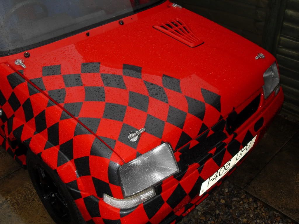

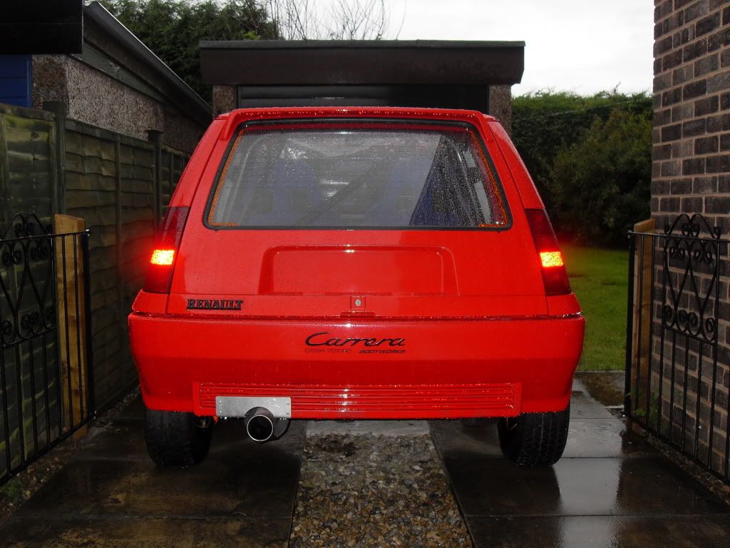

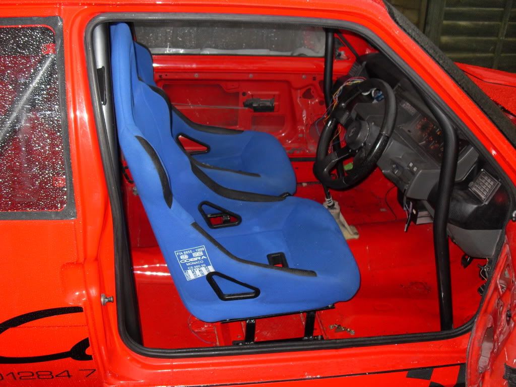

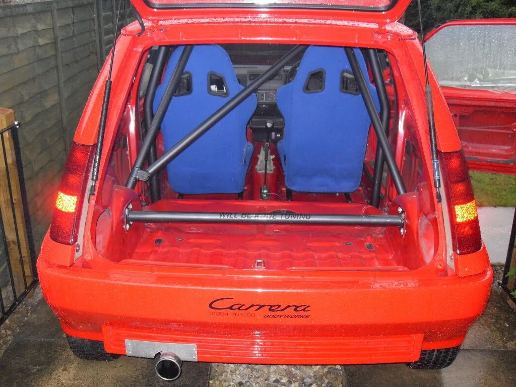

« Reply #13 on: 20:48, Tue 04 August 2009 »
just a few more recent pics, just waiting for harnesses and the sunroof now :D
