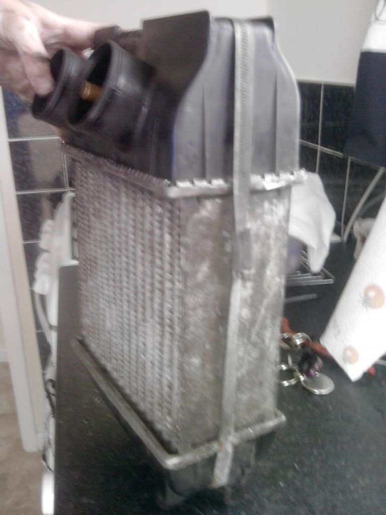

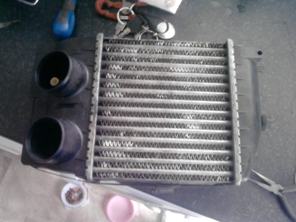

firstly you want to remove your intercooler from your car

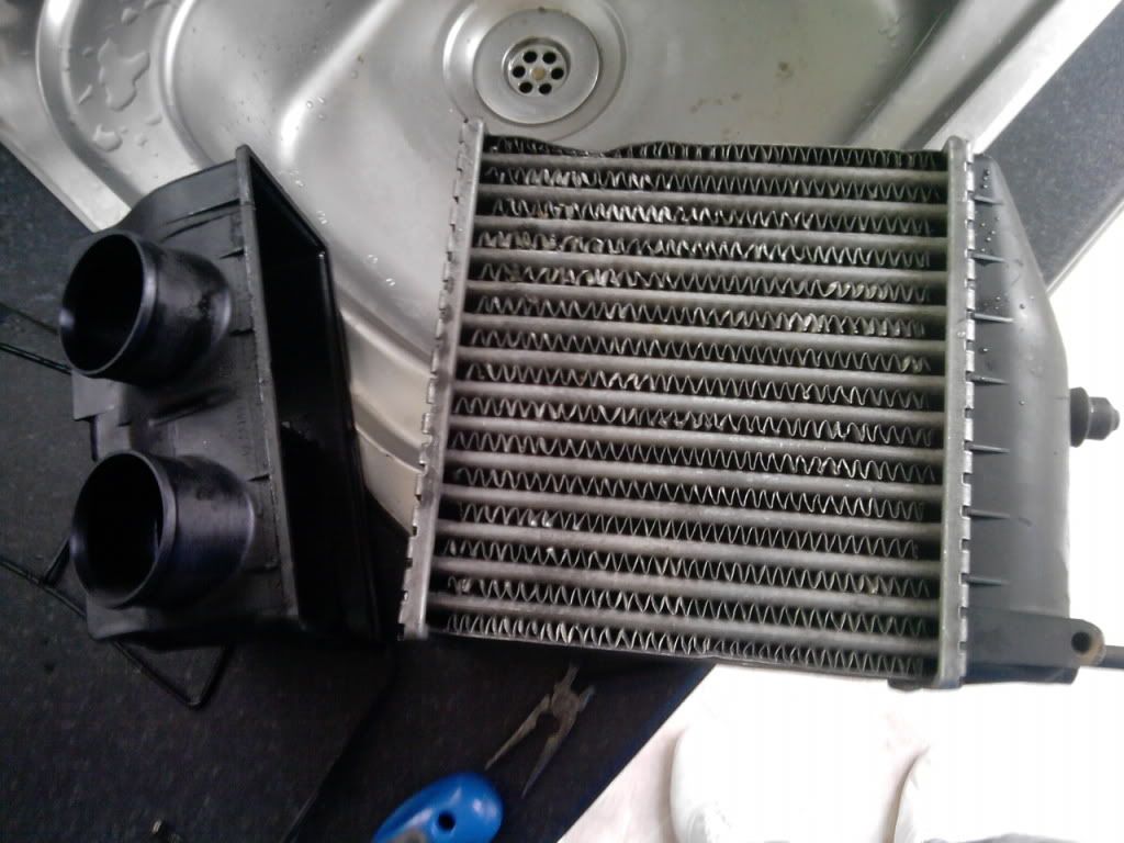

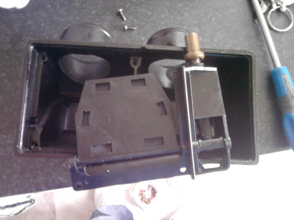

now youll need to remove the top section as thats where the flap is located that youll be fixing in the open position the top is held on by teeth on all four sides use a negative screw driver to bend them back untill the top section become detached

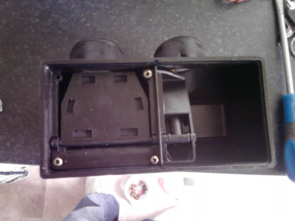

now with the top section off the flap becomes visable remove the four screws that holds the flap in and it will pull straight out

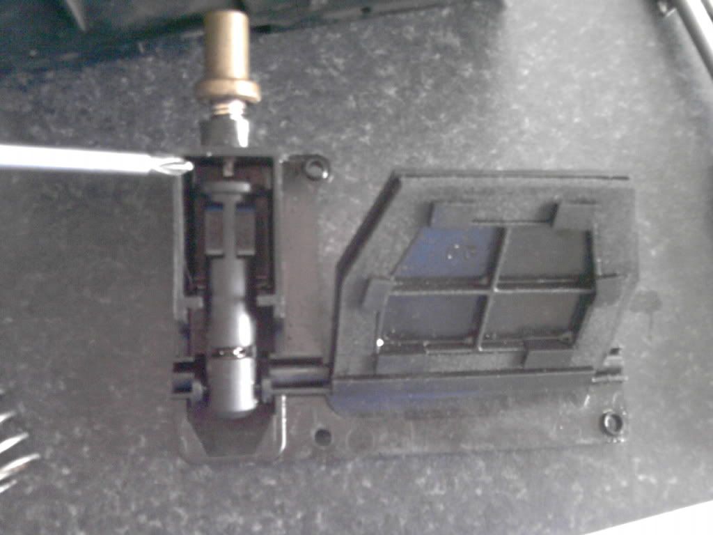

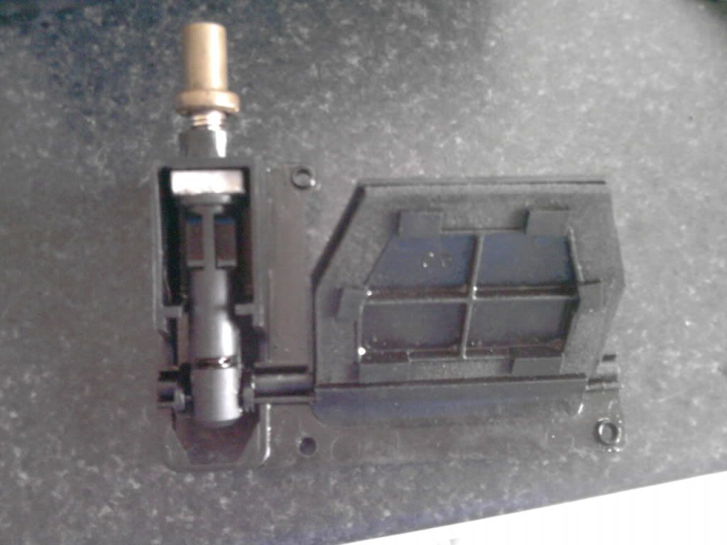

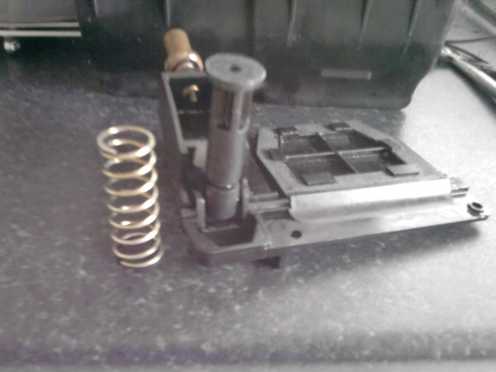

now with the flap removed turn it over and you will see the mec that alows the flap to open and shut youll need to remove the spring so that it stops the flap from springing shut how to remove the spring is to just work it over the one end that isnt fixed
with the spring removed youll see you have a gap at the top when the shaft is pushed all the way to the bottom so that the flap is in its open position

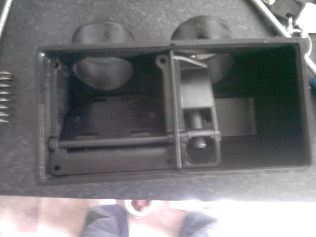

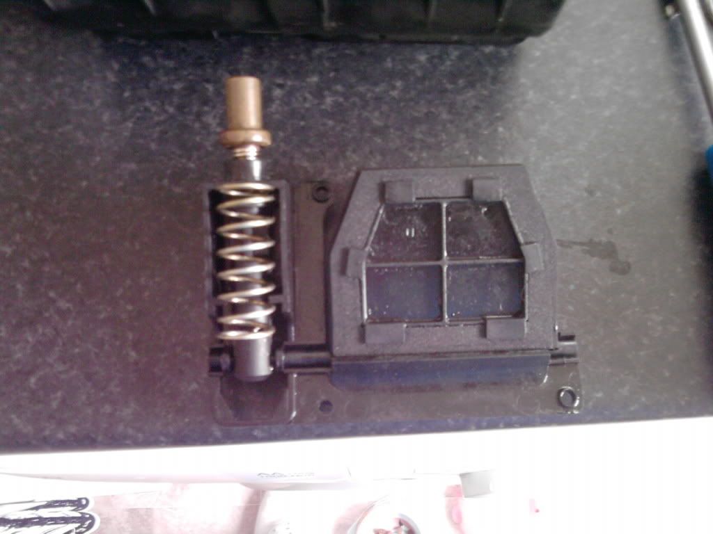

fill the gap with in my case a square of plastic that i melted onto the shaft to keep the flap from closing
once the gap is filled screw the mec back into the top section and replace the top back on to the cooler dont forget to strap the cooler with jubily clips

Small bolt and nut in the correct place drilled into the side will have the same effect without having to split the intercooler.
Good guide if not slightly over-engineered. :D
