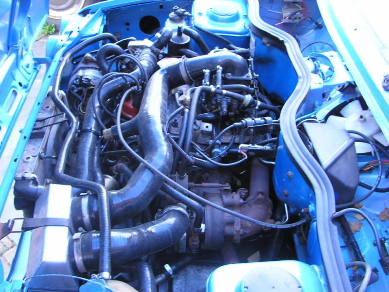

Did you find you had to chop the top rad hose a bit to get it to fit? Mine fouled the dizzy badly and was about 2 inches too long on either end.
It's not too bad tbh.. I've not properly fitted it yet though, as I'm still waiting for a water pump gasket from Renault, so my waterpump is only mock fitted for now.
The boost hoses though.. they were well too small in diameter! Was a right pain in the arse to get them to fit especially on the carb lobster!

Pretty much.. well, won't be doing any internal work, but I've got a T25, and LC-1 kit to fit, so I will be increasing the boost, then adding shiny bits. Probably go for about 18psi, with good suspension / tyres / roll cage.. Should be good fun on trackdays :)
