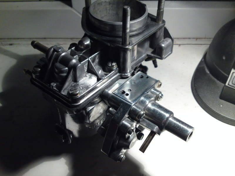

had starting issues, off with the carb, turned out to be accelerator pump was seized, making it a mission to start from cold, and hesitant when blipping the throttle. Because my car is stored... i can't just put it straight back on... so got busy with the dremel  :P

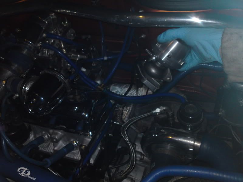

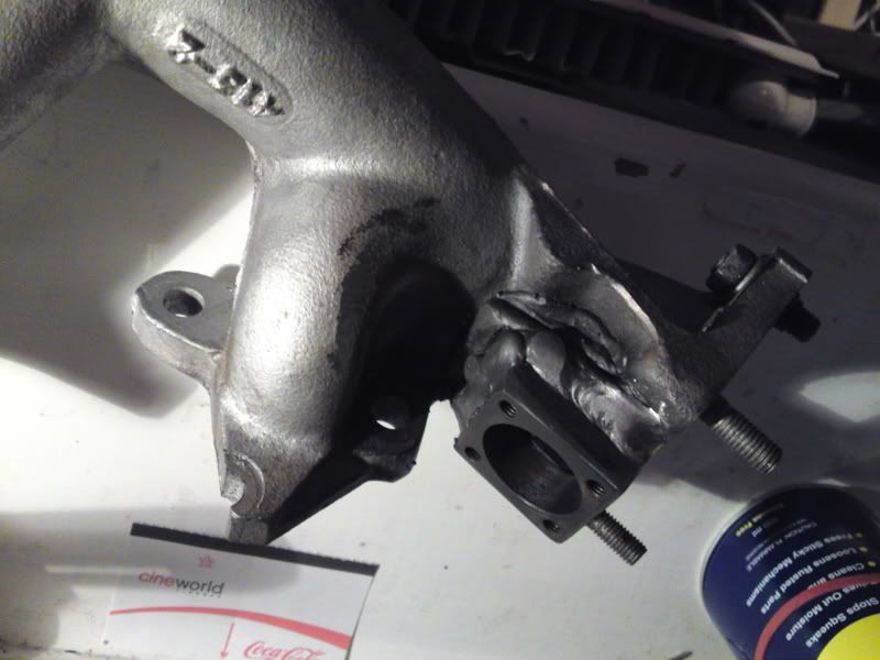

todays update:
manifold back to me until the wastegate arrives, then its back for it to be mated up to the plate on the manifold.
had to be welded on instead of cnc'd as the weld to make it flat kept destroying the cutters on the mill... oops
the carb polishing is ongoing as well.... keep doing bits and bobs here and there whenever i get a spare few mins
james, nah, not having any issues really, spikes to 30psi for a split second but its been fine like that for the last 3 years lol.
external wastegate is gonna be set to 27 to mop up the spike for a bit more noise thru the screamer pipe ;)

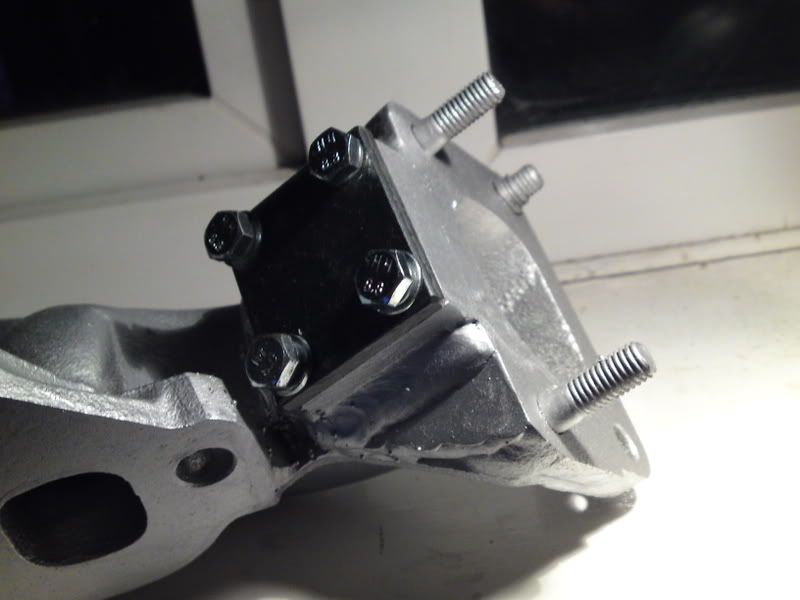

few days ago progress lol:
todays update.. a bit more polishing and an adaptor for the pipe to mount the wastegate onto... just gotta wait for the WG to arrive and get it positioned using my bro's car as a template.. then its off to get the screamer pipe fab'd

38mm, think i'm gonna scrap that manifold and do it again, too many mating faces to possibly leak... the mk2 will have a pipe welded straight onto manifold with the WG flange on the end instead

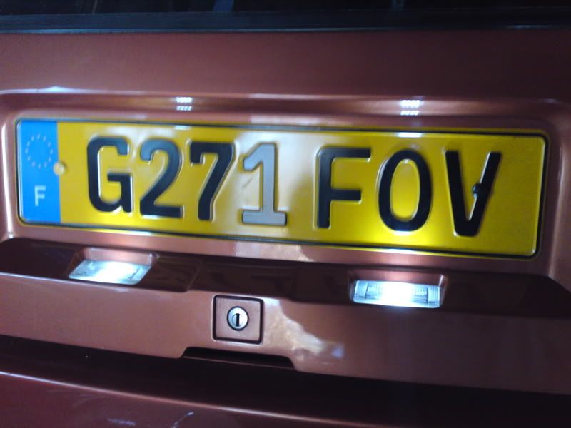

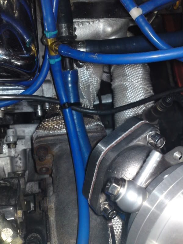

spent the afternoon at my car today, got it running again with the carb back on, worked out where the WG will sit and changed some bulbs etc for LED ones. also got my dashtop out and my flocking kit in the post :)
