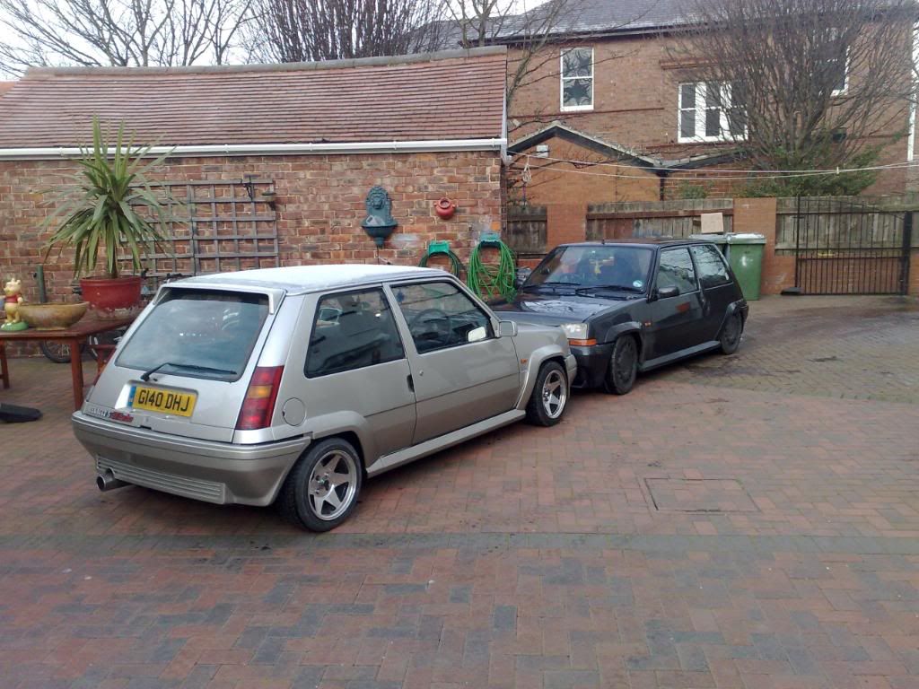

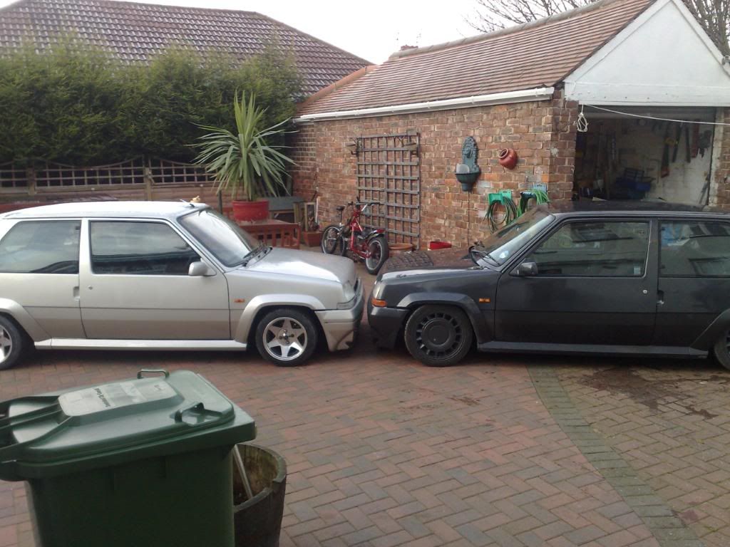

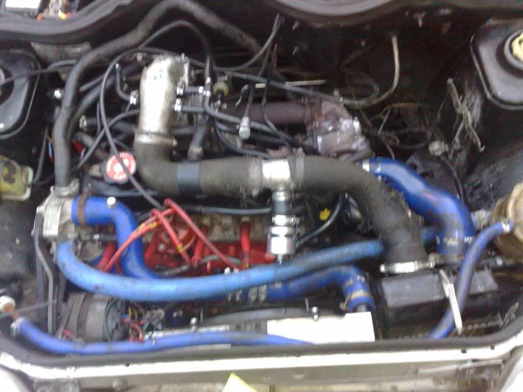

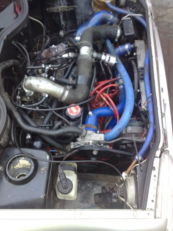

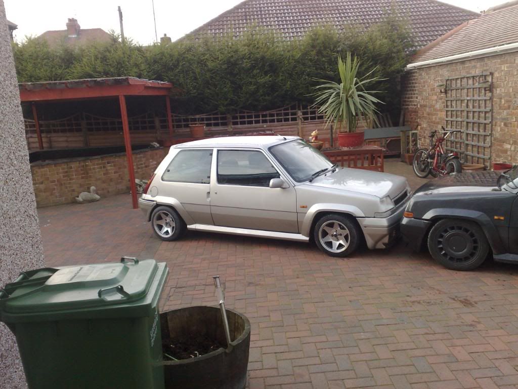

RIGHT WE HAVE BEEN BUSY ON THE CAR ALL DAY AND GOT EVERYTHING DONE:
COPPER CORE RADIATOR BACK ON (ALSO REMOVED THE OIL COOLER)
INTERCOOLER BACK WHERE IT SHUD BE
OIL SWIRL POT BACK TO WHERE IT SHUD BE
CHANGED THE STARTER MOTOR (WENT THE SAME WAY AS MINE, PROPER BUMER)
REMOVED THE ANTI-PERC FAN
HE ALSO WANTED THE WHEELS OFF ASWELL SO I HAVE LENT HIM MY 15" TSW'S
GOING TO LOWER THE CAR ABOUT ANOTHER 15MM ALLROUND TOMMORROW
AND HERES A REW PICS OF MINE AND HIS TOGETHER AND OF THE ENGINE BAY

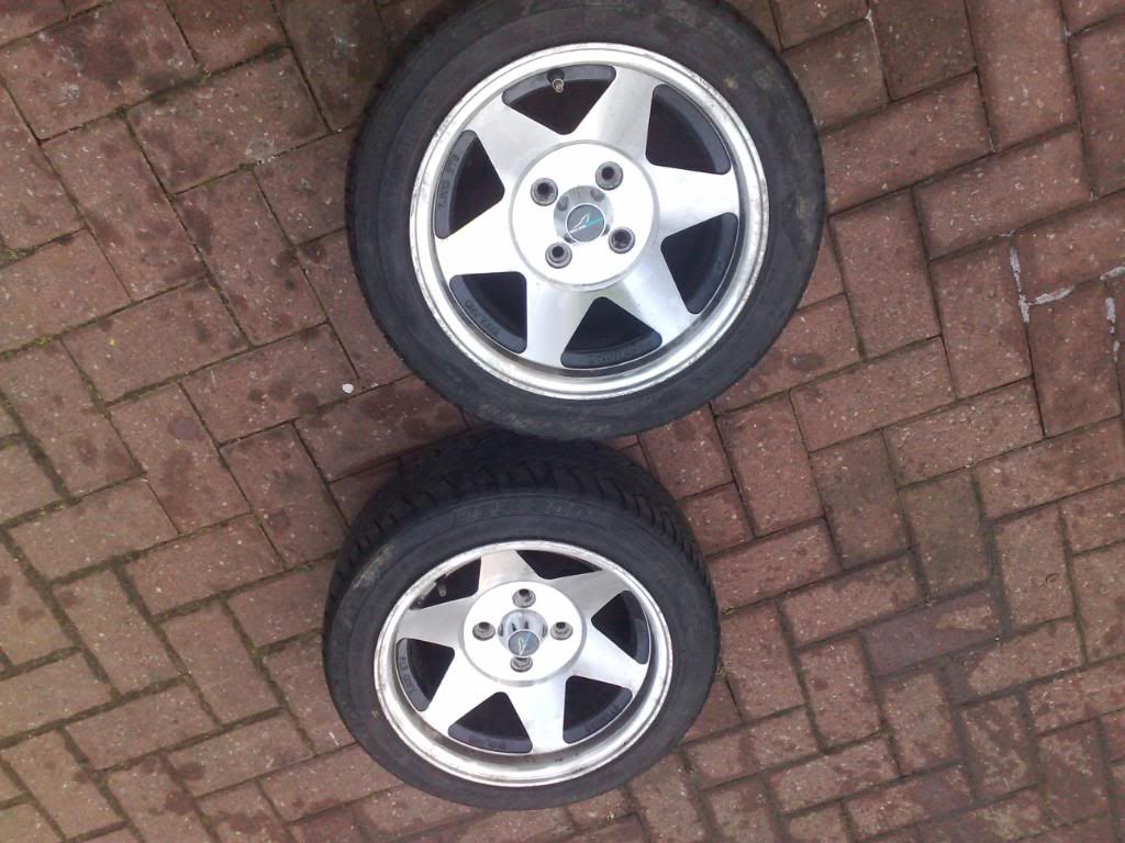

HE IS ALSO SELLING THE 13" MIDLAND WHEELS IF ANYONE IS INTERESTED WANTS AROUND 220 ONO AS THEY ARE 570 NEW AND THEY ARE IN MINT CONDITION AND HAVE GOOD TYRES ON THEM IF ANYONE IS INTERESTED CONTACT HIM ON 07878749596 SHAUN

That looks much better. And well done for getting out in the cold.
Would you need to have a bleed nipple in the hose from the pump to header tank?
« Reply #17 on: 17:38, Sat 10 January 2009 »
Thats looking better, also theres no bleed nipple in that hose, it's in the top radiator hose.
Also something didn't look right but now i can see it, theres no water swirl pot.
« Reply #18 on: 17:52, Sat 10 January 2009 »
WAITING FOR THE WAITER SWIRL POT COMING FORM SMITHSGTT THEN THAT WILL BE STRAIGHT ON.
DOES HE NEED A BLEED NIPLE IN THE PIPE FROM THE WATER PUMP TO THE WATER SWIRL POT :?
IF HE DOES AL GET THE PIPES SENT OUT TO HIM FROM JOHN (SMITHSGTT)

you need one for getting all the air out the system
so i will put a hose  in the package for you
« Reply #20 on: 17:55, Sat 10 January 2009 »
Yes theres a short piece of pipe from the swirl pot to water pump with a bleed nipple in.
WD40 will clean the oily handprints off the silicone pipes nicely  8) but try and wipe as much as you can off because otherwise it will leave them feeling a bit sticky.

Wheels still for sale?
