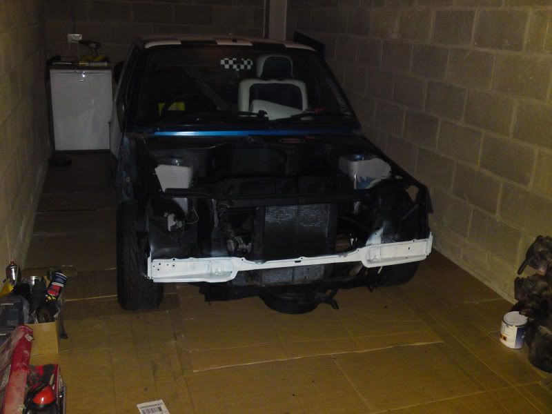

now back on his wheels  :D
still a way to go though

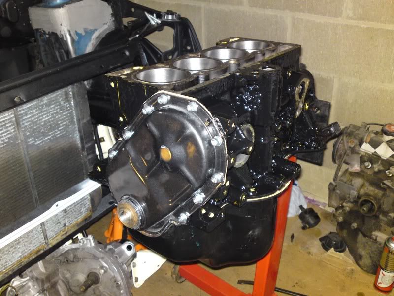

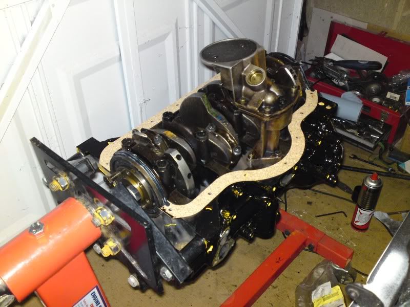

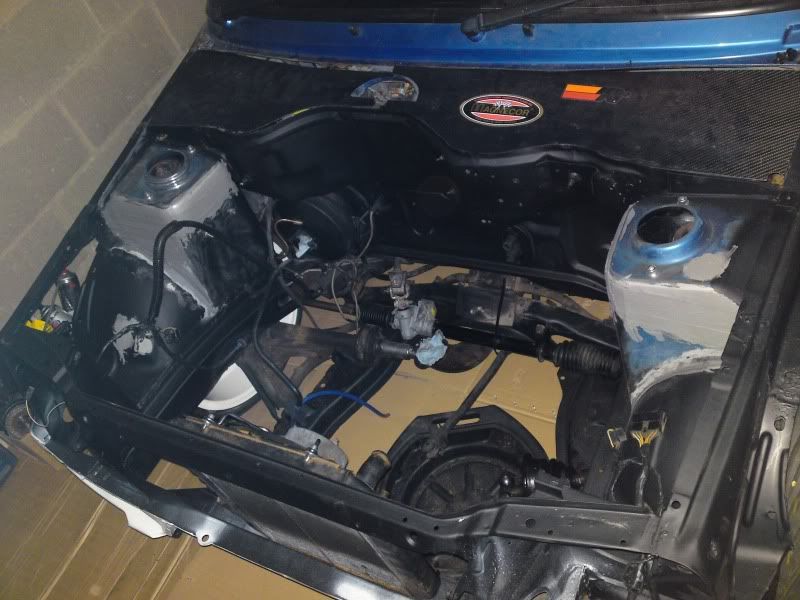

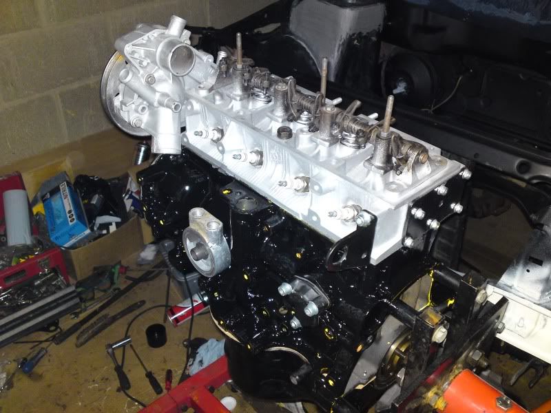

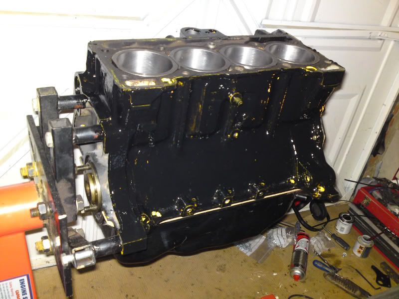

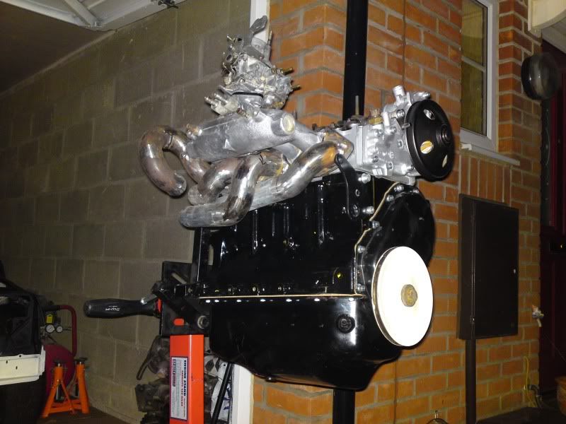

new engine repainted black, then next was the oil pump (flash brings out some of the yellow on the edges. its not seen without the flash though)

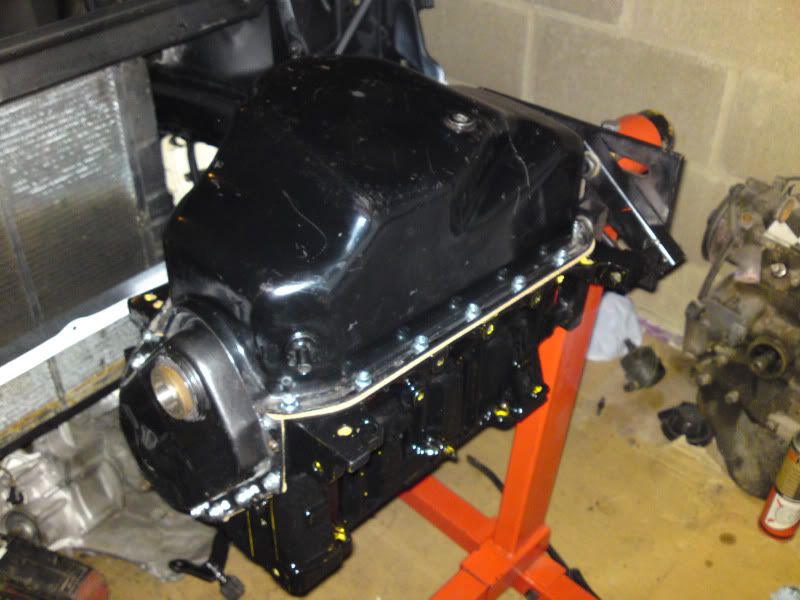

then the sump
(where possible ive replace all bolts with allen key cap bolts)

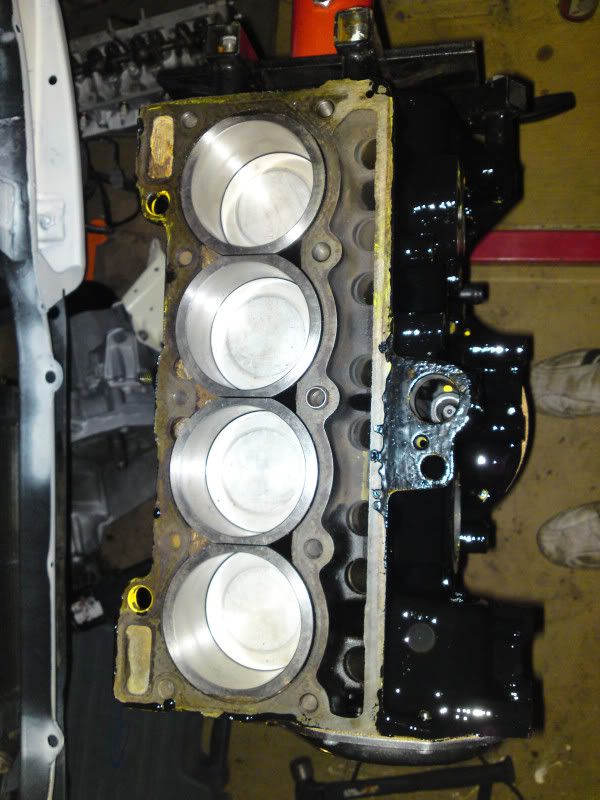

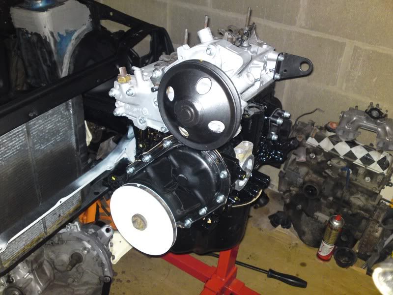

head bolted down with 2 old bolts to stop the liners moving

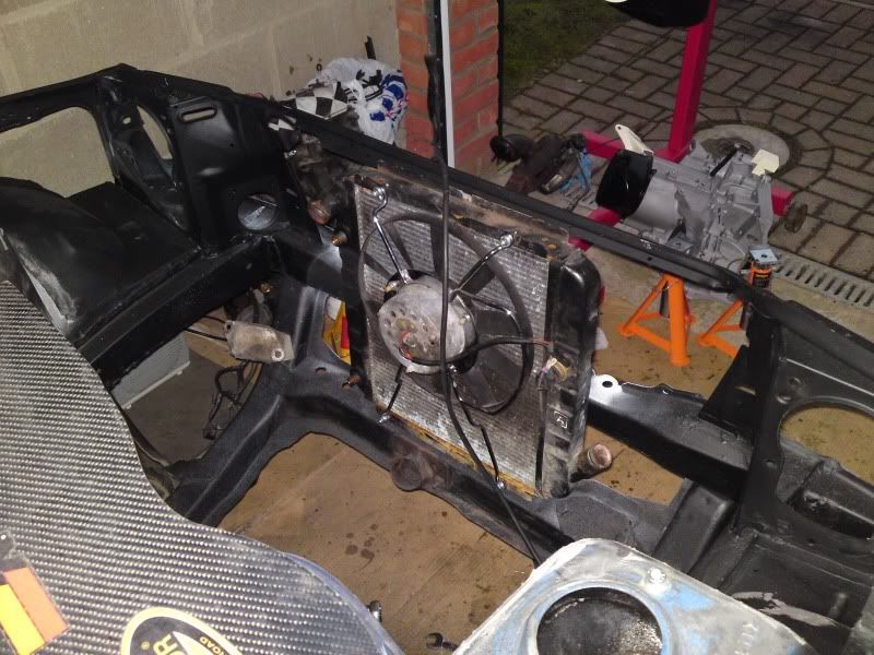

chrome fan bracket

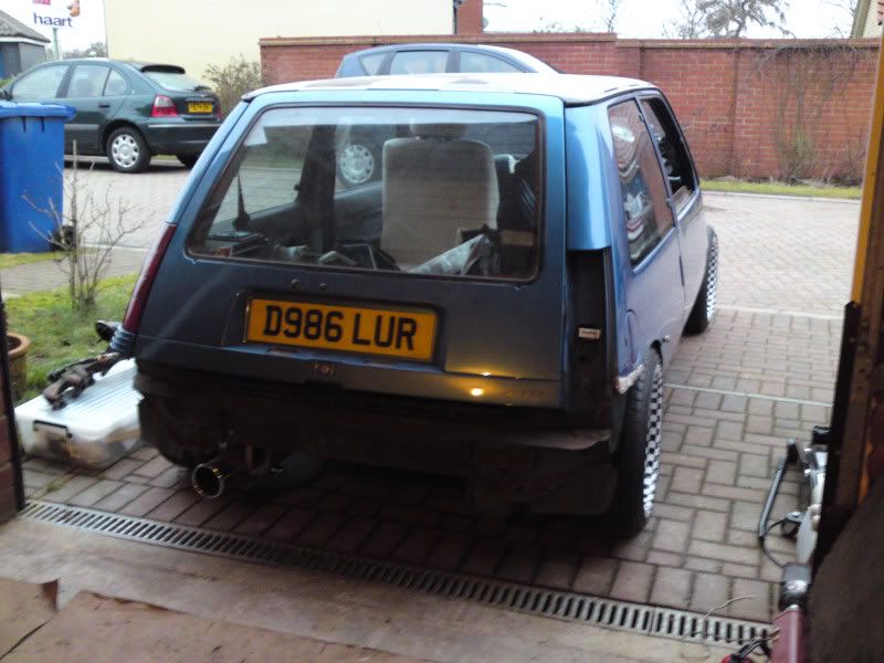

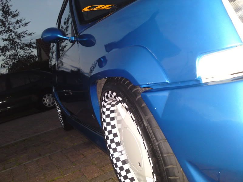

et15 7.5x16's with out the arches lol
after i cleaned out the garage of all the old rust

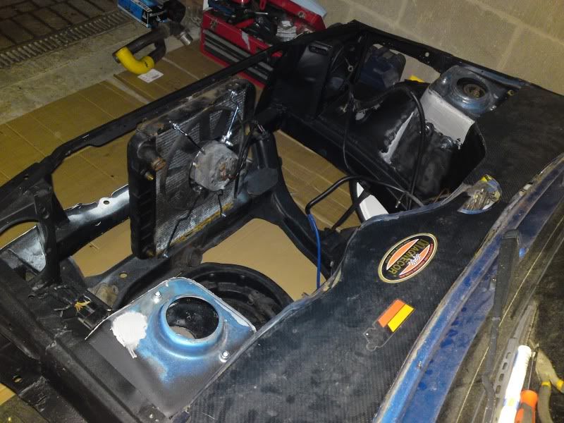

engine bay
carbon scuttle covers
prototype manifold (doesnt quite fit though)

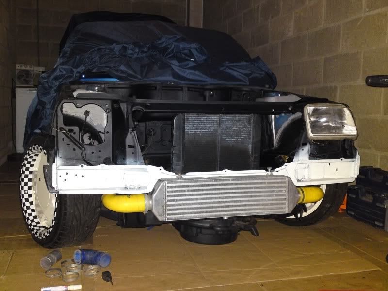

intercooler remounted
and seeing as the wheels can be seen in the last pic, here he is seeing daylight for the first time in a few months
that was mondays work.
tonight i have started to sand back the strut tops and i have started to drill the hole for my boost pipe to go through, but as the battery in my drill died i didnt get very far . . .
more pics soon
 :D
Re: my '86 restoration - keeping the dream alive (09/02/2010)
« Reply #193 on: 00:00, Wed 10 February 2010 »
james, please dismantle fan from rad and paint the rad satin black  :lol:

wow at them wheels .. there some thing different alright Lol
