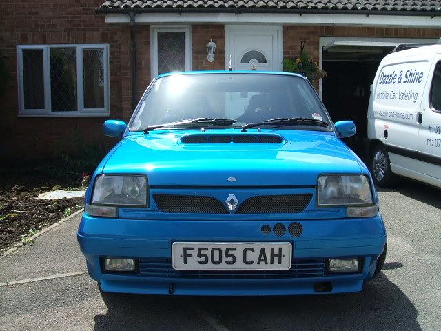

think iam going to go for the grille mounted option now for a intercooler as dont want to chop standard bumper up really and i think it will get more air behind grille and keep it looking like this
Yeah definitelty mate, slightly shorter boost run too :)
i have an aj tuning bumper so my cooler would get more air flow from being in the bumper really,but i prefer the grille option.
if im going out to race i'l just pop the grille off
« Reply #23 on: 11:14, Sun 13 July 2008 »
yep i think its the way forward now so looking on ebay now to try and find a intercooler which will fit behind grille and in front of radiator with out being to tight
