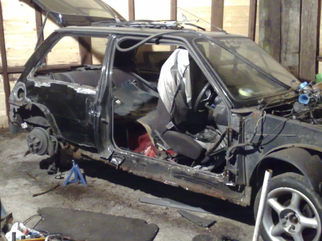

heres a picture of my five before the major restoration starts!!!! engine is out in this photo
« Reply #1 on: 22:23, Thu 06 March 2008 »
You could really make this a nice 5...   8)   what are your future plans with it?
« Reply #2 on: 23:38, Thu 06 March 2008 »
Looks quite good from the piccys, make sure it's not rotten underneath if it's been sat on that grass for a while ;)
« Reply #3 on: 15:12, Fri 07 March 2008 »

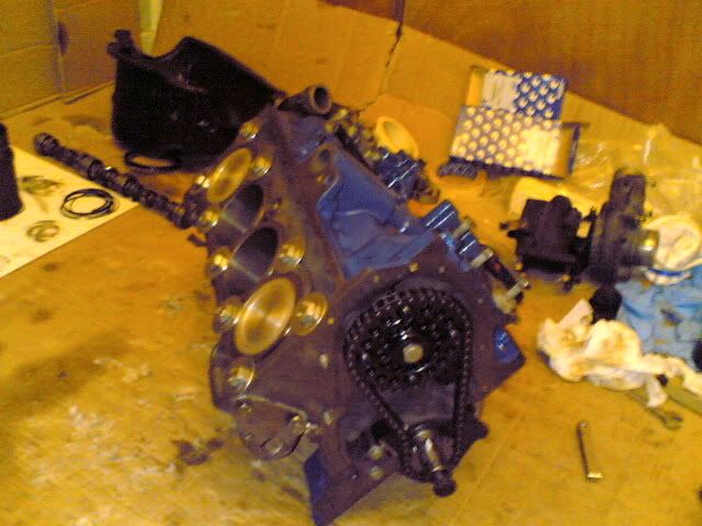

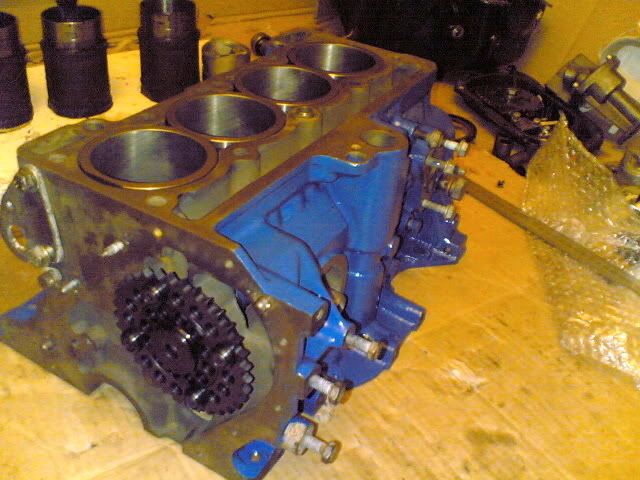

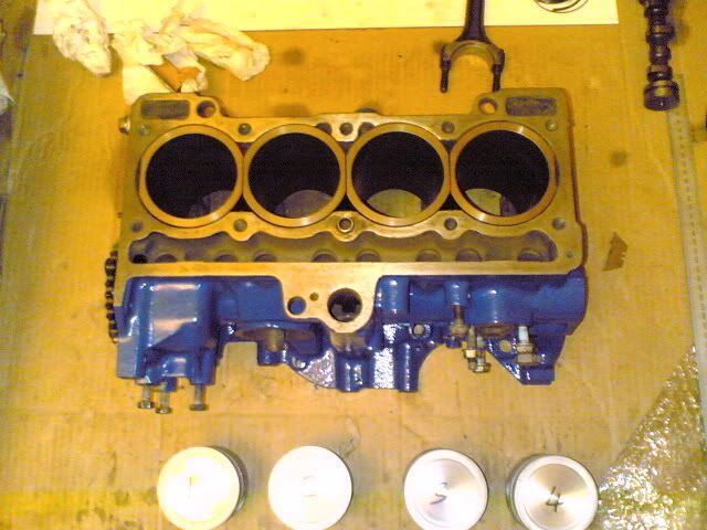

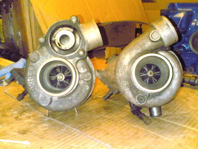

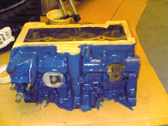

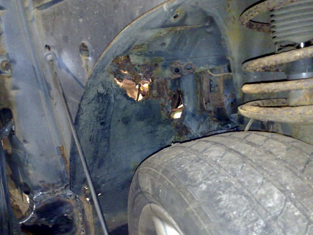

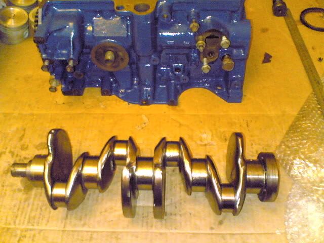

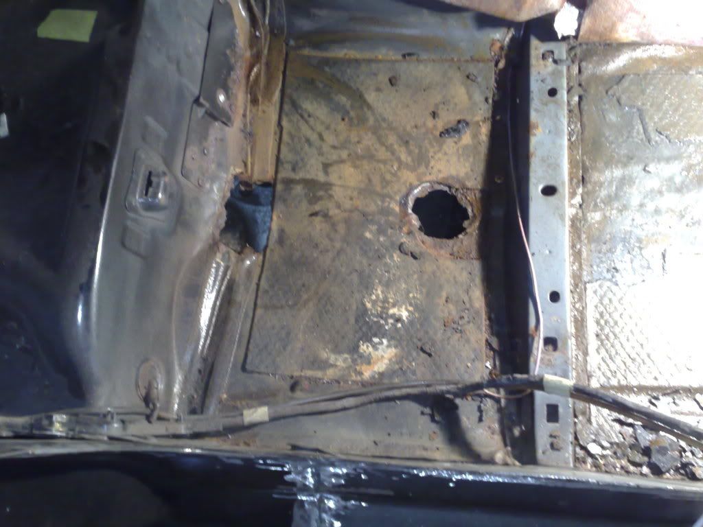

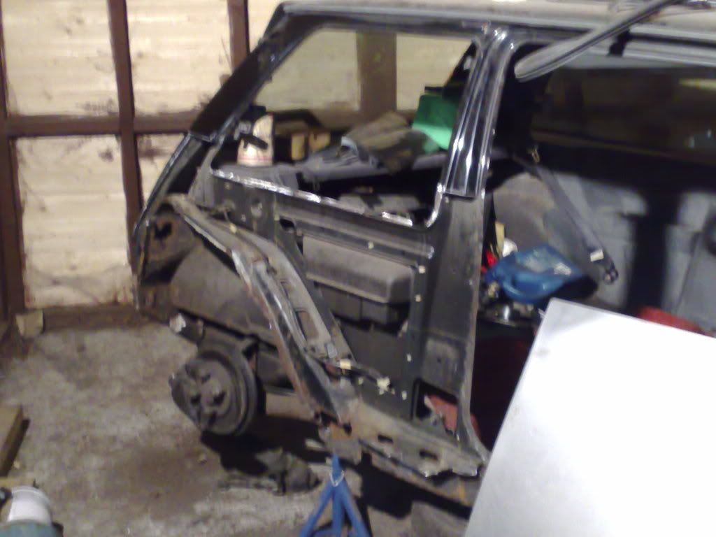

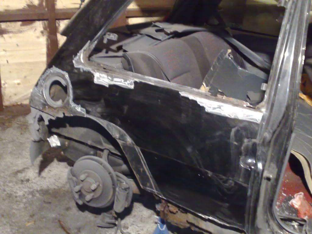

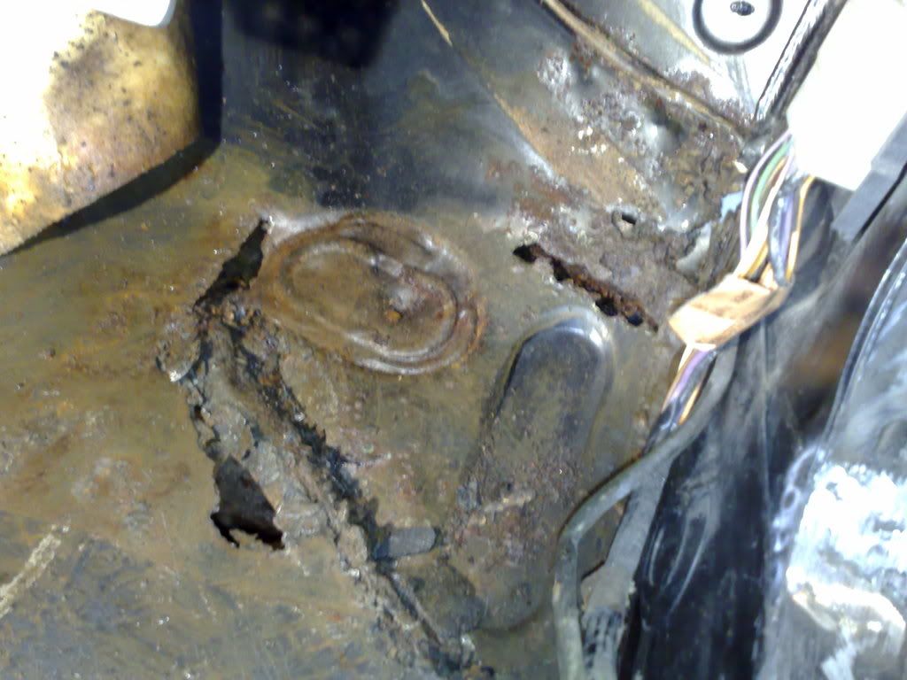

she was rotten,she has been sittin for 2 years,ive had to replace osr qaurter panel/full os sill/ns complete inner wing panel/slam panel/repaired osf inner wing panel /os headlight panel/most of the osf floor was rotten right up to the wheel arch inside all have been repaired and most of the inner osr wheel arch is rotten too am doin that section at the mo,the engine is almost together i built it with bbpt parts,its the yellow spec with lightened,balanced and knife edged crank,stage 2 ported and polished head,lightened,balanced flywheel,low comp pistons,gt cam and vernier pulley,uprated valve springs all stuck together with uprated headbolts and 1.9mm racing head gasket,group a carb,uprated fuel pump,samco/sfs hoses,ktr chrome bits and bobs,ktr t3 actuator and a t25 blower bolted to a ktr side exit,full 8 point sparco roll cage,theres more parts just cant remember them all have been stock pilling for 2 years,cant wait to get it on the road now,will post more photos of engine and all the welding ive done,thanks for looking, baz
engine partially built

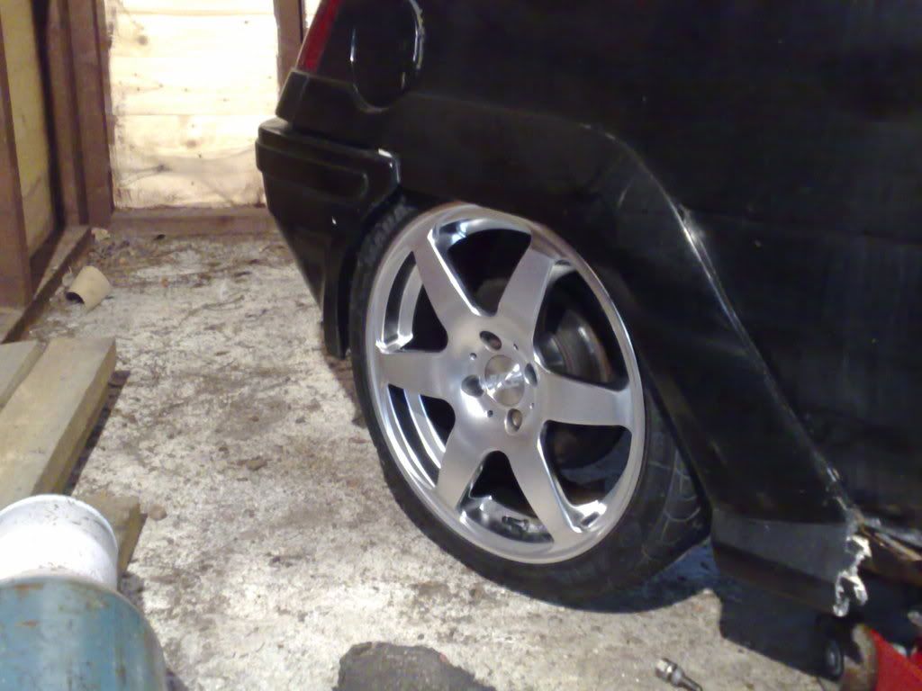

my new rims 16" with 195 40 16 rubber
« Reply #6 on: 16:33, Fri 07 March 2008 »
keepin body work pretty much standard apart from removal of front and rear bumper strips and getting rid of hole for exhaust just to give it that clean look,sort out bonnet gonna change that scoop ive already ditched the bonnet hinges for pins for easy access to work on the engine bay so complete bonnet will lift off, as i said earlier 8 point roll cage,keepin all the interior ,standard seats etc but will have harnesses with front seats wanted to give it that standard look mixed with the race look,keepin to standard colour of good old renault black,im not one for shopping trolley spoilers or massive body kits you seem to lose that classic shape of the 5

thanks mate will be posting more photos of the body work shortly ive been welding the car for six weeks solid,i work offshore now so the time at home is great i spend my days doin the 5 and gettin paid for it cant beat it  :D

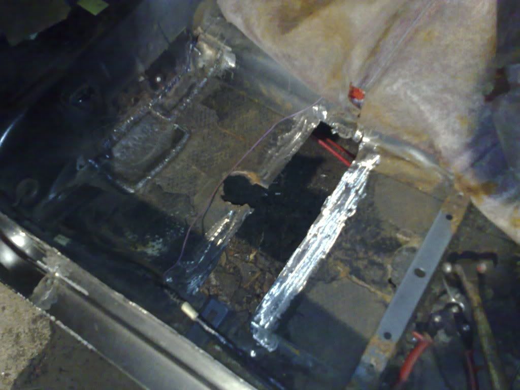

away to post some photos of the welding mate

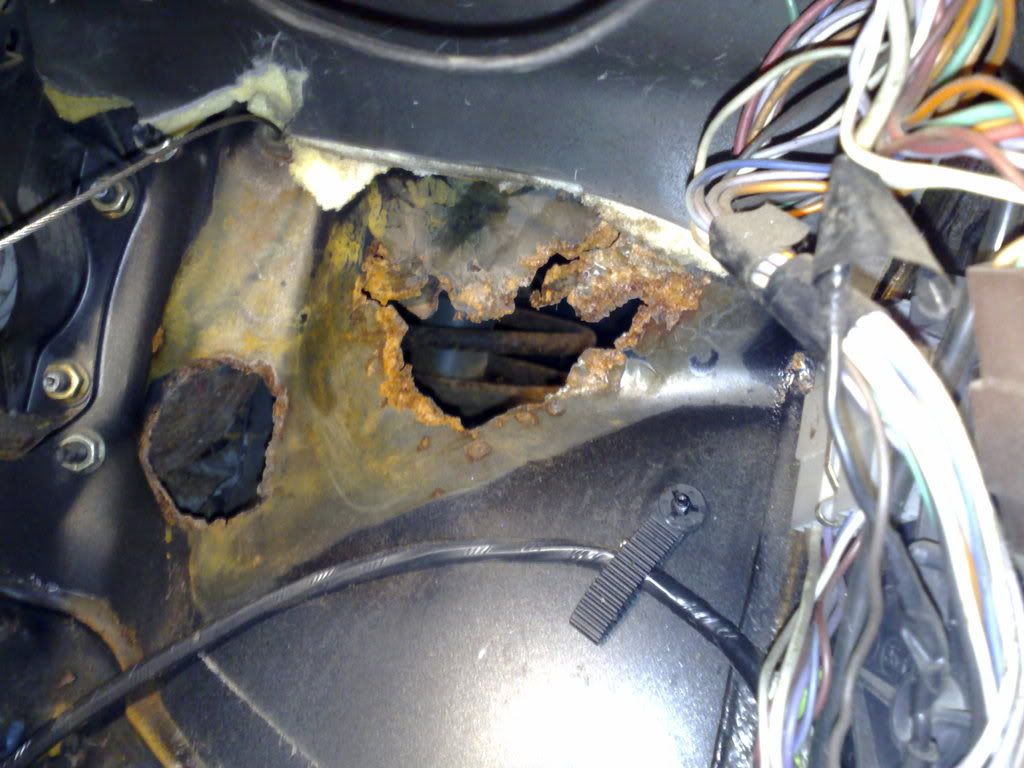

« Reply #13 on: 21:17, Sat 08 March 2008 »
starting to cut out the rot!!!!!!!
