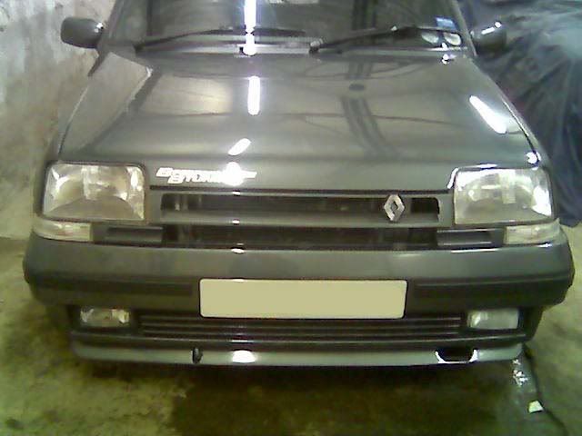

Car when I bought it
Car now

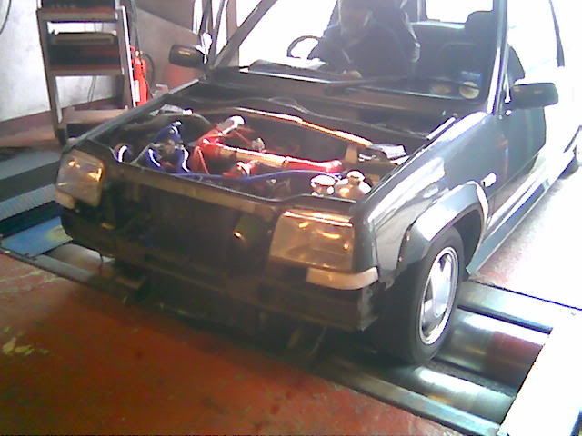

On the rolling road

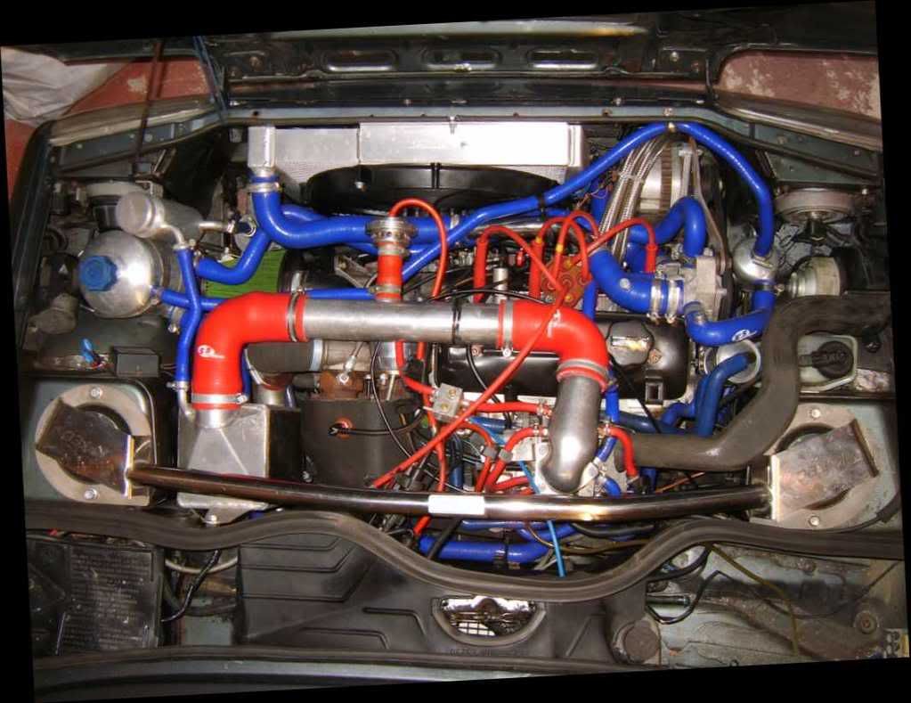

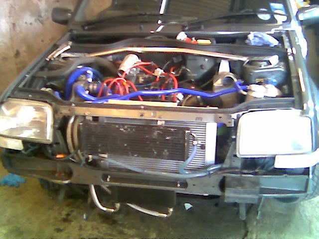

Engine bay
Engine Bay

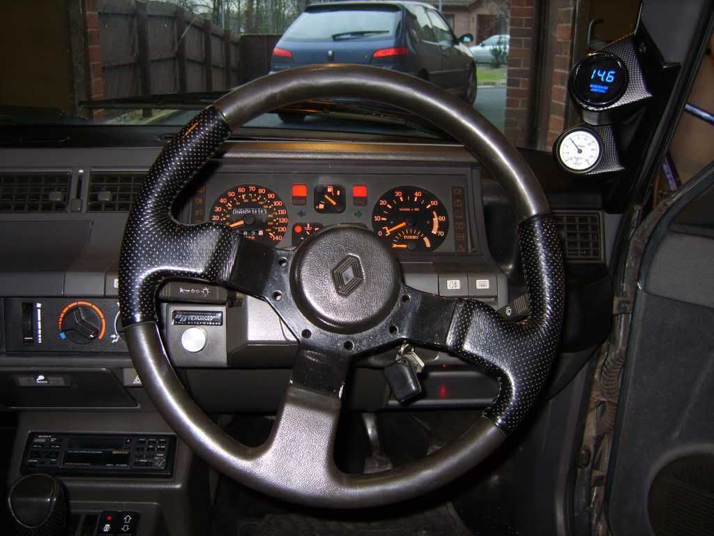

Got a digi cam for christmas so decided to try it out.  Have the LC-1 fitted now and seems to be working ok.  Just waiting for the good weather now to get the car back out again to check the fuelling.  Managed to get a pillar guage pod sorted for the car too.
Pillar Pod
Engine Bay

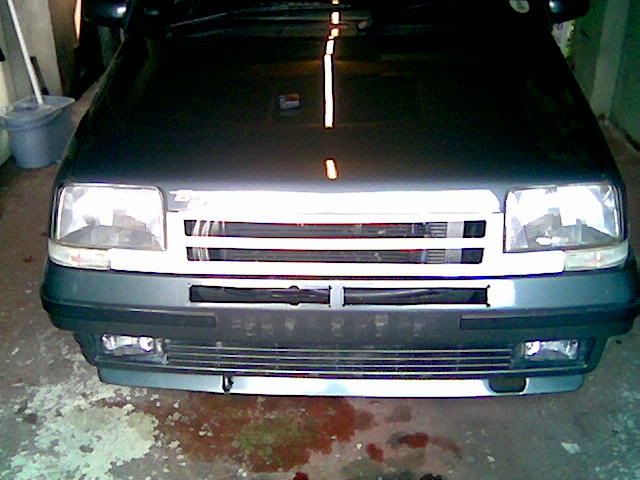

I have been looking at ways of improving the air flow through the original bumper.  I have got a monte carlo front grille for the car and am thinking of maybe cutting some shapes out of the front bumper as well to aid the cooling. I have seen circles cut out with a hole cutter before but was thinking of more the same idea as the turbo2 cars.  They have rectangle inlets on the front bumper.  I think it would mabe look a bit more tidy. Was wondering has anyone ever seen it done with rectangle cutouts before?
Anyway the plan is to get the new grille painted up in the next few months and also get the front bumper resprayed due to stone chips.

There isnt much point me cutting the fins away from between the fog lights because I had to raise the radiator up slightly due to fitting the larger fan.  So now the bottom fins only really direct air to the oil cooler.

I had problems with it running hot before I cut the front grille.  It even started to get hot with the large rad.  I just took off the front grille one day and it made a massive difference hence the cut down version.. I was thinking of improving it more by cutting some openings in the top of the front bumper as it really does restrict the air flow a lot.  I havnt done it yet as i would like to keep it as standard looking as possible..  I may look at doing it again if I have anymore problems.

Got a lend of a Jigsaw for the weekend..  The car should be able to breathe a bit better now  :D
Just have to get the cutouts tidied up a bit now. Get a good straight edge to leave it right. I will put some mesh behind them and get it down to the paint shop..
