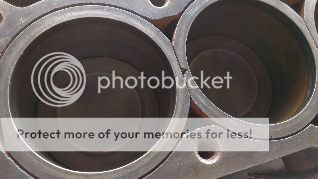

Owned my 5 gtt since 1996 now . It's a 1991 H reg whitey in standard form. I've had it tucked away in storage for some years now due to a air in coolant problem. It blew the degassing pot into 2 pieces. Replaced head gasket with a rather expensive gt tuning one only to find it still had the same problem grrr. With an ever growing family I stored it.
Now I have stripped the engine out and after a lot of head scratching have found this:
Which I believe is the root of my problem.
Only noticed this as there was a hair line black mark on head gasket.
I'd considered various engine options but have decided to stick to original and rebuild with a little renovation thrown in to try and bring it back to its former glory.
Question is what's my options, can I just replace the liners/ rings ?  Compression test was cylinders 1 and 4 had 8.5 bar and 2 and 3 had 8 bar.

single father hats off to you mate  :D as for the car just replace liners and rings and obviously any other nesacery gaskets seals etc its a fairly easy job aslong as your confident. just make sure theres no other damage etc

Having had a good look now and extracting the liner , seems to be a strip down and rebuild which I'm quite confident I can do. Engine is in excellent condition . This damage occured when I had a water leak on the inlet manifold which led to a overheat. Inlet manifold was removed and I put new hosetails in. Then when refitting a stud broke in the head. So I whipped the head off and fitted all new studs. While the head was off I fitted new valve stem seals ,relapped the valves in and polished the ports and polished around the valves.
I used to be a toolmaker ;)
The broken liner wasn't visible then :(  seems it took a overheat till the red light come on to expose the damaged liner.
Anyone know wheres the cheapest place for liners ?  :D

Welcome to the site, Sparky is a nice bloke, glad he's sent you in the right direction.. Looking at the pics the liners look shagged.. also make sure the rad is not blocked.

Thanks for the heads up I've got a brand new double copper core rad with low temp switch to go in.
Still cleaning the block ready for a fresh lick of paint. Will get there slowly but surely.
