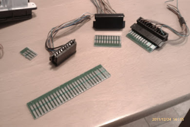

Ive made a conversion loom so a GTT dash can be fitted into a Campus.
Take one  GTT Dash..
then looking at back of it compared to the campus one..
So using JAMMA fingerboards, I was able to make a conversion cable
This plugs into the GTT Dash then into the Campus Loom. Just need to wire up the tacho and turbo gauge (to something)
Testing the cable converter.. All works. fine.. got some dead lamps.
