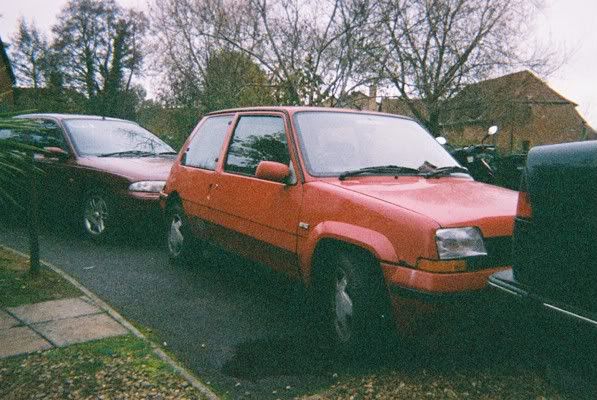

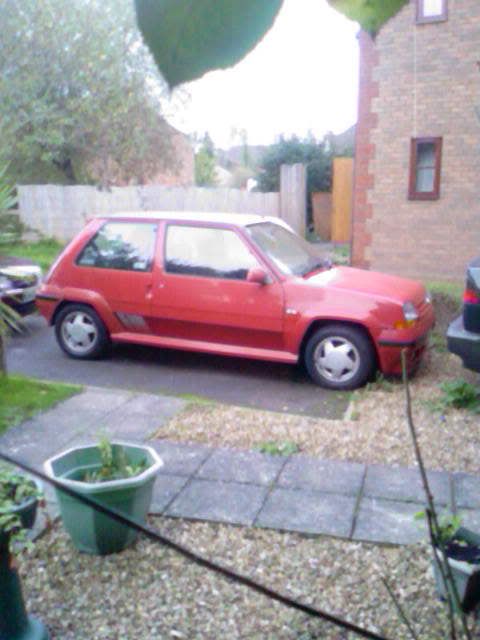

thought it was about time i put a bit on here about my little 5
even more so as I've found a few of the pics from when i first got her.
I haven't really done much to her since i got her and as such need to pull her apart and do a few things when the weather gets better
any way a few pics for you to have a look at

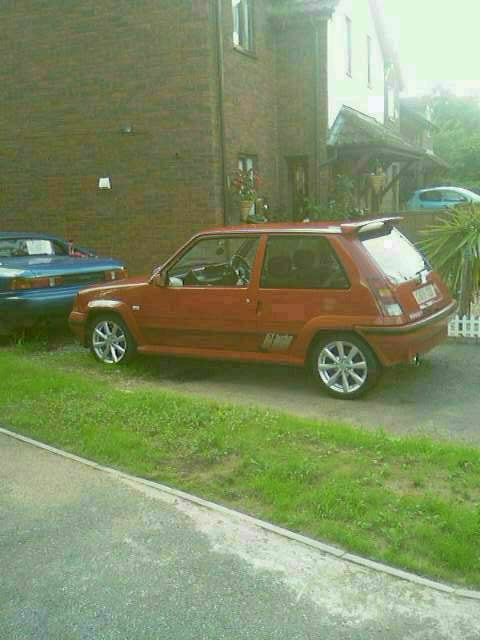

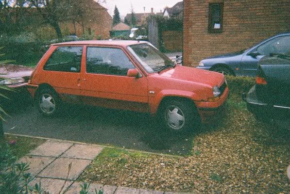

after i got some second hand wings and the body kit bits that were missing
after a polish and putting the wheels on that came in the car with all the boxes of bits

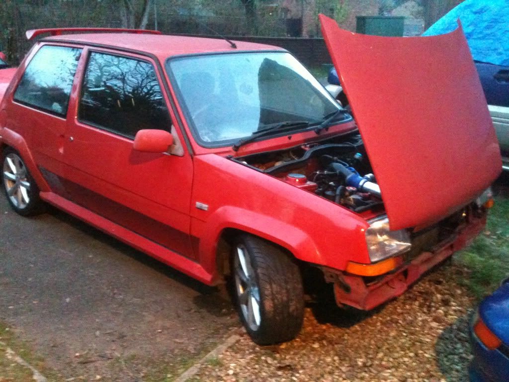

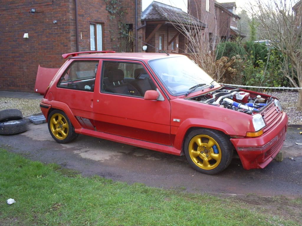

and as she sits at the moment

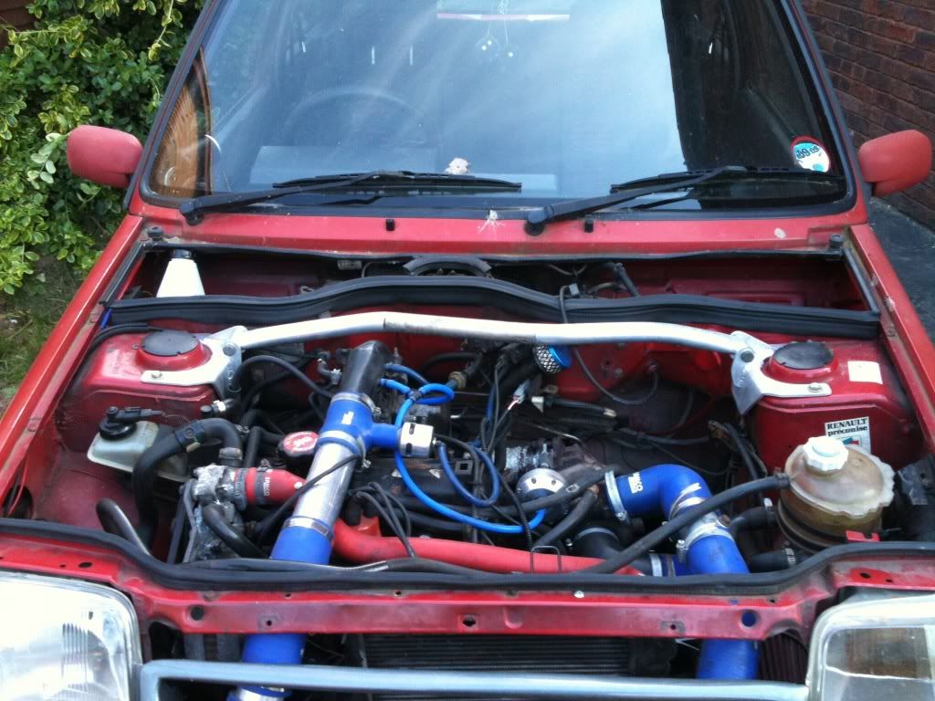

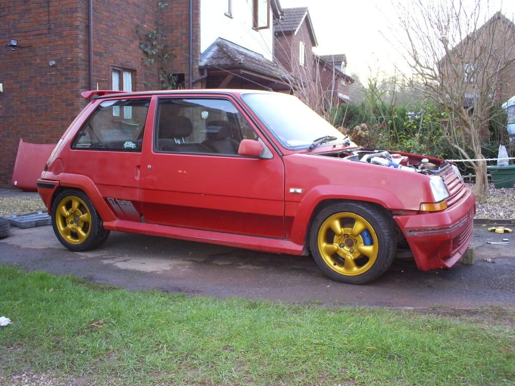

some new pics

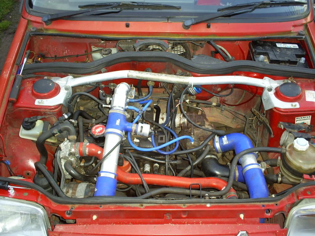

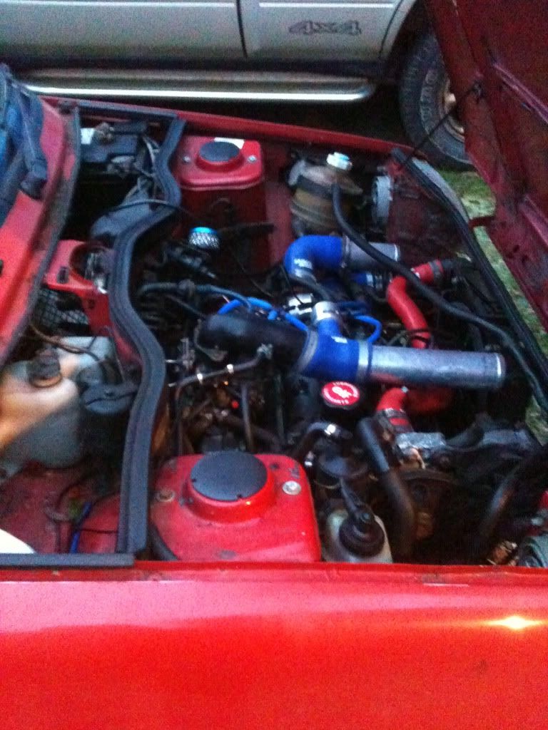

engine bay needs tidying up and some more shiny bits

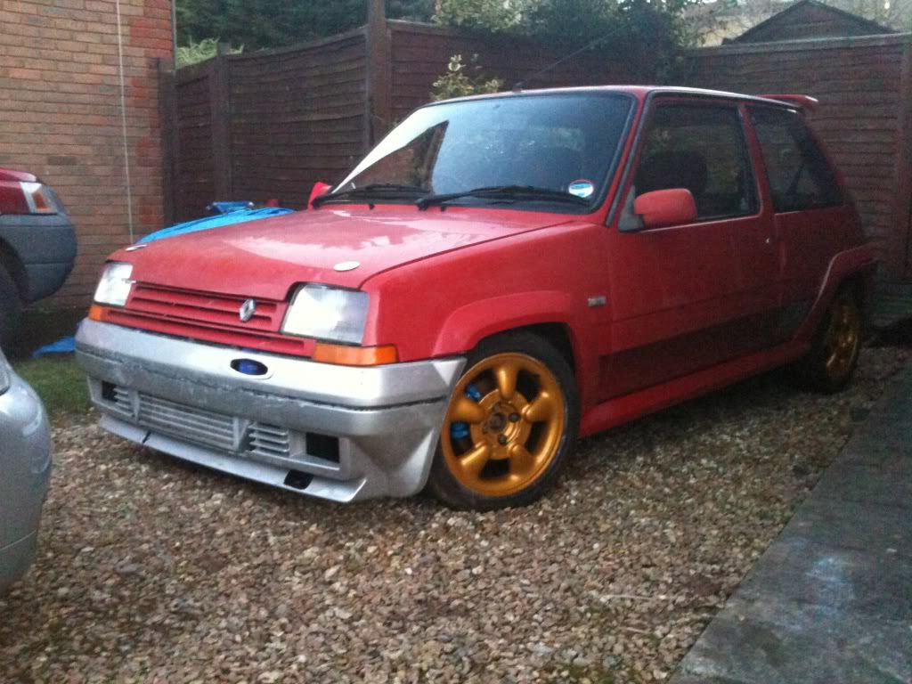

original front grill fitted back on

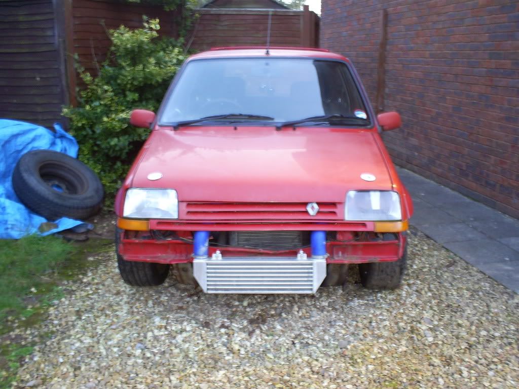

mocking up the original bumper to see where to cut to clear the front mount intercooler

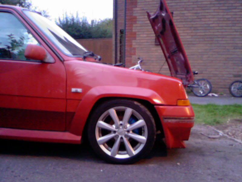

picked up these wheels cheap but might respray anthracite (tungsten gray)
Bit of work done today....some tidying in the engine bay and a slightly modded standard front bumper fitted instead of the big K-Tec one i had on and didnt like

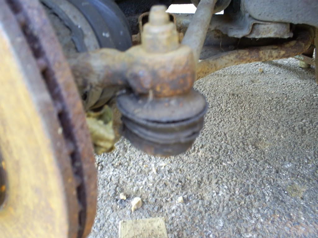

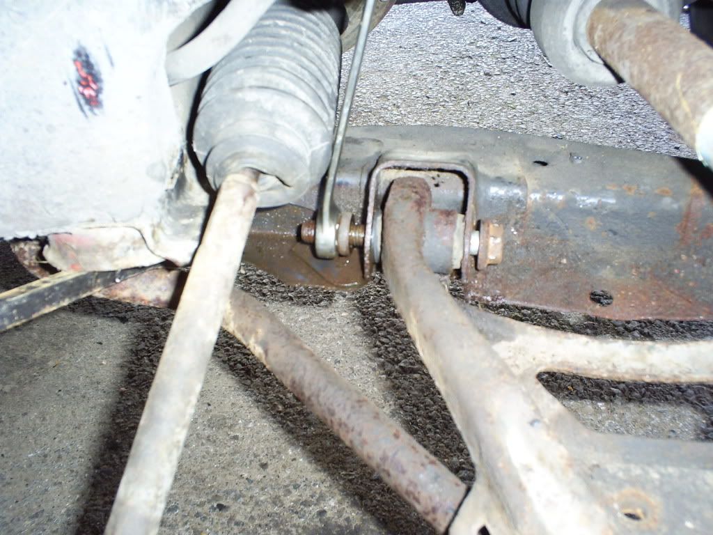

24/03/2012  nice day today so some work on the 5 was done. from the list above i have checked off items 1,2,3,4,5,8,14,20,22, had an issue with one of the lower arm bolts but nothing the old angle grinder couldn't sort!! lol soaked the rear torsion bars in prep for next weekend when i will have a go at lowering it a bit, cooling fan was just a relay which i have about 5 or 6 spare.

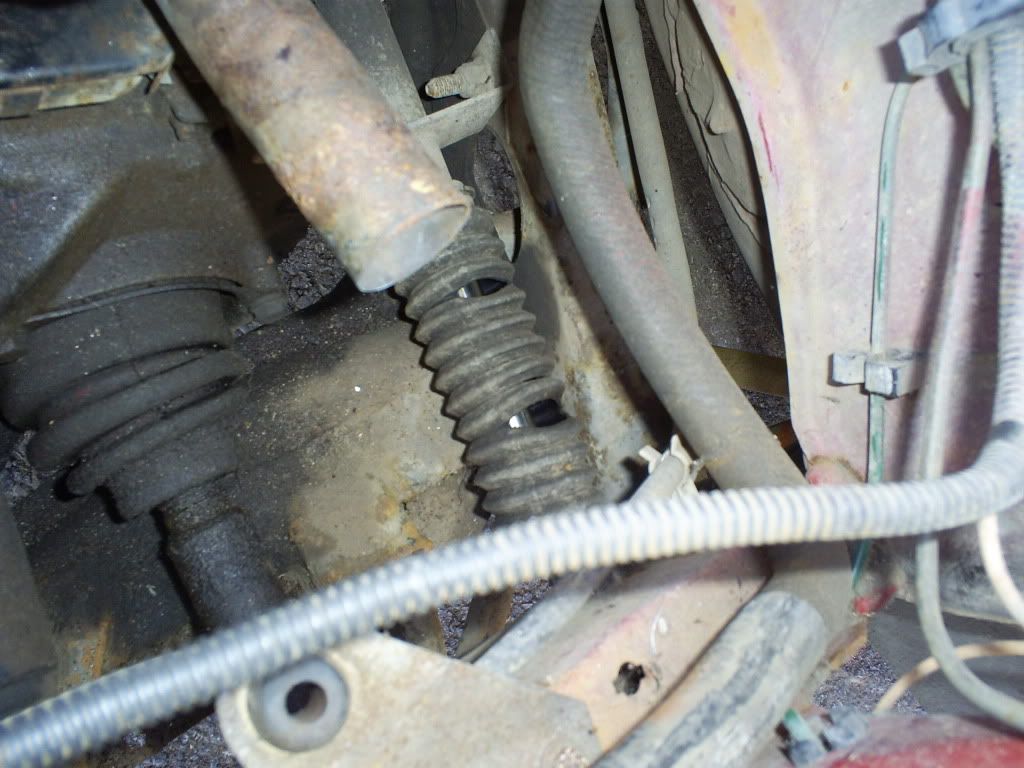

old steering boots
old track rod ends

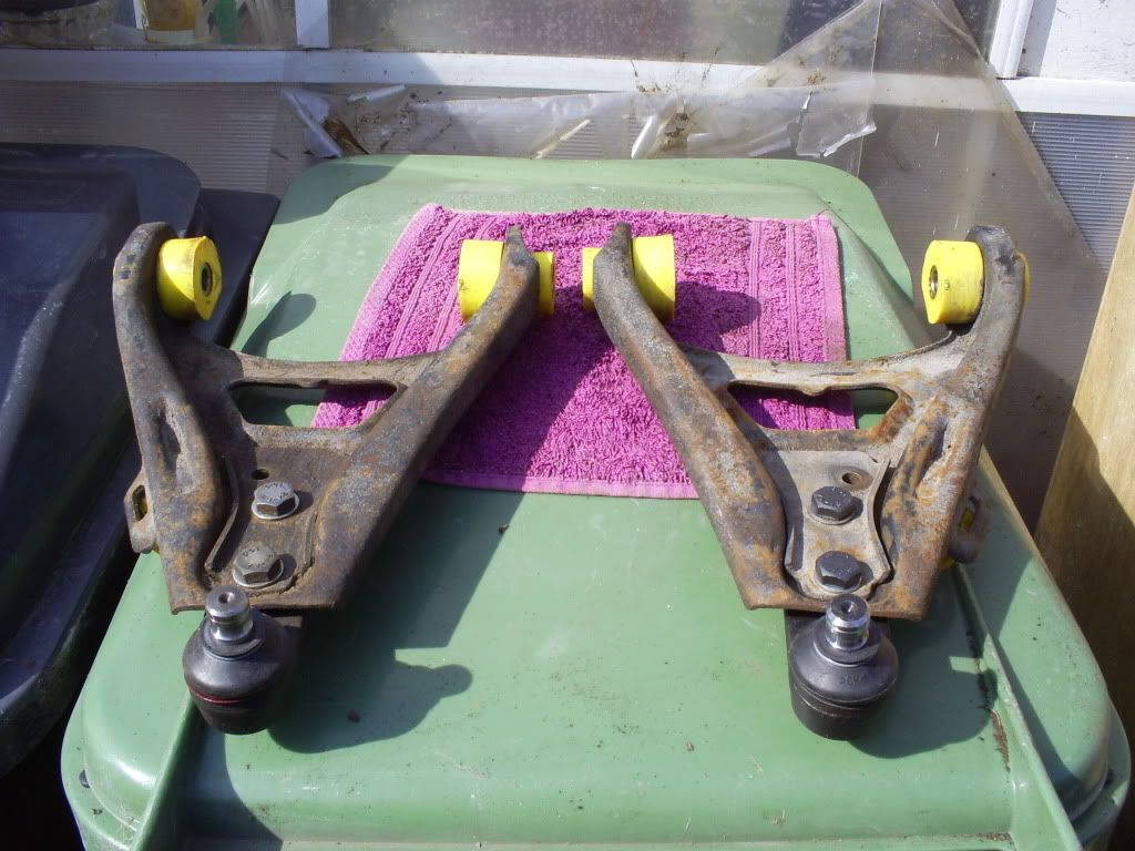

new arms ready to fit
and on the car
the problem bolt just would not undo/do up from this point and not much room to work
so Mr angle grinder came to the rescue
