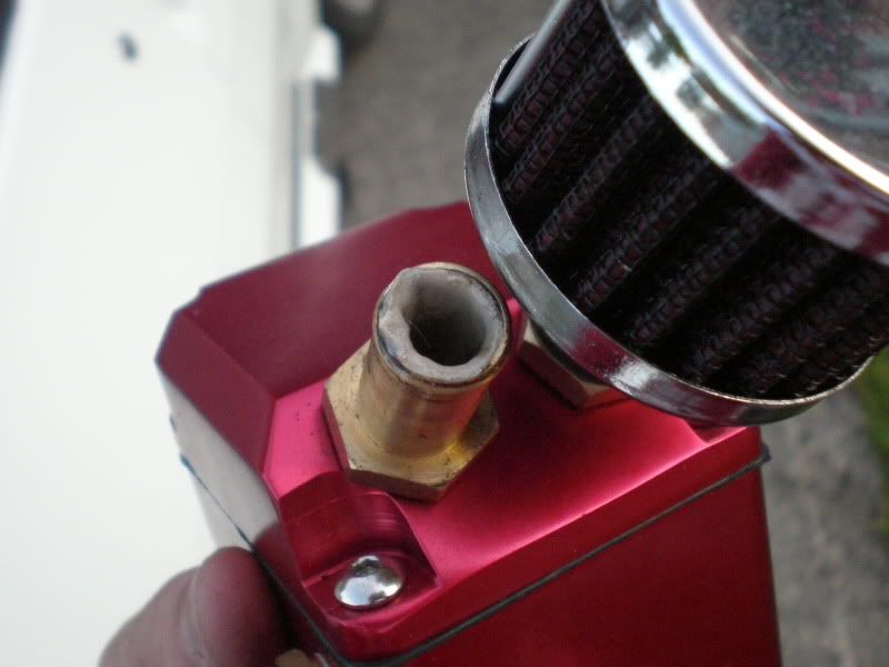

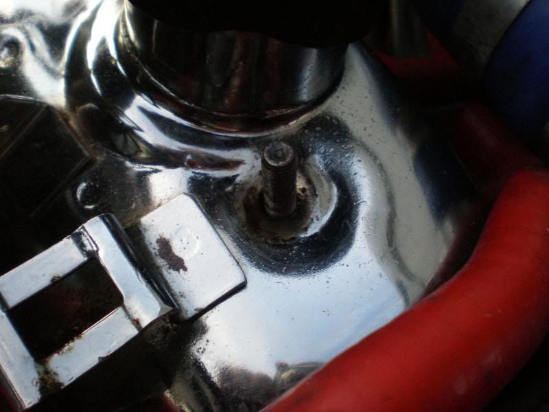

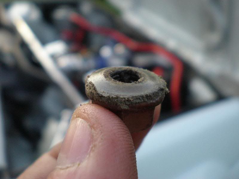

well i decided to hunt for this elusive oil leak. so far i have replace the oil cap!
and at japfest when i was checking my oil i noticed that where the valve cover is bolted down was bubbling oil!
so i've cleaned the nuts down and and put a ring of silicon sealer around the base of the nut and i'm leaving them to dry before i put them back on. i didnt have any o rings in that size so i improvised.
also i emptied my catch can there was a bit of brown water in it and this was on the intake side of it

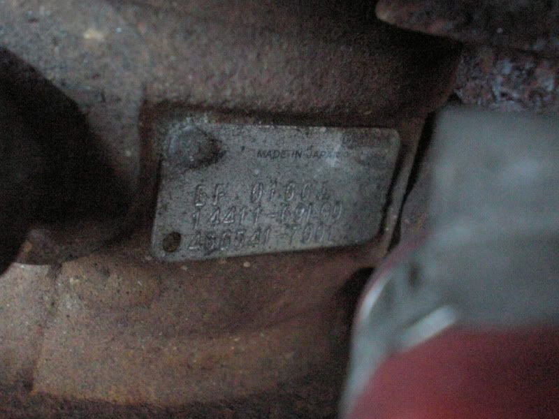

and i read somewhere about checking the serial number of a turbo to identify it?

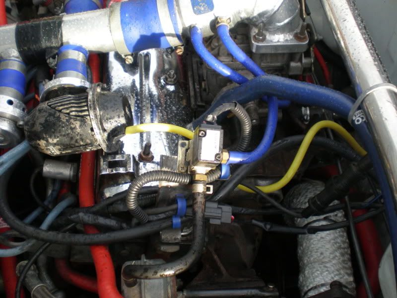

well fitted some heatwrap and re ran a few cables to try tidy it up a bit.
i also took off the heatsheild as it wa poorly mounted and was vibrating against the block which was increadably annoying.
Before
After
Re: arctic white gt
« Reply #24 on: 07:59, Thu 22 September 2011 »
My catch tank is similar.
Oily vapours mixed with condensation etc makes that brownish sludge. Nothing to worry about.
If you had that colour on your dipstick though, then it's time to worry.  :D
H150GTT
  • Posts: 271
Re: arctic white gt
« Reply #25 on: 08:51, Thu 22 September 2011 »
Alrite lad
Was just scanning through your pics and noticed that you have blocked off the sump breather.
You could tee this into your breather pipework from the rocker cover to the catch tank and it would keep the sump from pressurizing.. It would help stop oil leaks around the sump too..
You maybe have already done this..  :wink:
