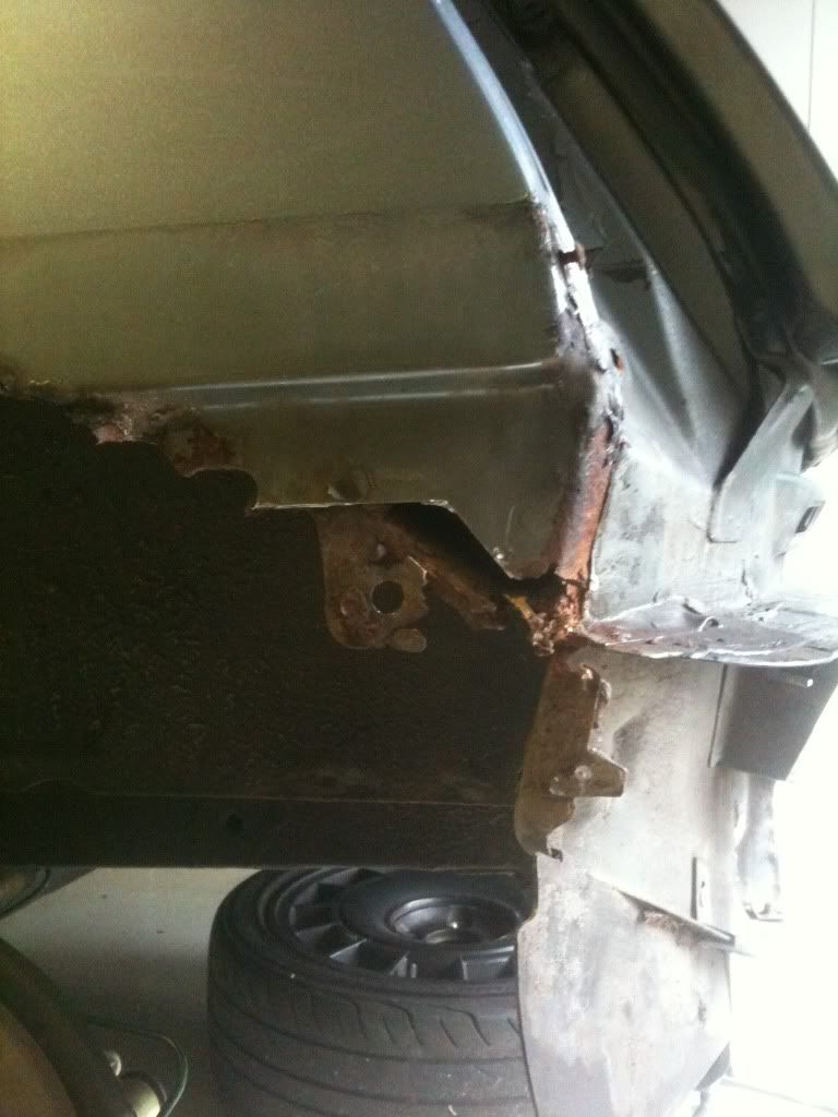

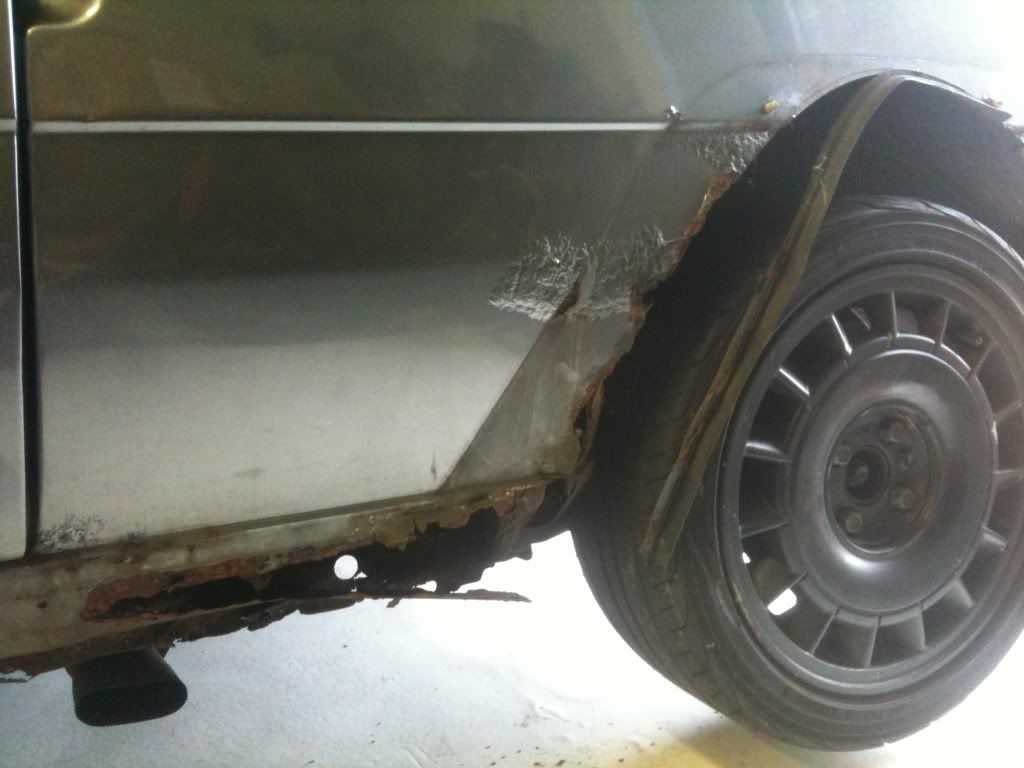

Its been a while since I've updated, the 5 was getting a fair bit of use beginning of the year then the MOT ran out and I moved house so not had time to do much with it or be able to drive it. Its started running a bit rought so needs a good service and the rust issues need sorting to make it MOT ready.
So now I'm settled in the new house and have the garage sorted to work on the car, I am starting to sort the rusting problems and fit all the parts I have been collecting over the last year. The car looks ok from the pictures on here but under the body kit and around the car there are lots of rust problems areas.

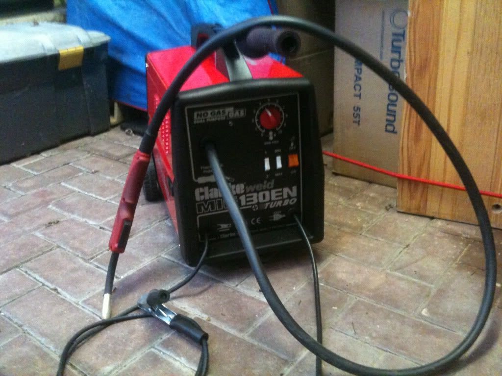

My first job was to strip the body kit and make a list of all the rust areas and how best to fix them. There is a lot of rust areas and I've pondered over scrapping it and buying a fresh one, or to what degree I take the repair work. I dont want to scrap the car, so I'm going for well done repairs over full restoration, the car is just too far gone for a full resto and I don't have the tools, time, money to do a full strip down and proper restoration. So to cut a long story shot, I've bought a welder, some metal cutting tools, grinder etc and will teach myself what I need to know to fix up the car. I could pay someone to do it but I'd rather invest in my own time and have the tools for future projects.
My aim for the car is to fix the rust problems, underseal the under body and arches, re spray bodywork and inside car, remove engine and paint bay. Refit cleaned and painted engine and new engine parts. Fit new seats and re trimmed interior. New brakes. Refurb wheels and new tyres. new exhaust....so erm yeah a bit of work to come... :o
here are a couple of pics off my phone to start with...more to follow.
Some of the rust:
The Welder:

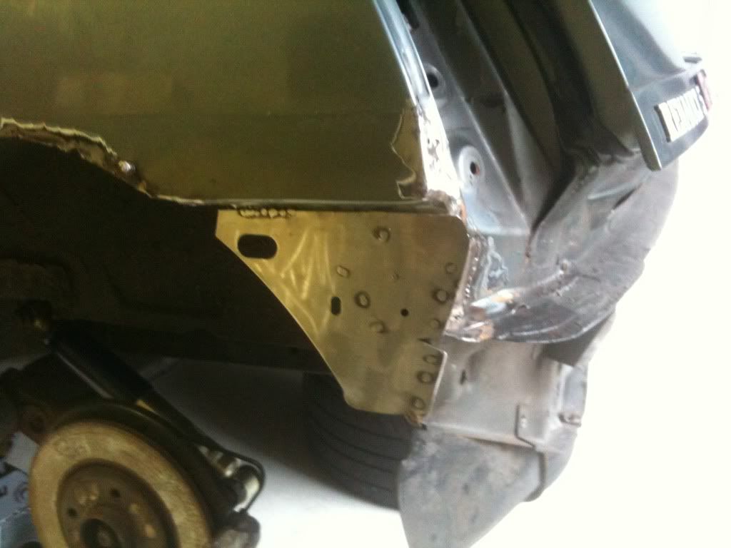

First repair:

Admittingly the rear arch does look quite bad, but to be honest I think you would struggle to find another one that didn't require any welding (at a sensible price anyway) I thought mine was reasonably tidy until I started poking around. I did most my cutting and welding just over a year ago for its MOT.
Those rear bumper plates look good. Did you make them yourself? The slots look machined in the pics.  8)  I still have those to do on mine, and a section just behind one of the headlights. I have a Clarke MIG welder also, but the lesser 90amp version (which was more then enough for this thin metal)

A pair of new sills have turned up today so I can work out what needs cutting off the car and what can be replaced this weekend. I patched up a hole in the n/s front wheel arch this week, another bit off the list :D
