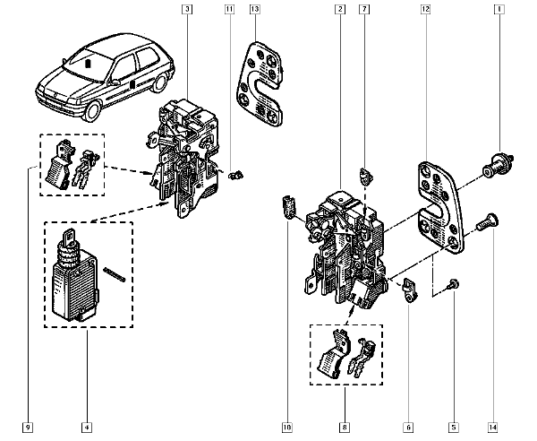

There is a cheap and easy repair / replacement which comes from the Renault 5's little brother.......the Clio. The internal door lock mechanism and electric solenoid for the central locking off a 1997 / 1998 Clio 1 / ph 3 ( the last of the 1st generation Clio's with the combined headlight and indicator ) will fit the Renault 5 perfectly.
The lock bolts in place and the connecting rods fasten up in exactly the same way.

The locks / solenoid you need will have "Vachette" stamped on them. They look different but fit perfect !!
