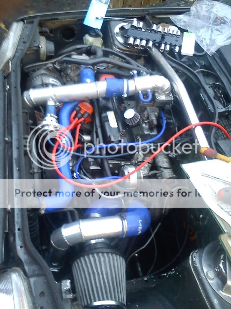

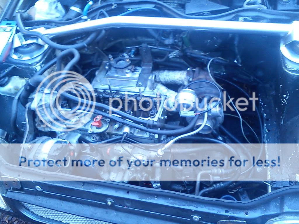

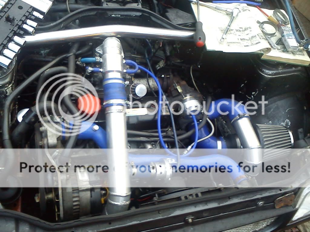

« Reply #22 on: 20:15, Sun 14 November 2010 »
its been a busy weekend! got the engine dropped back in and plumbed in a few wires and hoses on saturday. picked up the cylinder head last night with piper uprated springs and new valve stem seals 8) . So today we finished up connecting everything else in the bay along with driveshafts, new oil and coolant.
dodgy camera phone pics...
we managed to get it fired pretty easily(after a bump :wink: ) and it sounded well decent with the new cam and manifold on, but unfortunatley there was a water leak from inlet manifold so we had no pressure in the system....and lots and lots of steam!! will be back on the road soon - I cant wait!

« Reply #23 on: 21:21, Sun 14 November 2010 »
I would personally do something else with that oil breather filter, not ideal having it there.

« Reply #24 on: 21:38, Sun 14 November 2010 »
Quote from: "markey mark (bd)"
Agree with Mark, if something does go wrong you really don't want oil on the hot turbo and exhaust manifold :lol:
You really want to run a pipe to the OE oil seperator pot or run a pipe to a catch tank

your right there, the old breather filter snapped off and the engine was completley covered in oily vapour evertime it was running. I dont have the OE oil sepatator, but catch tank should be an easy option. Does the catch tank only need one inlet pipe attatched to it, or will an oil return pipe be required aswell?

You block of the original return to sump and jsut run a pipe from the rocker cover to the catch tank and the other end on the catch tank is the breather unless you get a mocal were it just has 1 pipe and the cap breaths
