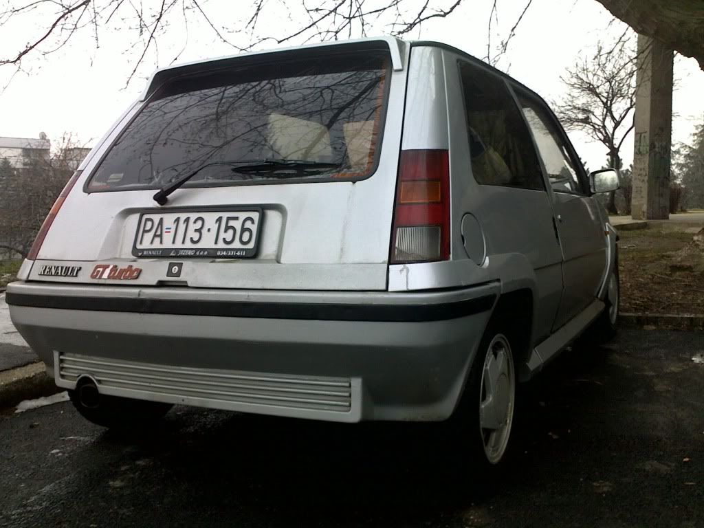

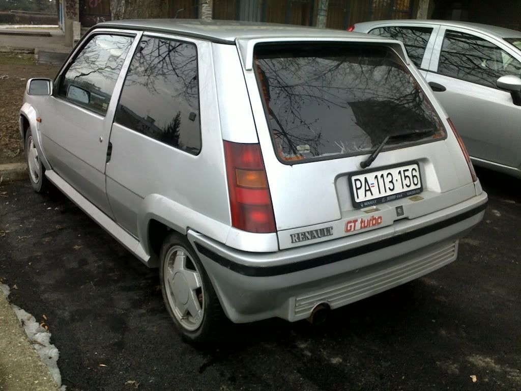

When i bought the car it look like this!

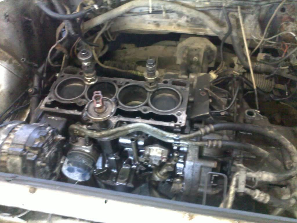

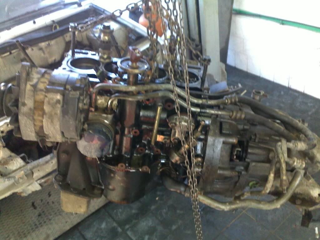

The Head taken Off and fully refurbished and polished, and engine taken out

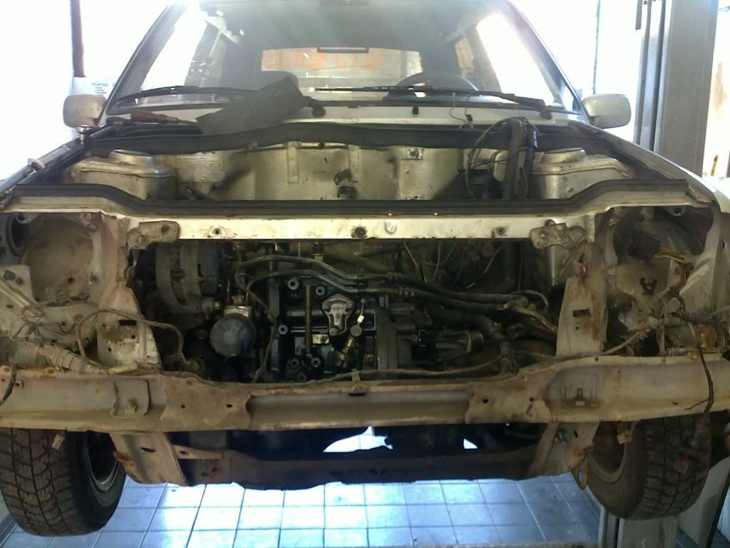

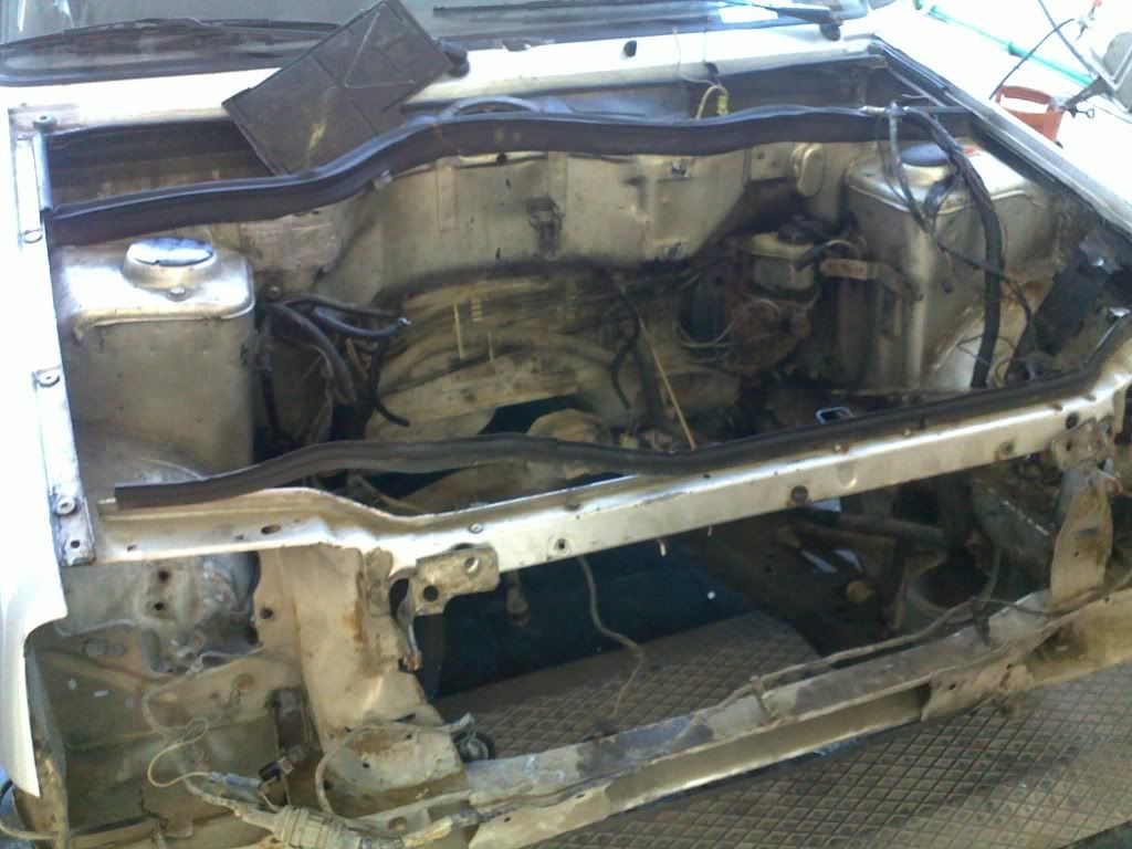

Engine Bay. To be Repainted and re-welded

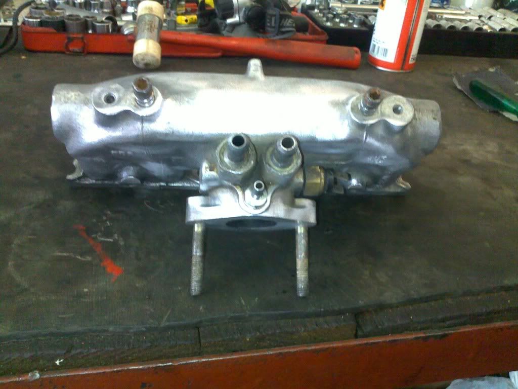

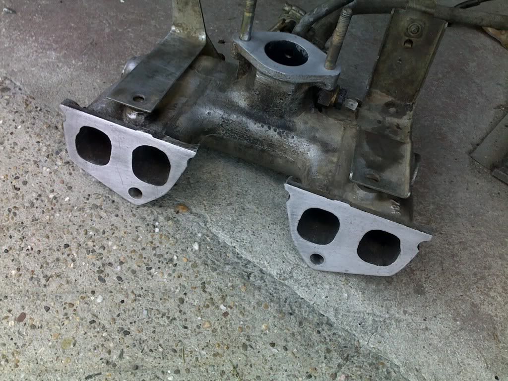

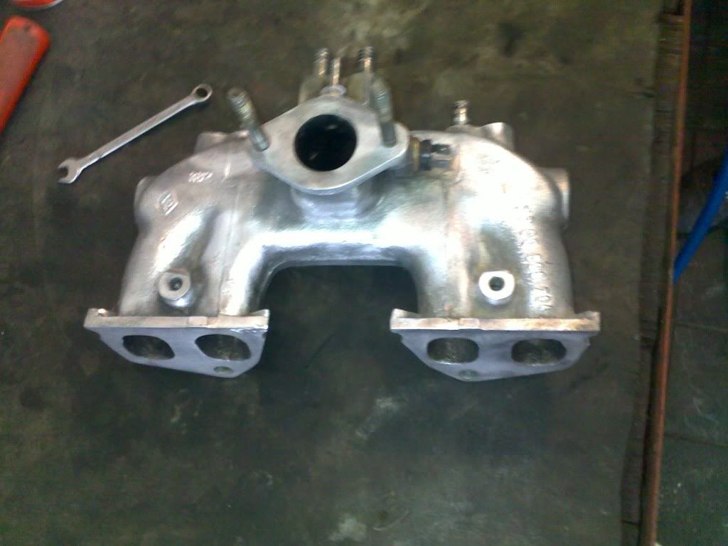

Inlet Manifold Before Full Polishing:
After Polishing:

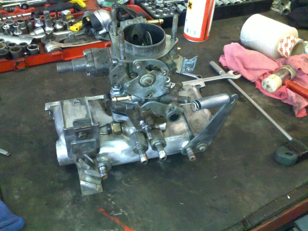

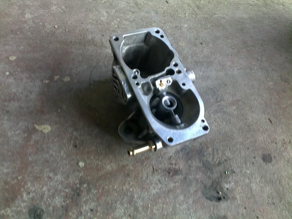

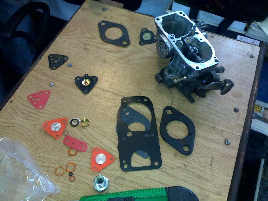

Group A carb to be fitted:
Group A Carb and Inlet Manifold fully Installed:

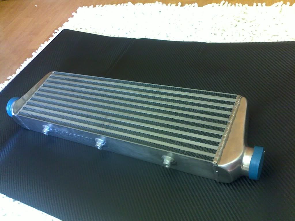

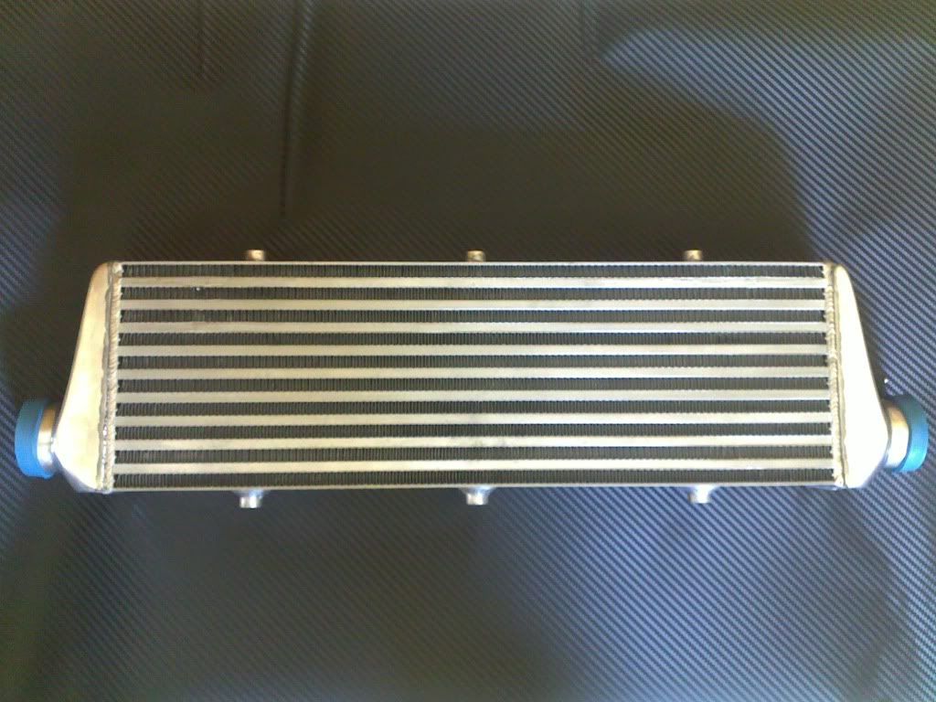

Alloy Intercooler:

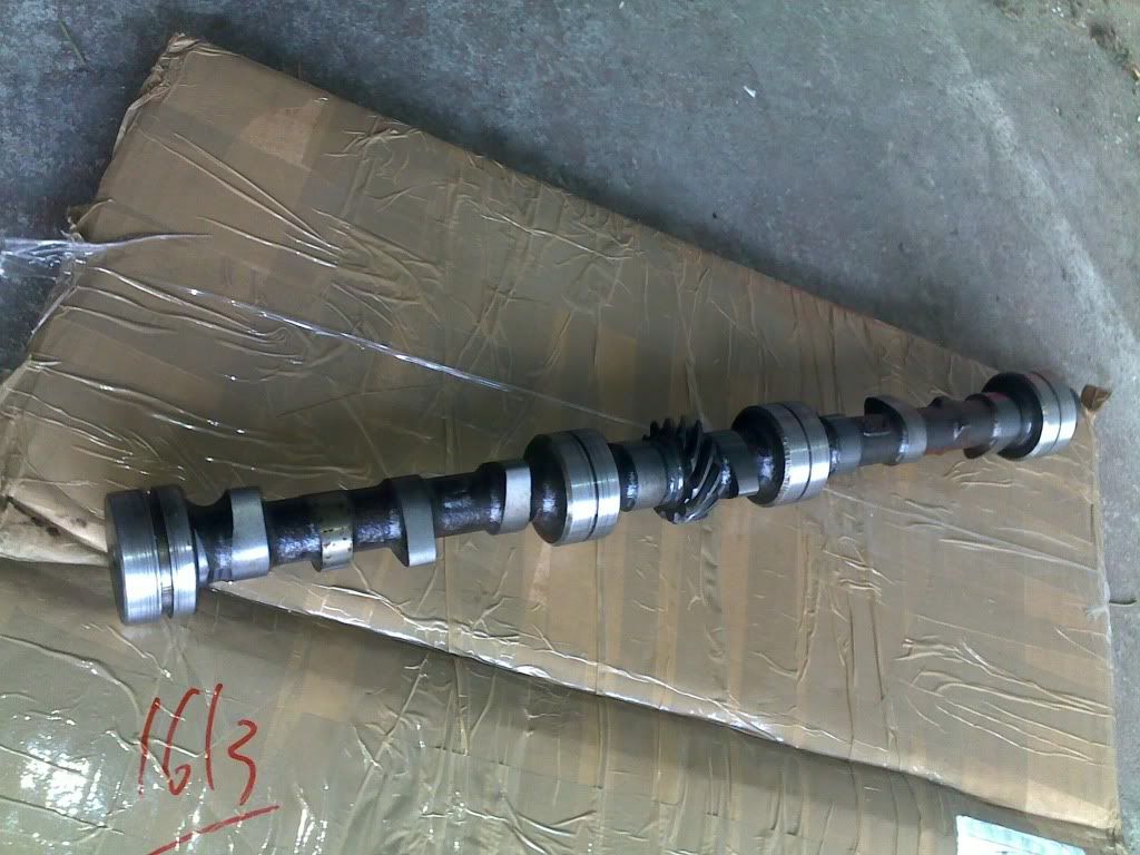

Piper Cam 285:

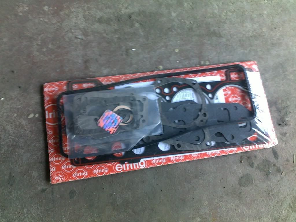

Uprated Gaskets:

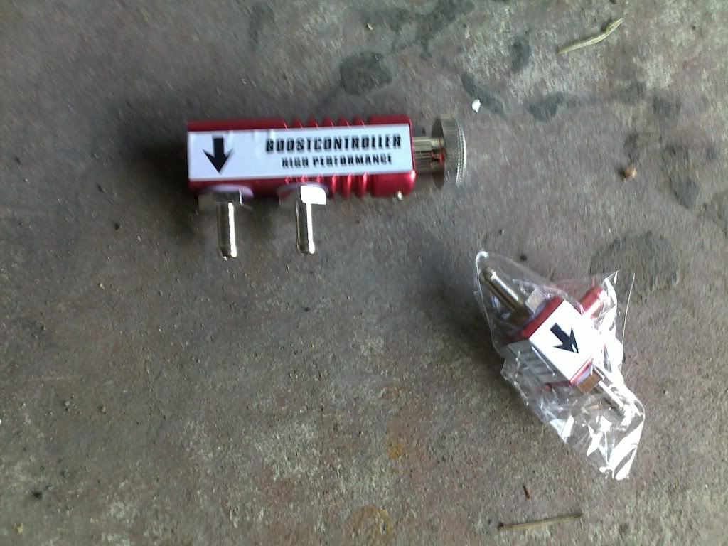

Boost Controler

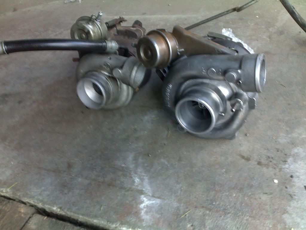

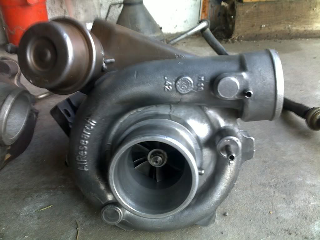

And the Heart of GTT :) Garrett Tb28 TURBO!
Tb28 vs Std T2

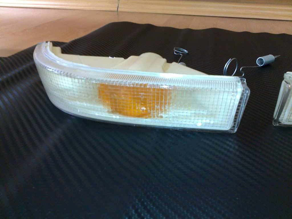

A bit of styling

Very nice job so far! It sounds like you want your car to go very fast! :) How much power are you getting from a T28?

Well it depends.. i am planning to go from 1 - 1.2 bar of boost.. That should go above 200 bhp..

You shouldn't need the water injection... IMO a waste of cash as well, plus if you set it up with the water you run the risk of det if the pump fails or the water runs out  :)
I was running 24 psi manifold & never saw temps above 35 deg with my set up (approx 220-230 bhp) my intercooler was slightly bigger but yours looks good enough to keep temps lower than 50 deg.
Usually rule of thumb is that to get 200 bhp you need at least 20 psi boost (manifold), unless the engine is high comp or has very good VE in the 1st place.
The carb will prob start to run out of fuel around 20-22 psi if the engine has good VE, then you need to start to look at larger needle jets or another way of keeping the bowl topped up with fuel.
Carb spec I'd prob be looking at would be, 1.2-1.3 main, 1 or .9 a/c, 1.3-1.4 2nd stage & at least a 1.9 needle jet to fuel nicely over a true 200bhp. You need to play with jets & wideband to find the best set up as every car is different.

Hi mate, thanks, This group A carb.  uses a 150 main jet and a 0.9 air corrector. At the moment.
Do you think this is going to be enough for boosting up turbo to 22+psi? And + i will drill the Jet  to 2mm..
I wanna rich 230bhp and then later on fit Nos 35bhp shot... :)
Thanks!

With a 1.5 main jet and 0.9 air corrector only you wiull run very rich off boost and prob run it lean at high rev's on boost, not the way to have the carb set up.
You want a standard size venturi, prob get away with the standard 1.2mm main jet, slightly smaller air corrector and then drill out the second stage jet so it increase's fuel on boost. If you want to run more than 20psi then i would recommend a larger needle valve too, something around 2.0mm will do, i found a place that sells them so can get hold of them.
