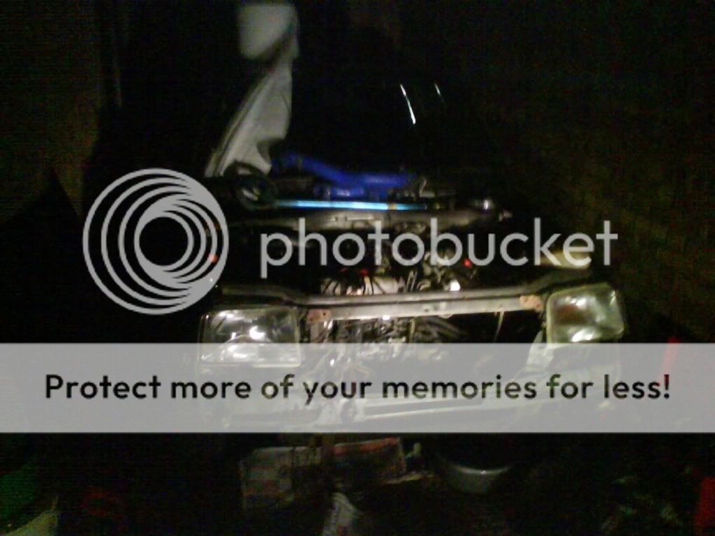

i know you scrather have the full set of silcone tubes that are off of ebay but i was wondering who else have these and other than the water pipe nippels easily breaking have you experienced any other problems and whats your opinion about these kits ? the reason i as is seeing as im looking at rebuilding most the engine i mite aswell give it a new look with these while i do the engine up.
i also got down the garage today and strip the engine down a little taking out the rad, water pipe, carb off, and heater pipes, boost pipes out. carb top
i want to give my carb a clean while its off, i was wondering what is the best stuff to get the shit off of it thats on the outside, so it looks clean, i have degreaser and engine cleaner stuff. but want something that will get deep down into it and take it off easily.
took this late at night but will get a day time shot 2moro or so.
