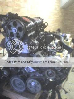

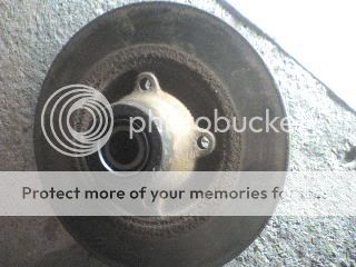

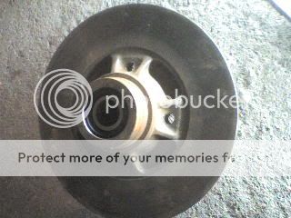

My engine is mostly back together, just need to get hold of a clutch centering tool and refit the gearbox to it. I jetwashed it recently which brought it up pretty well although I ended wearing half the water myself! Turns out the 2nd hand GTT rear discs I bought appear to be slightly warped which can never be a good thing. I bought a bargain set of Williams Clio discs a few weeks back - took a chance on them as they looked the same as GTT discs. Turned out they are identical but the bearings are fitted slightly further forward from the front of the disc.
This means the disc sits slightly further back so they go solid and won't move when you tighten the centre nut.
I don't know what the part of the axle is called that sits on the stub axle the disc mounts on - the little round removeable part wheich the disc slides against. These must be narrower on the Williams I'm guessing! I might try some hardened steel washers to bring the discs forward a couple of mil. Don't know if it's the right move or not?

engine back together minus gearbox

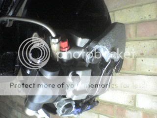

A brand spanking new caliper actually in place at last with new pads in

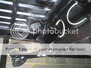

Axle's been on back on for ages, all electrolysised and painted
nicely warped GTT disc - fits perfectly
Williams disc in perfect nick with new bearings in - won't fit my axle for shit!!! :lol:  :x  :x

Rear discs, calipers, compensator, brake & fuel lines, new handbrake cables and fuel tank all back on. :)
Turns out my turbo discs weren't as warped as I first thought there's barely any movement against the pads when spinning. I've stuck the williams discs on ebay now as I can't use them which is a shame as they're in spanking nick!
Spent the weekend making up pipes and plumbing them in and getting the fuel tank back on - trying to stretch the flexi breather pipes big enough to fit where they go on the tank when they hardly want to reach as it is what a fun job that was! :roll:
Quick question: when you buy brand new calipers do you need to lube/grease them yourself or is this done when they're assembled in the factory? Is this what the grease nipples are for?? sorry for asking stupid questions, never fitted rear calipers to a car before :lol:  :oops:
