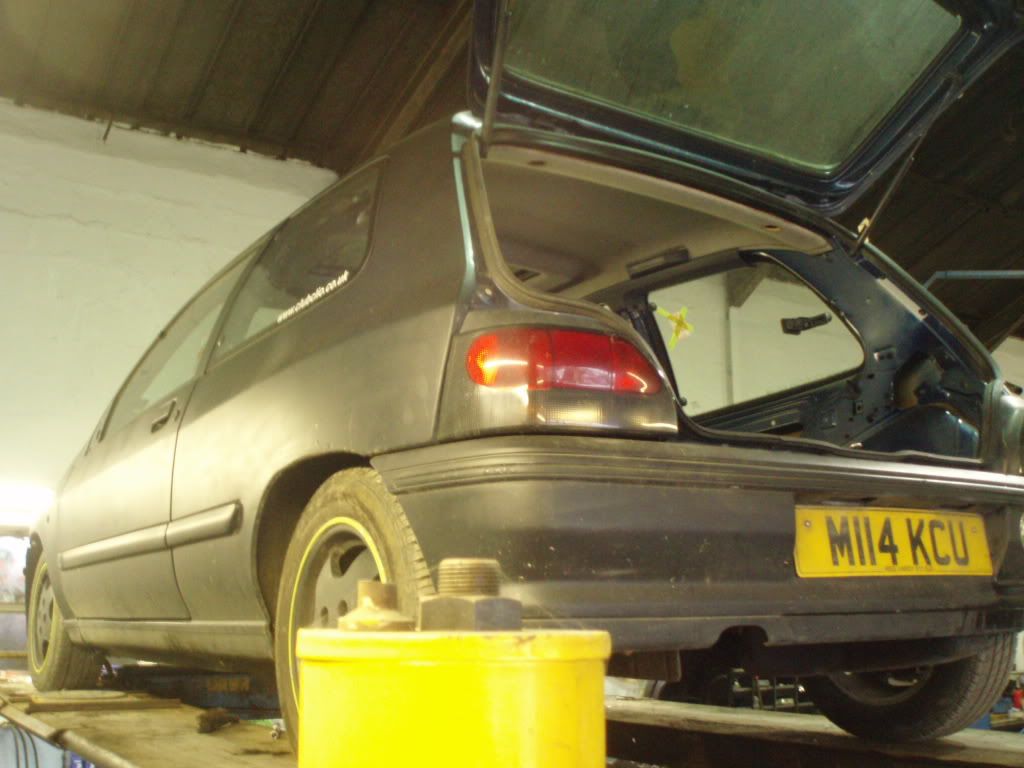

Wanted to do this for awhile and thought bollocks to it and so i've officially started the Renault F7-5 (is the code name for the project). I've picked up the donar car which was used as a track day hack, used a few times and then left abandoned in his garden for a year. Engine cylinder block sounds superb, no crank bearing clearance issues or knocking knock when cold, although it does tap which is to be expected if the car has been literally sat in a garden for a year. The plan was to check the cam belt, guide & tensioner bearing and for the sake of 20 possibly fit a new water pump even though it's aux belt driven. I am half tempted to fit a set of williams camshafts to it along side a set of new hydraulic lifters aswell although performance wont be drastically altered as iirc the williams cam spec is only 1* longer than that of the 1.8 cam profile. Given this fact though I guess every little helps. So anyway, here's the donar car which did have a full interior (minus the center air vent which has a push start pad)...

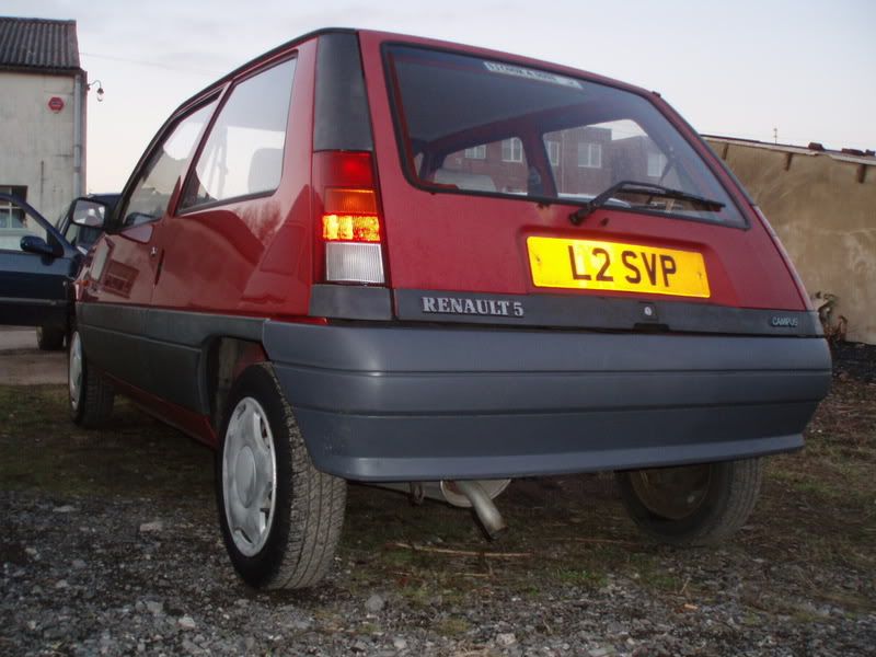

...The car in question..
It's since been fitted with what seem to be rather rare 14" optional extra Clio alloy's which seem to go with it's retro box type appeal (got them off a scrap car ;)) Tyre spec on the previous wheels were 145/70/13, new tyres 165/60/14 and in effect, feels slightly less floaty as a result of reduced tyre wall compliance

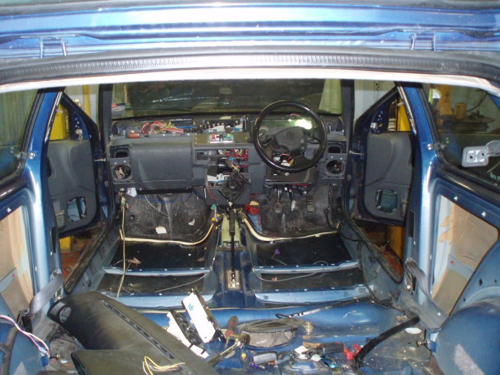

Done abit more to the 5. Tried to fit the clio fuel pump into the 5 tank, but obviously this was an epic fail given the sender is located under the rear seats and it uses an externally mounted pump. So, removed the fuel tank from the Clio and couldn't believe how almost identical they were! I thought i'd have to mount it by welding additional mounting points/captive nuts in, truly excellent! The fuel tank breathers were abit of a pain and the fact the fuel lines ran slightly different on the Clio mean't having to modify some of the pipework. Also fitted the rear wiring loom

Little update...Removed the dash board and err that's never going back in, what a stupid design! :roll: Anyway, got everything required out the way and here's the score currently..
