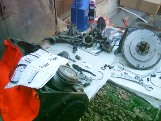

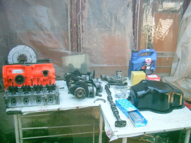

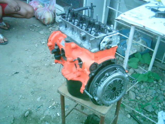

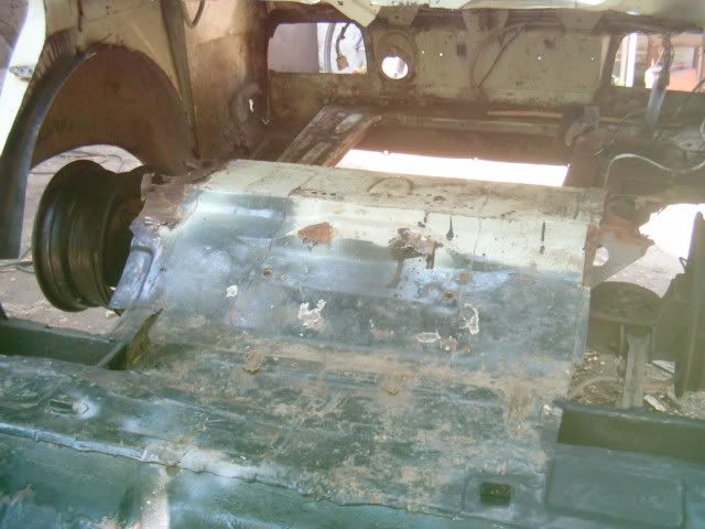

 Two years ago I started a rebuild I have a lot o pics but I will post only a few
This is how the car looked when I got it
Alot of rust to deal with and much body work

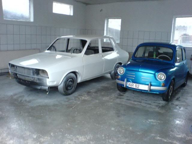

With the prep done waiting for paint, and a picture with the car at that time

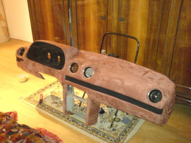

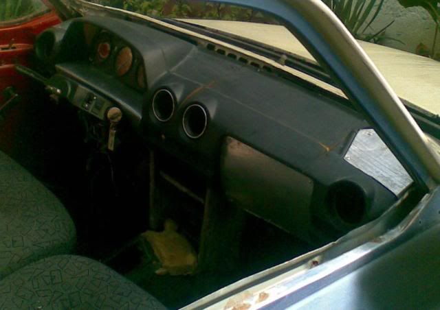

A complete custom interior, only now I have a much nicer momo steering wheel

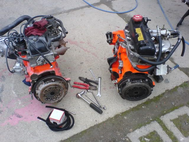

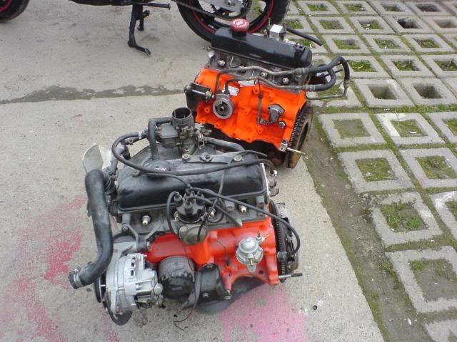

The engine that dacia has is very similar with the gtt one so... this is how the madness came to my had, and I started preparing a dacia engine for turbo
But because the remaining parts that I needed ware more expensive that a gtt engine that I have found...
and a comparison with the 2 engines

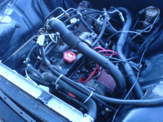

But last fall the turbo failed, so I started new mods under the bonnet and with it problems, and this is where I hope that you could help me with some pointers

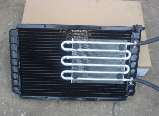

I made a exhaust manifold to the side of the engine, front mounted the intercooler, new water cooler, new oil cooler, new hks ssqv blow off, 60mm exhaust

And now I need some help/tips
The side manifold that I made is crap, (I am using a KKK turbo not the T3 in the picture above) the pressure wont raise above 0.4 bar because I made some really ugly welds there.
Now I'm preparing to make a new side manifold and shold I grow a litle the inside of the pipes ?
