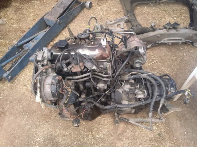

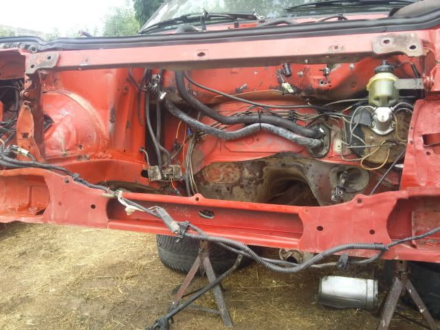

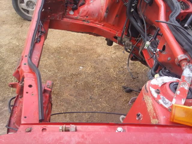

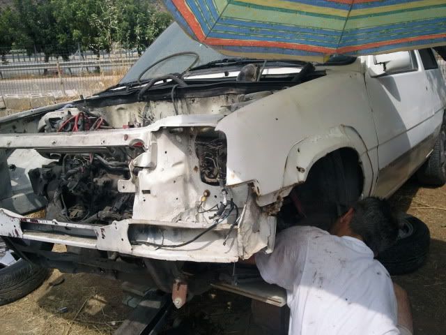

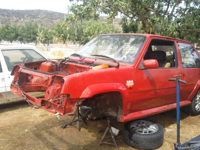

  Right, to cut to the chase now. I got 2 R5GTTs one with papers(Phase 2) the other for spares(Phase 1) (although its in ok condition). After a failed try on changing the small metal parts on the base of the "Piston Rods" on the phase 2 car , we found out that the engine had one faulty piston rod and some more excess damage. For the time being we decided putting the phases 1 engine on the "good" R5.While getting all the good stuff from the phase 2 moteur.

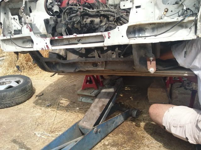

  We were told by a trusted friend that the engine from the phase 1 i got, it's in great condition, cleaned with upgrated cam (stage 1) and MAYBE (that's a huge "maybe") changed better aftermarket pistons.He wasn't sure about the pistons cause of the long time ago it was fixed. To make long story short, i transferred both cars on a dear friends open space that he has in front of his house. The whole engine swapping from the one car to the other, took us 2 days (5-7 hours per day). I was totally afraid that after all this mess the second engine would prove broken or something. Well that would be the time when i would turn BOTH cars in a huge bonfire and dance in circles like a native indian.     :lol:
So let's put some pics on.
After the failed fixing of the 1st engine.
Inside
1st failed moteur
Inside

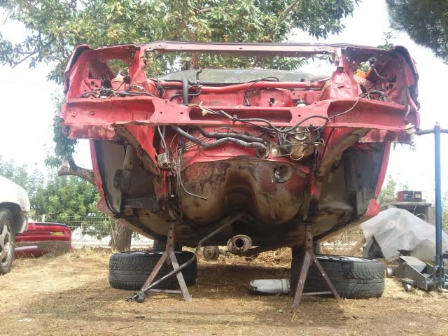

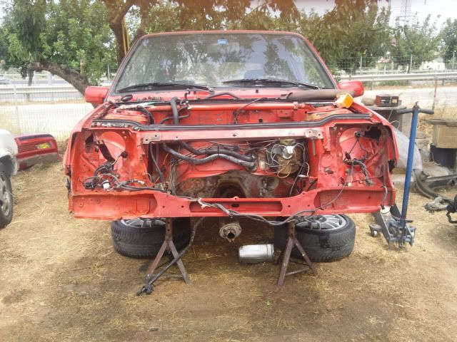

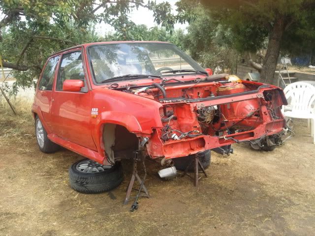

On the friends open space, engine off...
Broken engine

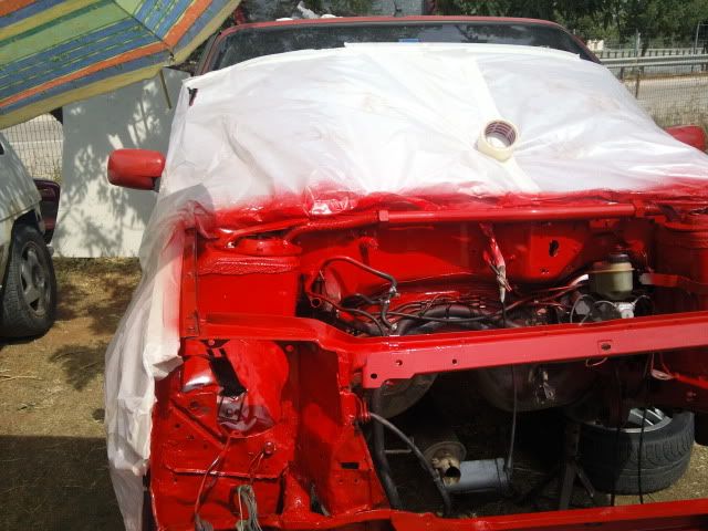

Engine bay cleaned firmly.
Painted engine bay in yamaha red :D

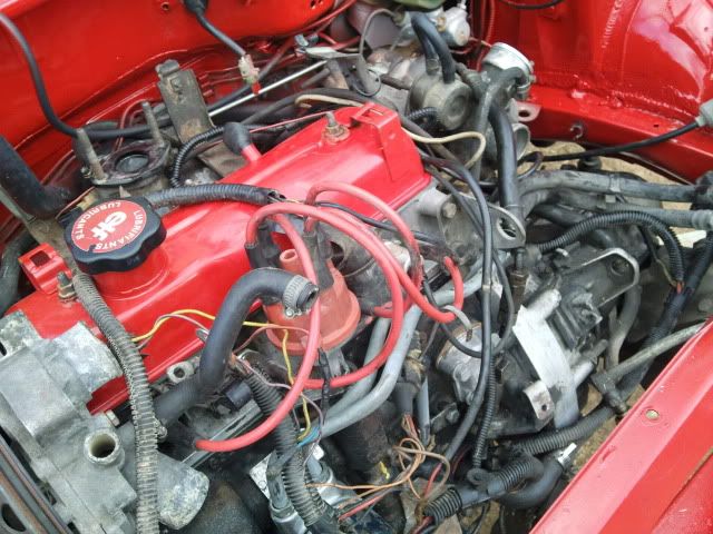

Phase 1 engine:
Firmly Cleaned and just leveled on engine bay
After all were in place, new oils-filters etc, came the moment of getting it started.. I was afraid the worse to happen, but by miracle... after 3 secs it started.... Running smoothly like a kitty cats belly noise :P no cliiickss no claaksss no weird sounds, fumes or anything.

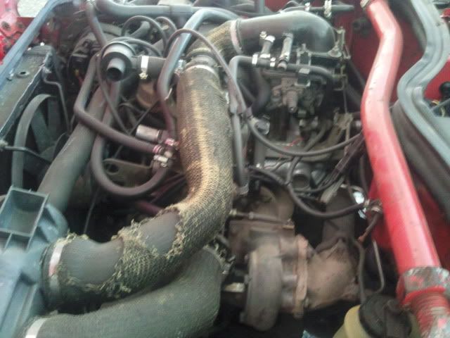

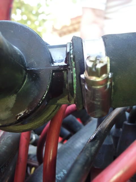

On 3rd gear it stalls a lot.. i think it's the fuel pump. carburator is fairly clean but maybe it needs some tweaking too.. After i drove it home (slowly with no weird driving...) i saw that  the stalling persisted on 3rd gear and above so it must be something on the fuel system. Also i saw this (like oil came out on the dump valve (i don't know if it is something old but i just saw it):

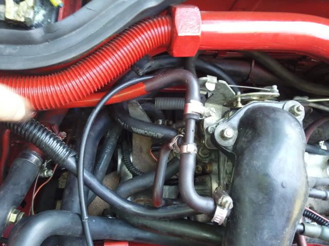

Car  has cup mod on the turbo hoses(i did it after , as i saw it in here, ignore the pictures while we placed the moteur in.).  Also it has aftermarket (handmade) water cooler with the original oil cooler outside (previous owner broke old fridge and took the oil cooler tube out, then he installed new and improved water cooler.
 I have some problems that i'm asking some help to resolve. Oil and turbo organs don't work in the organ panel. turbo hose is connected on the plastic hose on the carburator though. Stalling on 3rd gear and while boost is coming in, im pretty sure its fuel thing but any advice would be great. Also i can't adjust and i don'y know what boost the turbo runs at the moment cause of the non working turbo organ.
 Also water hoses aren't placed right cause the bonnet can't close. Water circuits, but it's just to tall over the alternator
Any advice would be really helpful guys Thanks in advance.  :)  :)  :) :P

OK so new fuel pump fitted, 2 fuel filters too one before and one after the pump. After this task, stalling disappeared completely, also after replacing and putting all carb tubes, turgo gauge fixed. I installed an aftermarket psi gauge too, to be able to see the readings a little bit better.
  As i said i've done cup mod on turbo-carb hoses, after installing the aftermarket psi gauge saw that max boost was at 5 psi :S :S :S .
   I lifted the boost via the actuator arm. i turned it 2 times and saw 1 psi more.... I turned it 5 times more and saw maximum 7psi... What is happening faulty actuator maybe?? Also while applying first pressure on gas pedal it stalls for 2 secs but then revs normally... Guys some advice..

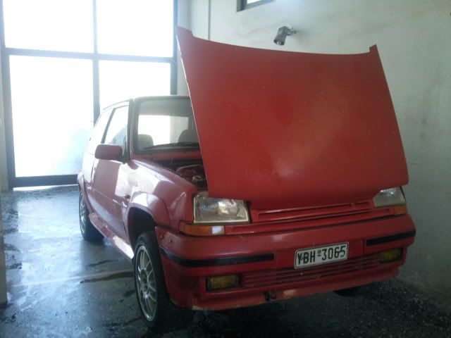

I resprayed my car fixed the most of the rust etc still doig a bit of work till its ready.
THought putting some pics with the Phase1 arches on!
