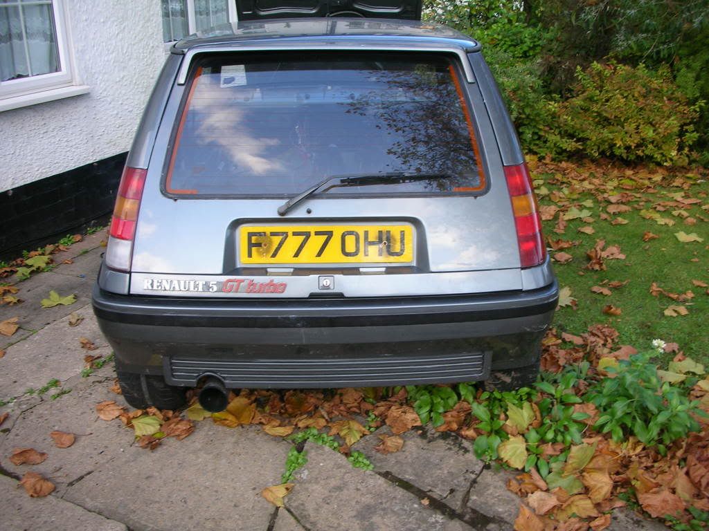

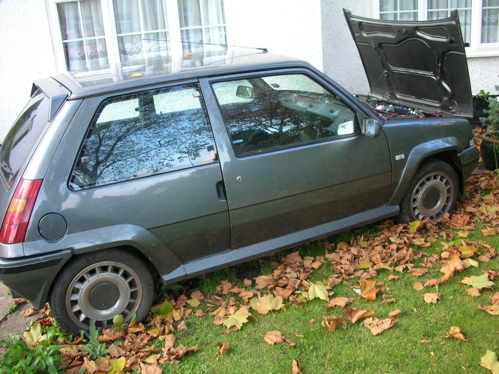

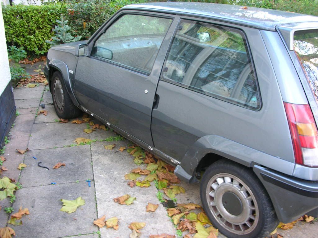

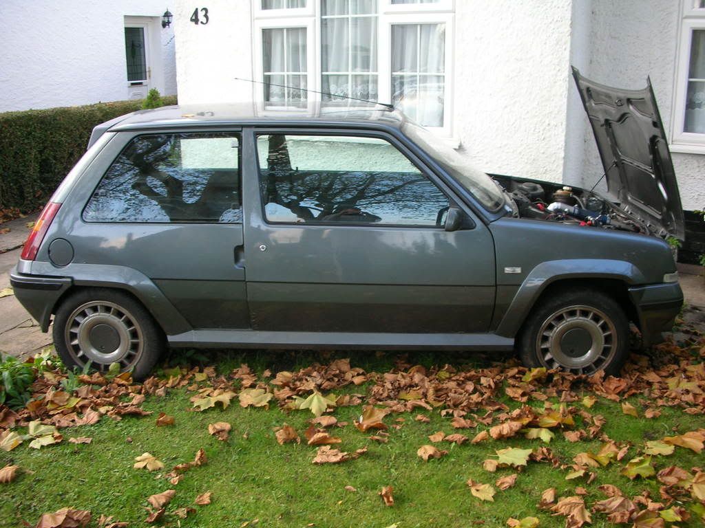

car had been sat on my drive for a while, cos it wouldn't start (fuel pump relay had gone) i lost my job couldn't afford to do any thing with it, and to make it worse it was leaking, i thought i would fix the leak before i got it running as it could be a long time till i got a job, and by then the rust could be eating the car up

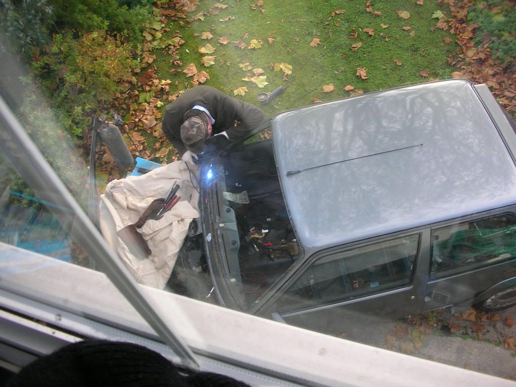

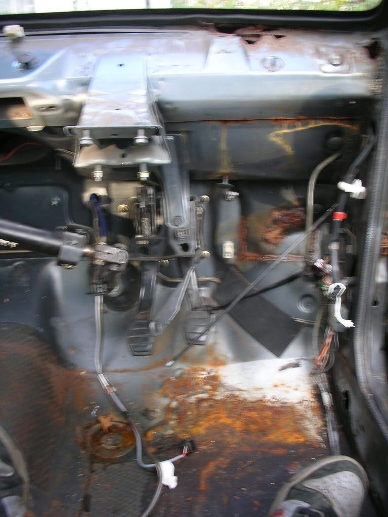

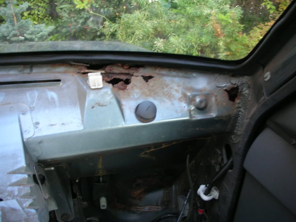

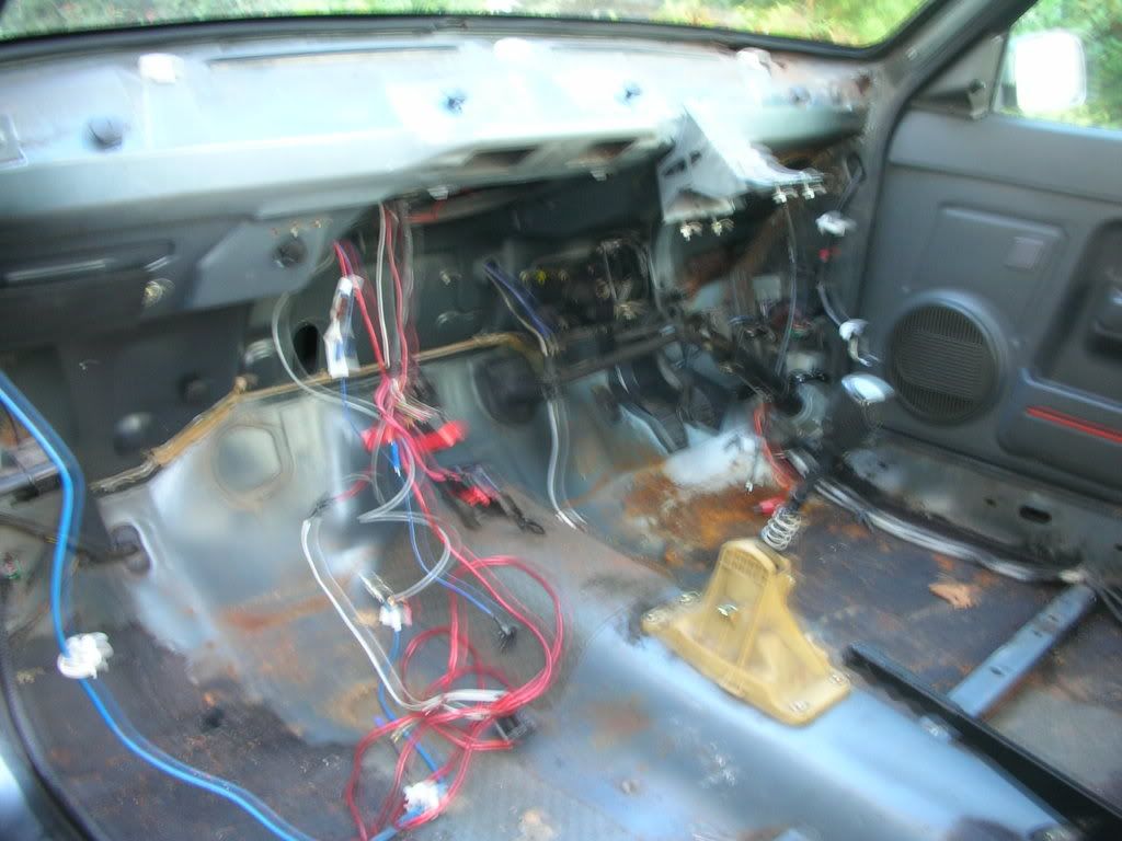

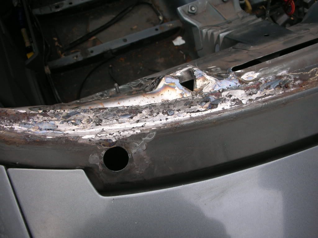

thought the coolant was leaking into the floor pan, but when i took the dash off  to have a look i realized where the water was coming from.  on the driver side had completely rusted through, i got the window out so a new plate could be welded over, but when i got the windscreen out all the bottom of the front window sill was rusted where the rubber had perished and the water was sitting in the sill its self

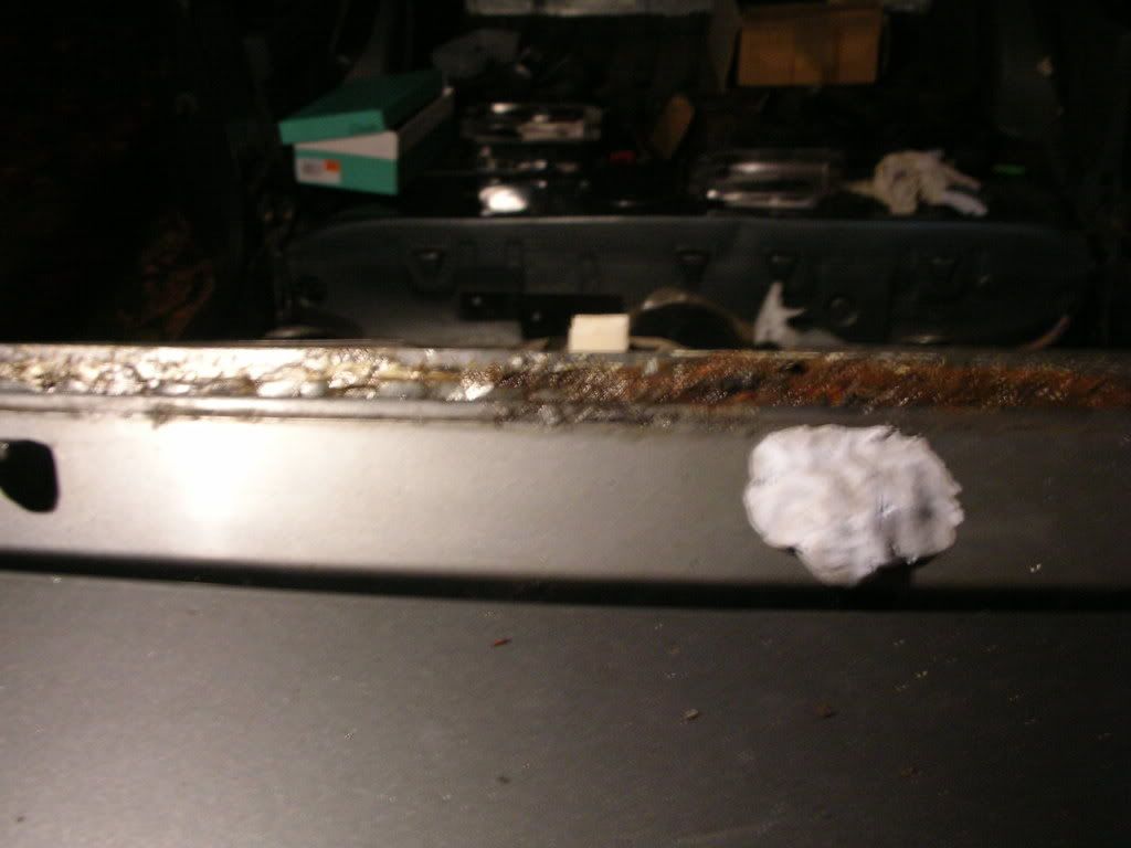

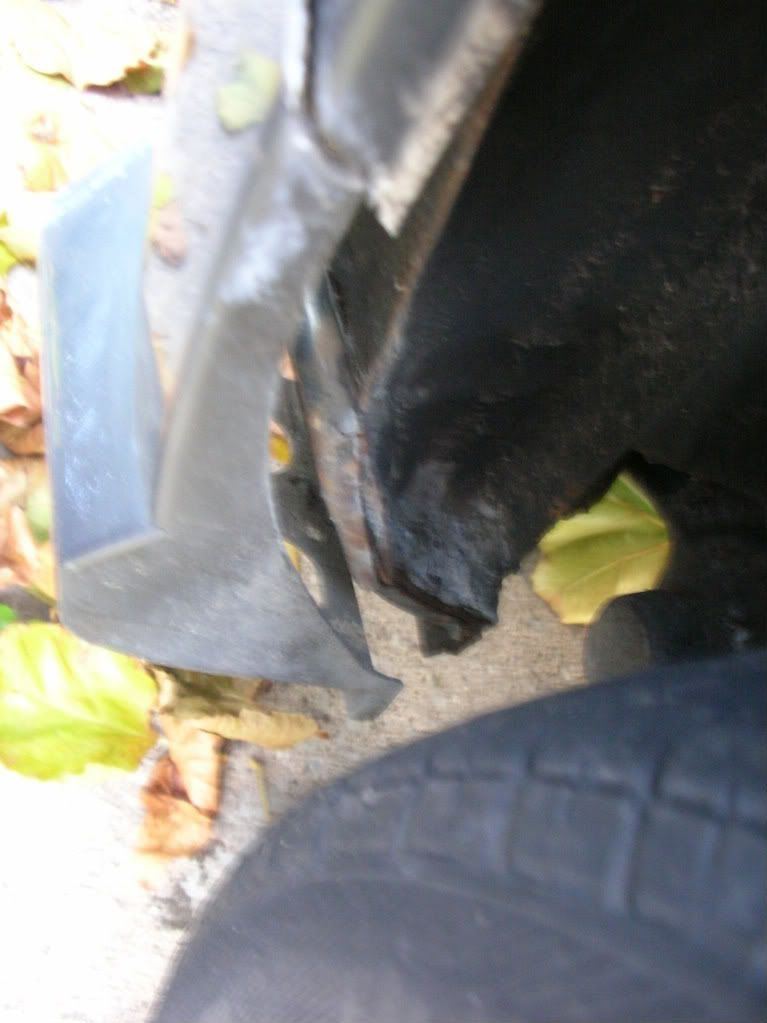

after the new plate had bin welded, i took the windowsill back to metal and treated the rust, i was using u plastic tarpaulin to cover my window over night, and one morning after i had taken the tarpaulin off and tucked it under my car for safe keeping my dad decided to fold it up tided and get it out the way, but as he pulled it our from underneath the car the tarpaulin caught the back left quarter panel and side skirt and snapped it pretty bad,
after i pulled it off completely i realized it was only held on by silicon filler and a cable tie at either end, and the other side wasn't much different,

there were small bubbles of rust around the back windows and underneath the skirts was a mess, i cleaned what i could off, and tided it up as best i could, but i was left with tatty paint work, the inside of the foot wells didn't look to pretty either

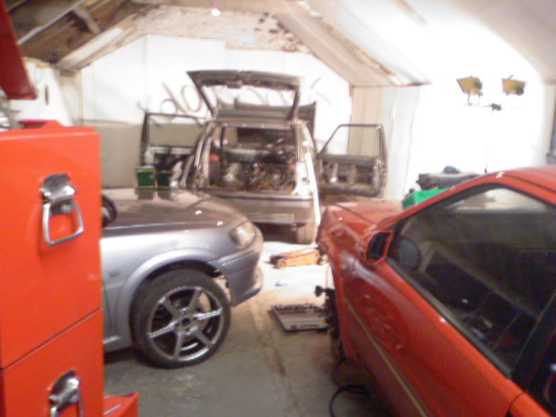

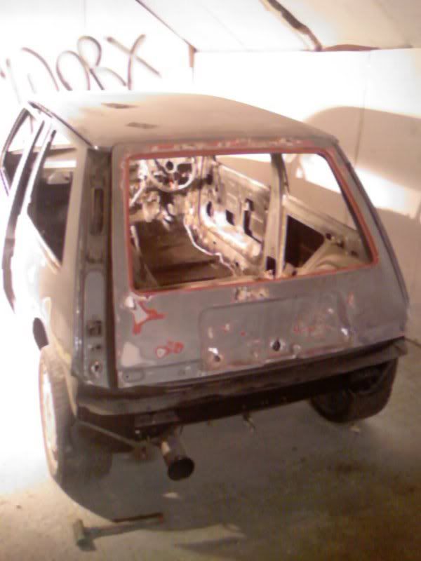

a mate had just started renting his own unit (barn) where he was spraying cars, offering me a heavy discount he said he would give it a full color change, and sort all the rust out so having just landed a wedge of money it seemed a silly thing not to do
(thats his red 106 rally gti turbo and another mates 106 quick sliver)

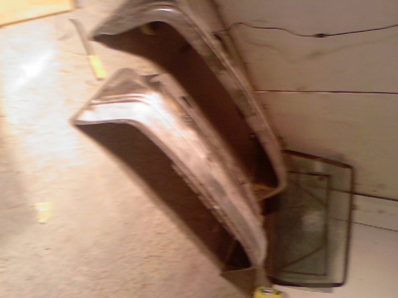

new bumpers both side skits and front and back quarters were brought

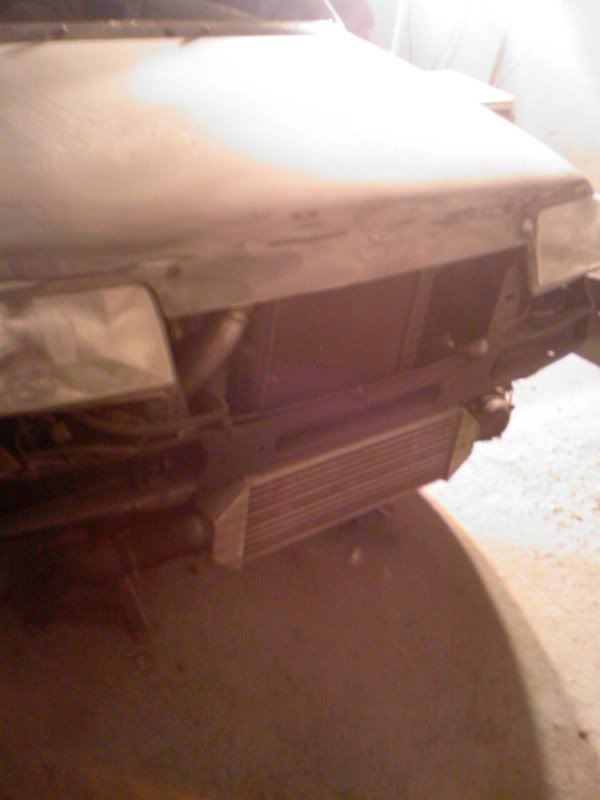

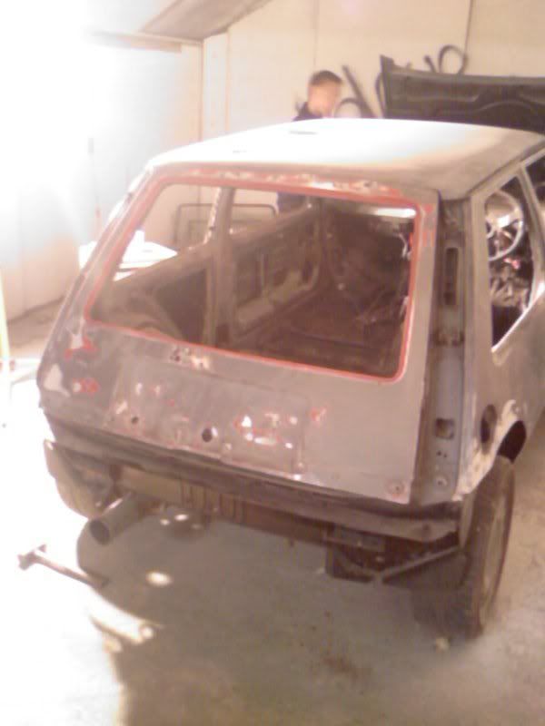

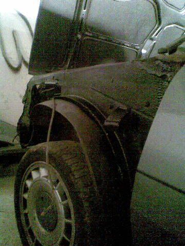

when my front quarter wing was taken off it was all rotten underneath all the rust was treated and undersealed along with the wheel arches
« Reply #1 on: 21:42, Thu 14 May 2009 »

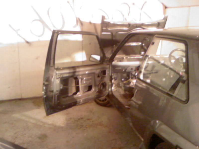

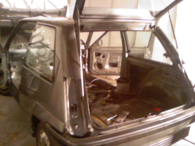

my car taken back to metal
all rust treated and undersealed
(sorry some of the pictures are pretty shitty, my mate txt me em, and the quality was lost  B) )
prepping
* SPRAY TIME *

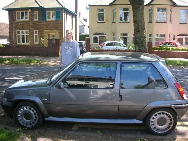

i think these are the only 2 5gtt's in Cardiff what made me laff even more is where both called Pete - don't hold me to that though, there is a Grey one i've seen, but i think its a campus made to look turbo'd............. any way;
(the head in the picture is of another mate - also called pete at one point on my drive there were 3 petes and 2 R5's - silly i no but it makes me laff)
