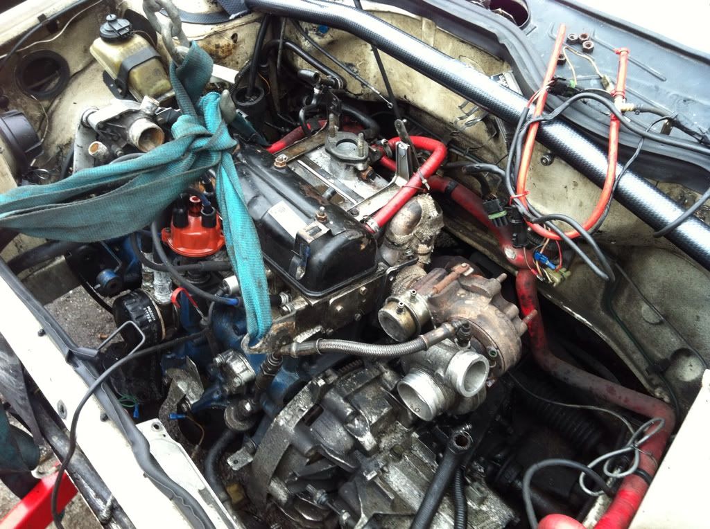

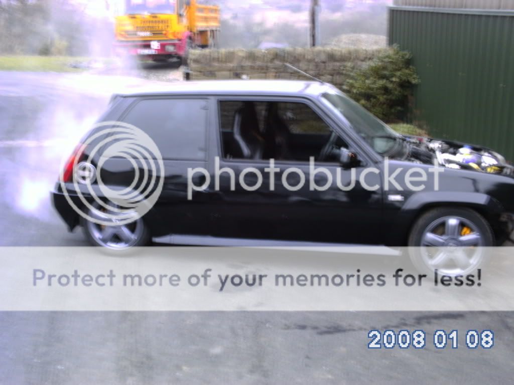

hi here are a few pics of my r5 gt im rebuilding
these are pics from when i first started
nasty intercooler someone mounted on the front of the car and cut out the slam panel making me loads of work drilling out and fitting a new slam panel
awaiting my new piston and liner set

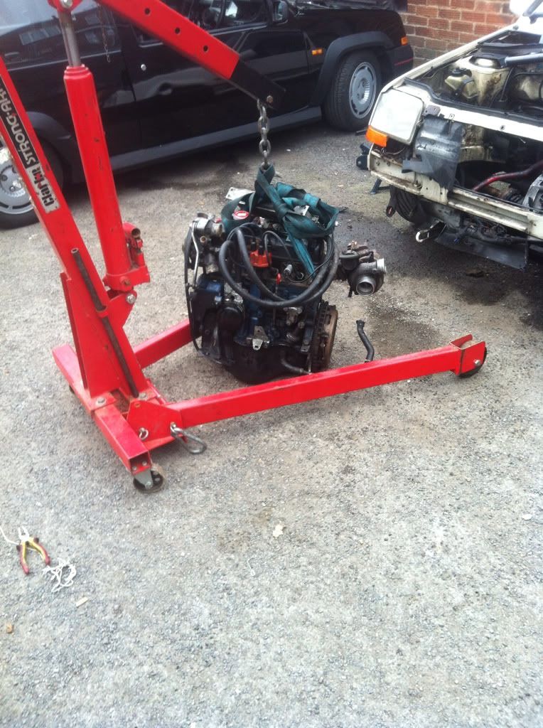

few pics of engine after rebuild
 this is the exhaust im fitting taking off the twin exhaust

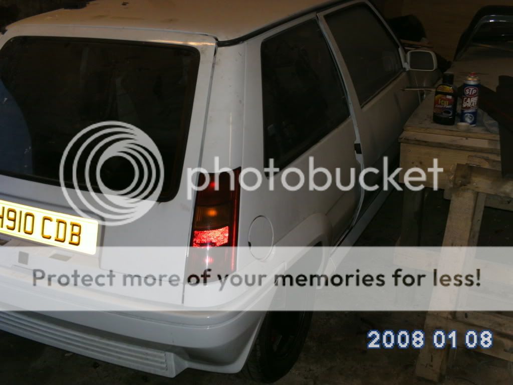

here are a few pics of  my donor car

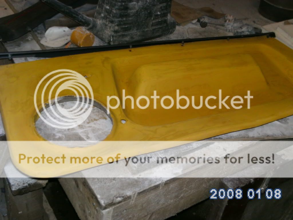

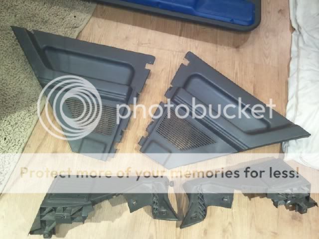

door cards filled and primed ready for gloss black paint
my next plans are lift up the back end, fit a new standard front slam panel bumper and grill. new back bumper, tidy up the engine bay and get the auto sol out lol. new t2/t25 turbo. mint all the body work and fit my new door cards.

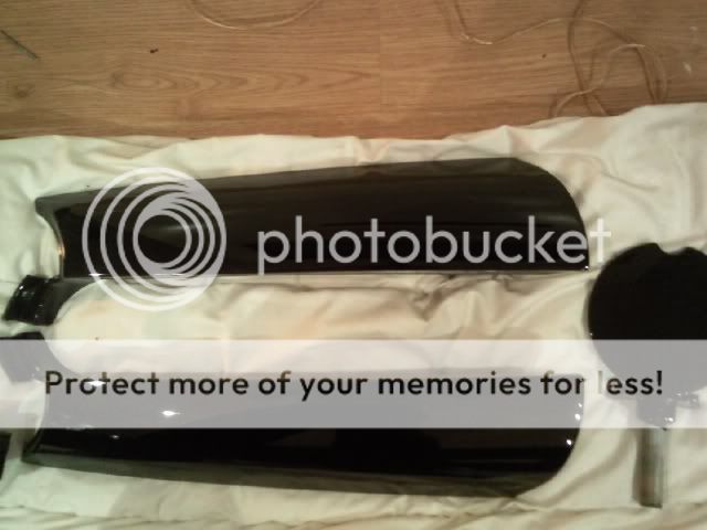

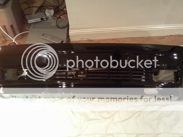

I have now moved on with my project and over the last few weeks been spending the cash.  The car is currently in the bodyshop having a full respray in the original black paint after being to the panel beaters where i had new inner and outer sills new bumper fixing points front and rear, new slam panel, all new fixing points on front and rear wings for arches.  I have bought all new panels, front and rear bumpers, ront and rear arches, new sideskirts and new bonnet and all new fixing clips and rubbers.  I have also had the tacky petrol cap removed from the boot and put back in the original place on the rear quarter.  I have bought all new lights including fogs and indicators.  I have also bought a few new parts from gt tuning, the dump valve, spider valve, in car boost valve.  I have spent £4000 lol. but its all worth it restoring one of these gt turbos.  here are a few pics of the project.

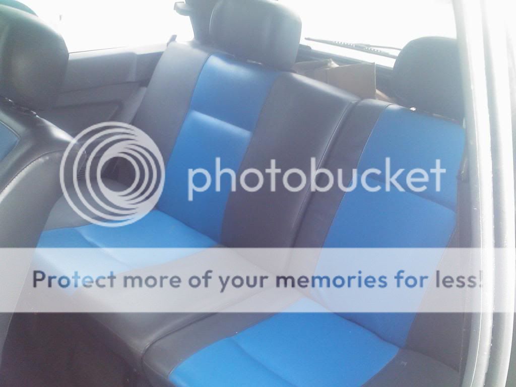

re-upholstered seats

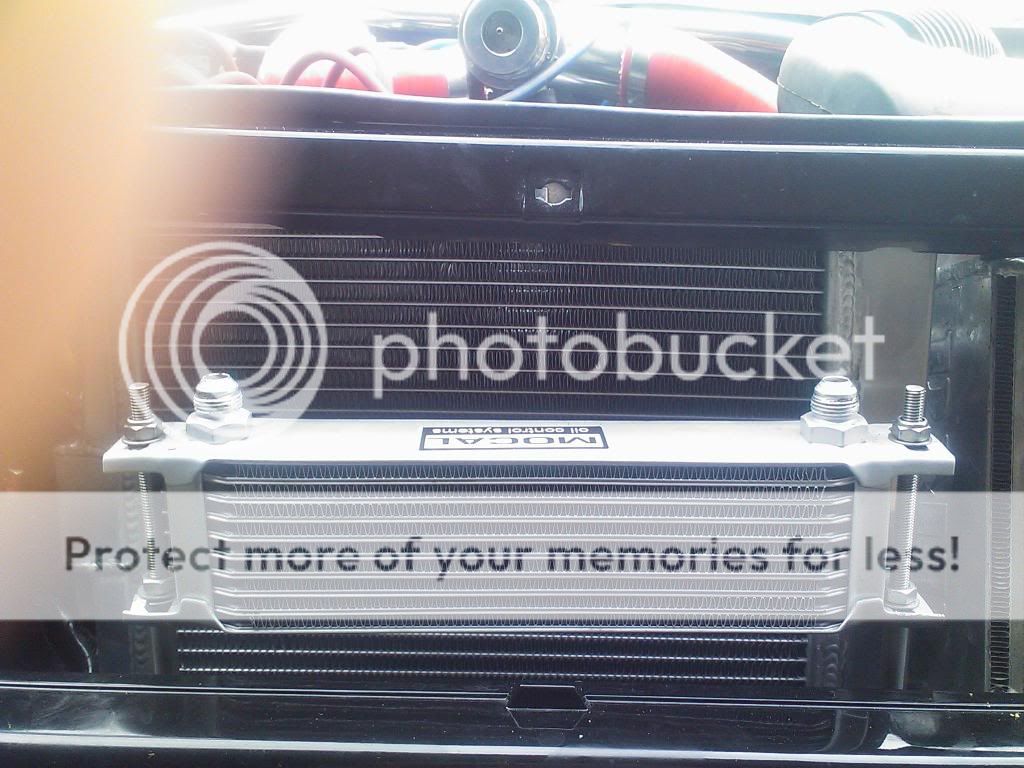

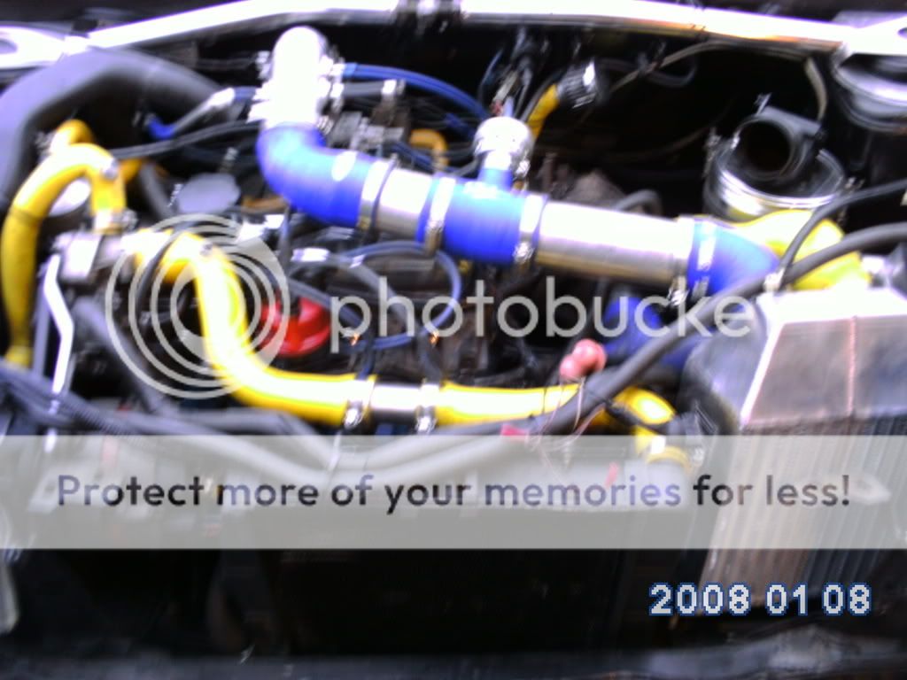

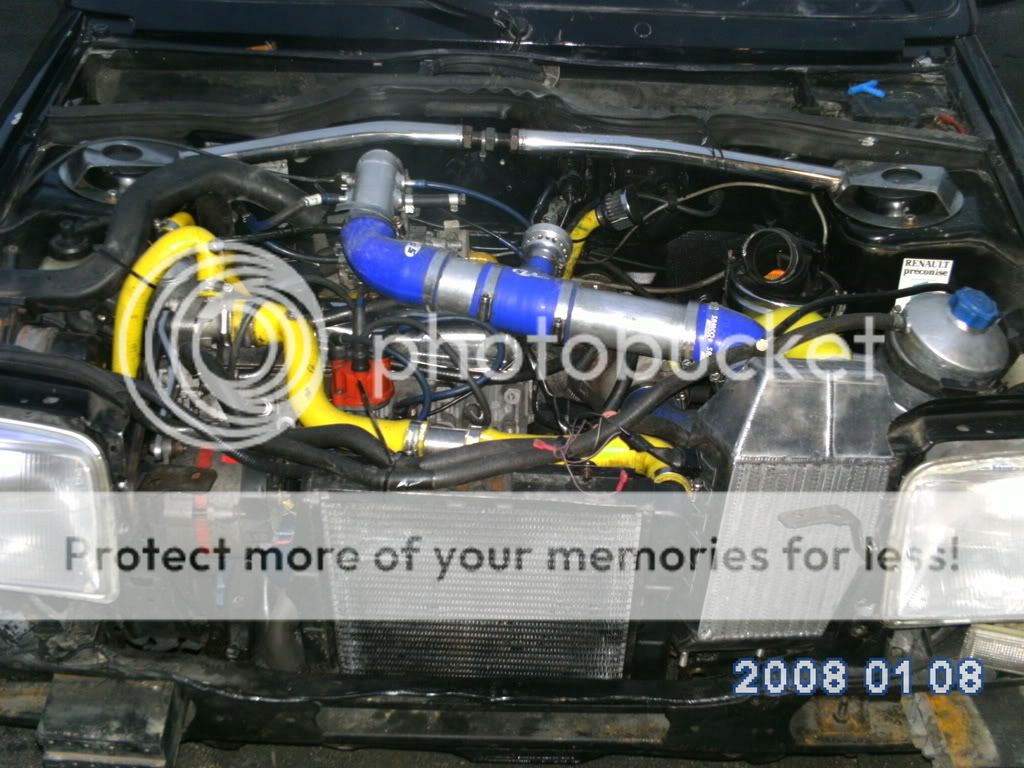

new oil cooler

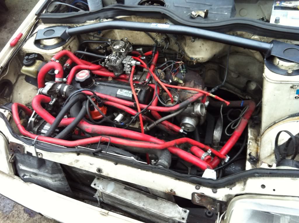

the engine bay

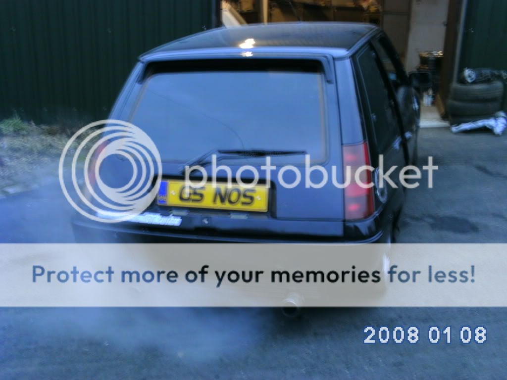

new exhaust sound amazing like a scooby kind of

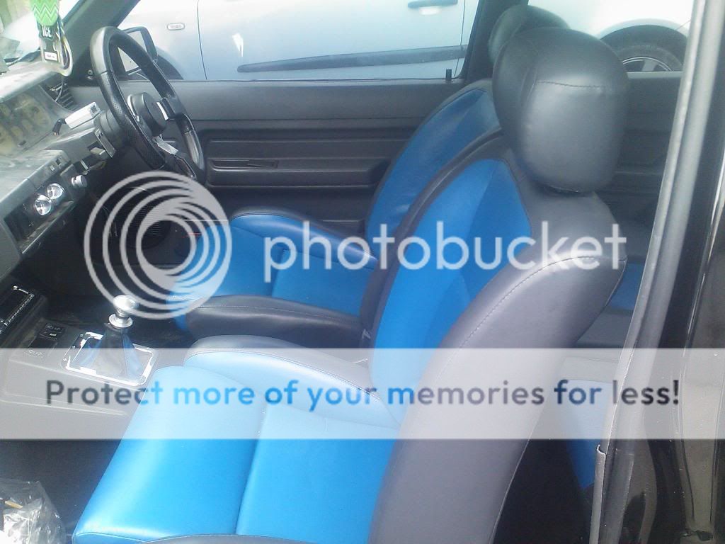

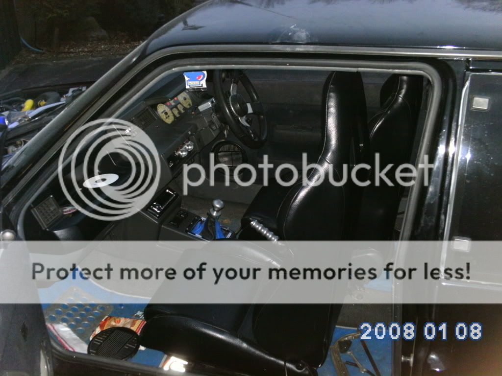

the interior fitted
plastic door cards not finished yet gonna do the pinstripe blue

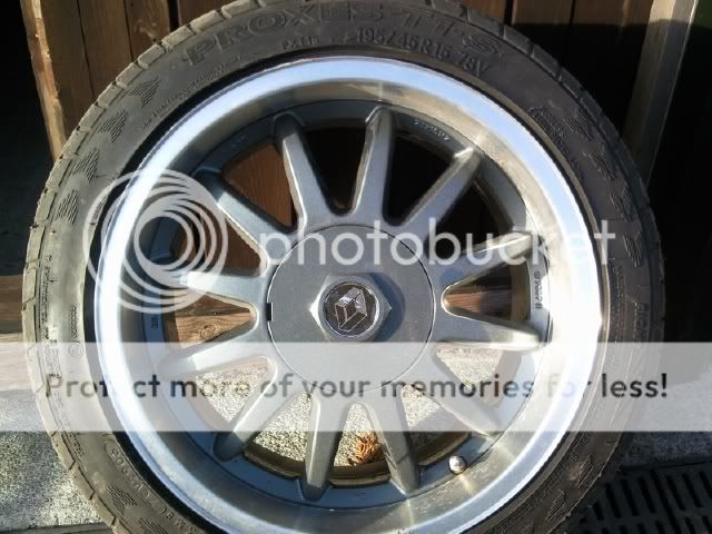

Interesting wheels, what are they off?
jonnyshaw49
  • Posts: 325
Re: Pics of my R5 - UPDATED 15/01/2010 pic heavy!!
« Reply #5 on: 21:53, Fri 15 January 2010 »
they are rh classics mate only 25 sets made originally vw fitment but slightly  altered to fit, i love the wheels only downside can get bigger than standard discs so had to whip the 285s off, but now running on tarox discs and ferodo pads.i think the alloys were originally marky marks on here but i bought them off a guy in mirfield.

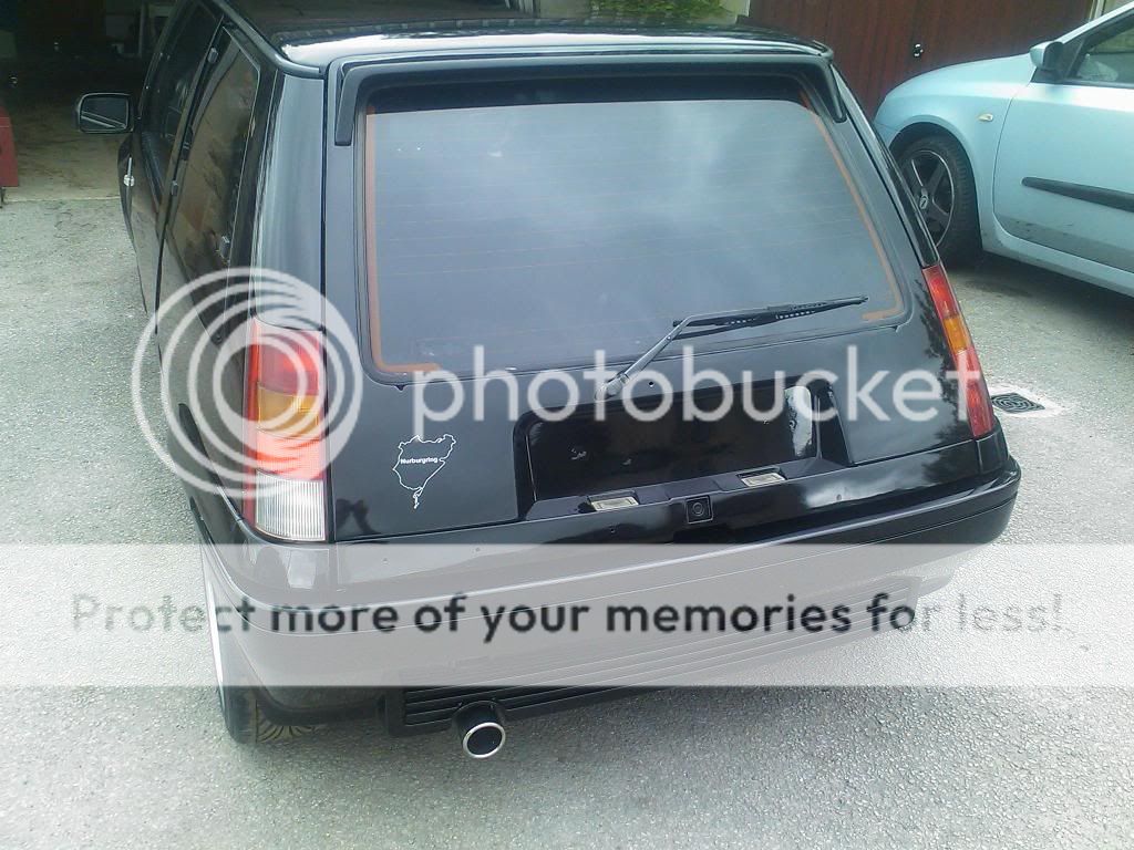

Hello mate, I can see that you have a Nürburgring sticker on your tailgate? Did you ever drive on the Nordschleife?? I drove there 3 years ago. One of the best experiences of my life :D

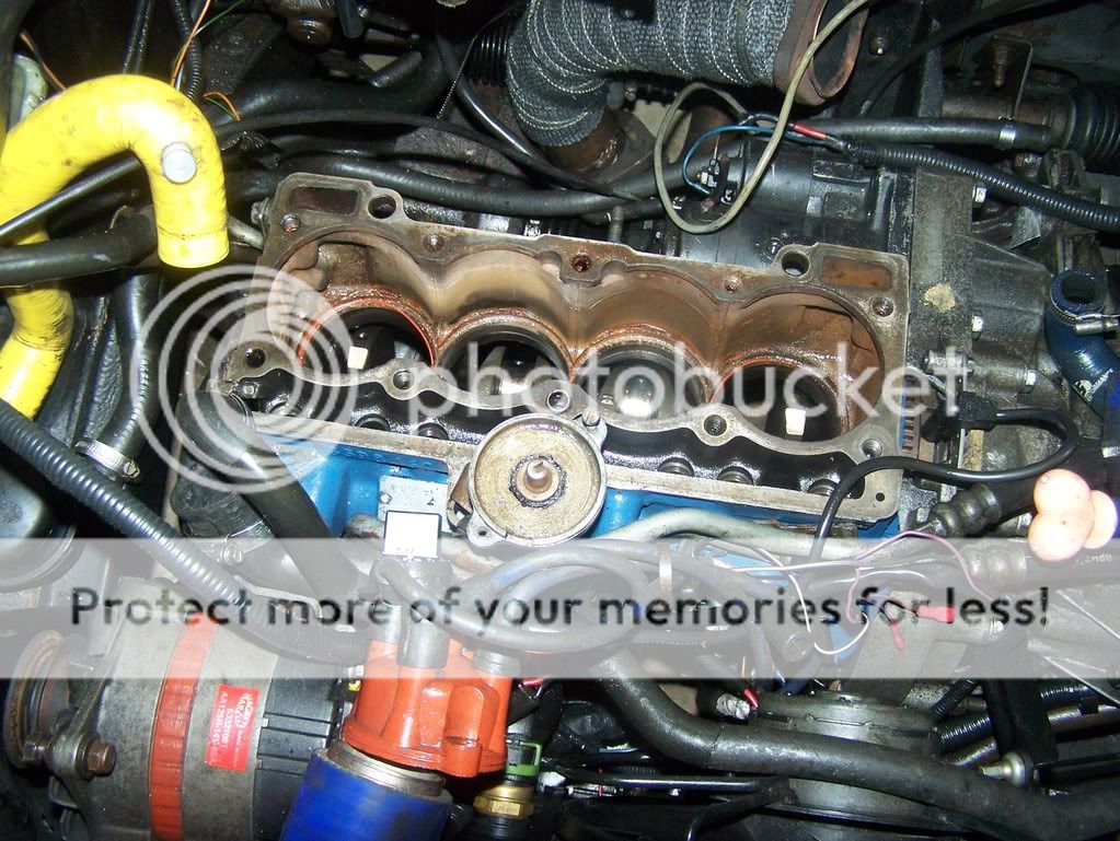

how did you get the liners out of the engine mate?
« Reply #11 on: 20:48, Sat 06 February 2010 »
Quote from: "hondaman"
They just lift out.
I undo the conrod then pull the whole piston and liner out, i find it easier to seperate that way. If the rings are quite tight on the liner i have trouble 'grabbing' the lip of the liner to pull it free with my sausage fingers.
hondaman
  • Posts: 82
« Reply #12 on: 22:59, Sun 07 February 2010 »
seriously!!!?? thats soo simple! i fucking love these cars the more i hear about em. do you have to press them in using a hydraulic press? or is it simply push em in with your hand??
« Reply #13 on: 23:32, Sun 07 February 2010 »
They just drop in, theres a small seal between the liner and block which are about £5 if that for all 4.
