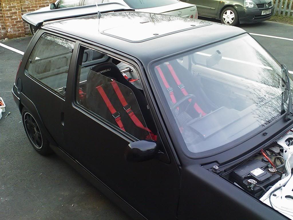

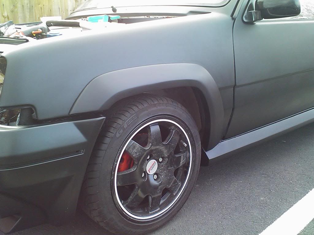

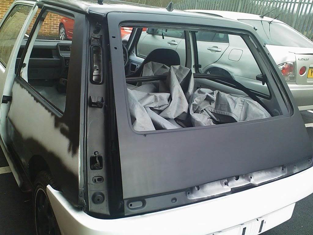

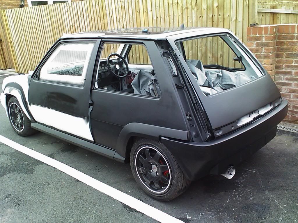

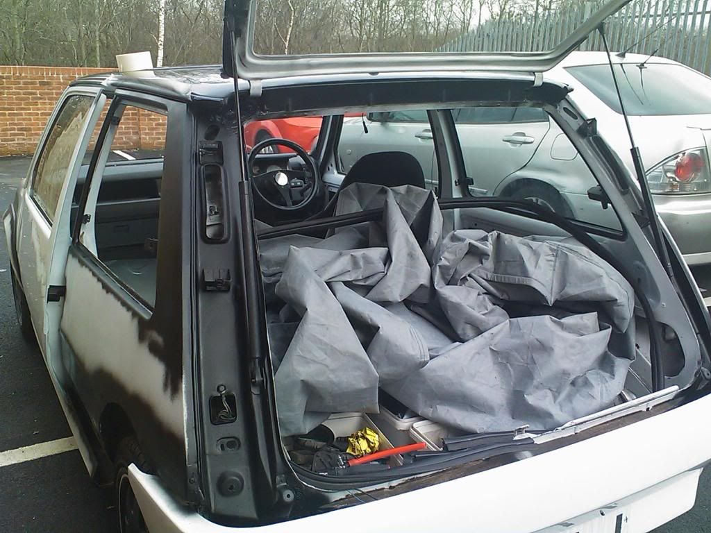

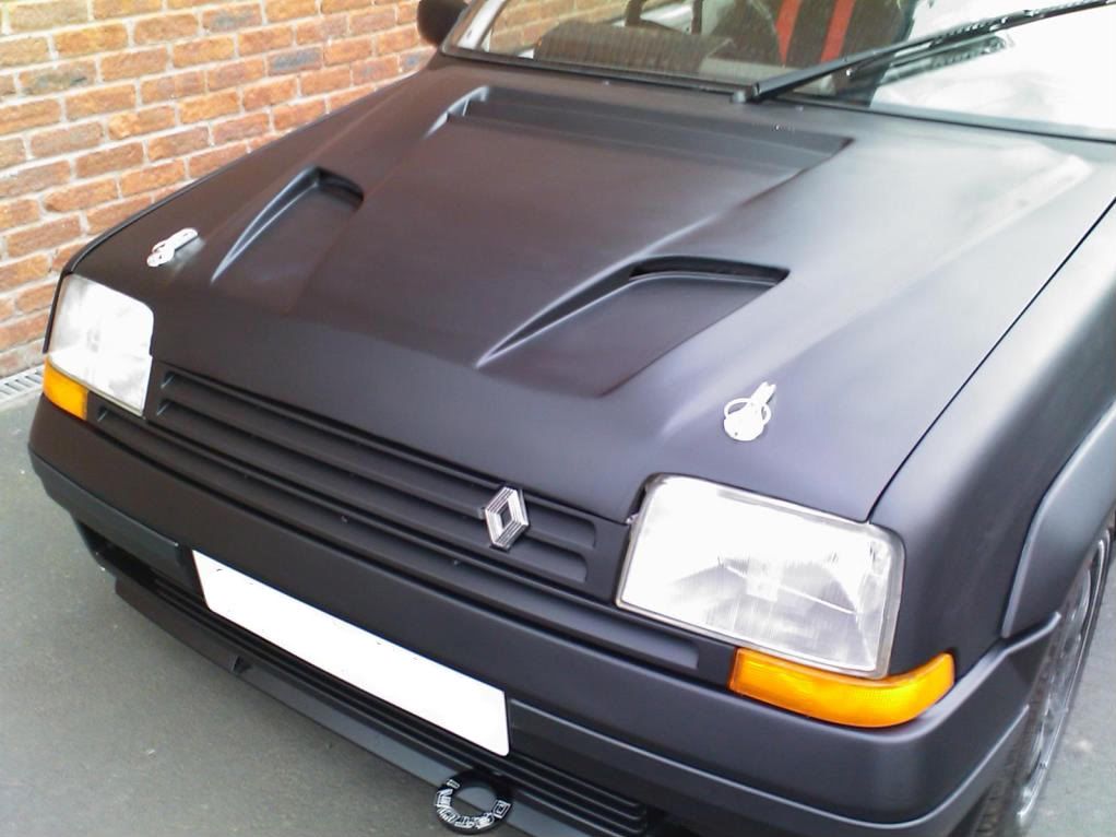

Here i go again, stripped the car down removing windows, lights, plastic trims, ect ect... and preped for spraying Matt Black
Spraying in progress.

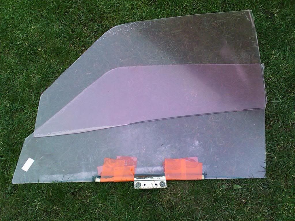

Then (Leigh200sx) turned up to do my perspex windows for me, Top bloke very helpfull and full of advice, was good to meet you fella :thumb:
The Man himself at work :wink:

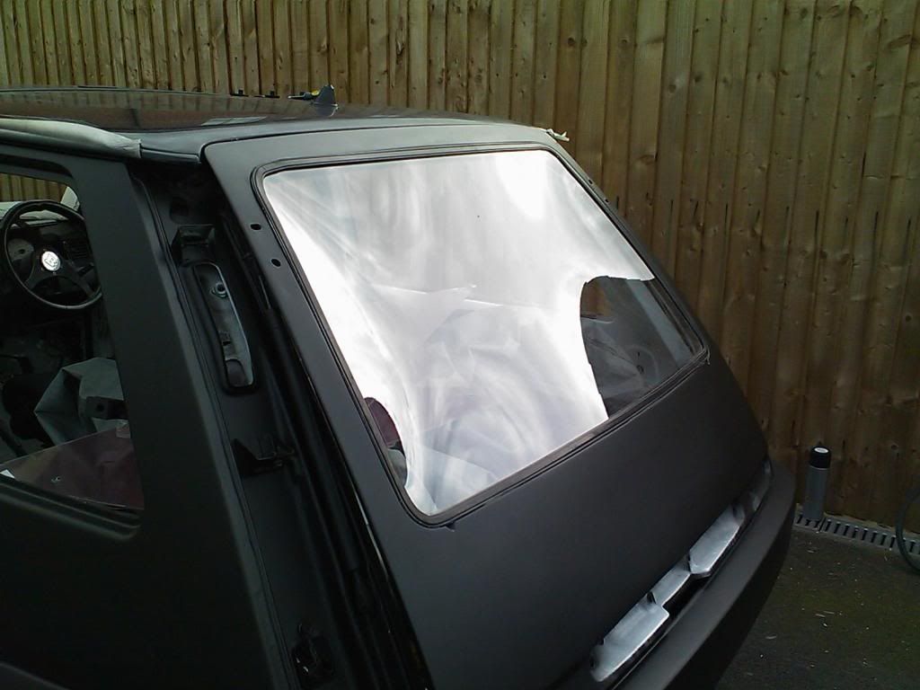

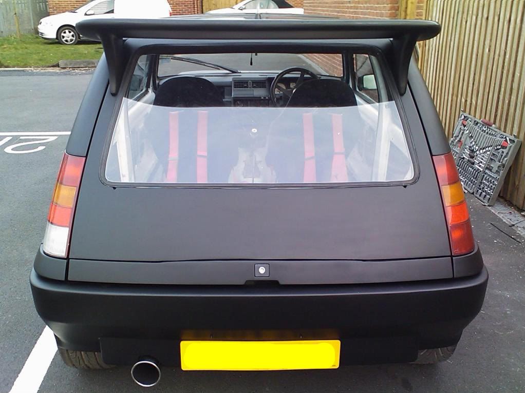

Rear window perspex fitted :P
Front windows in perspex, driverside has the fixing point moulded to it so i can use the driverside window if needed :P

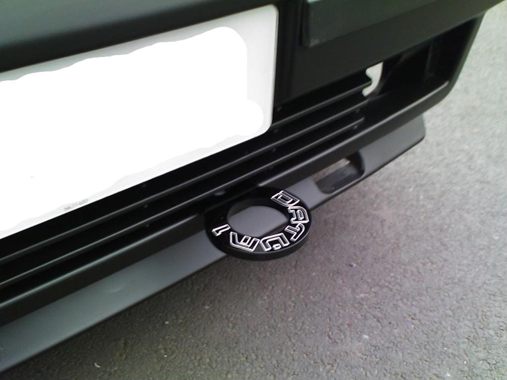

Also fitted my tow hook in the end.

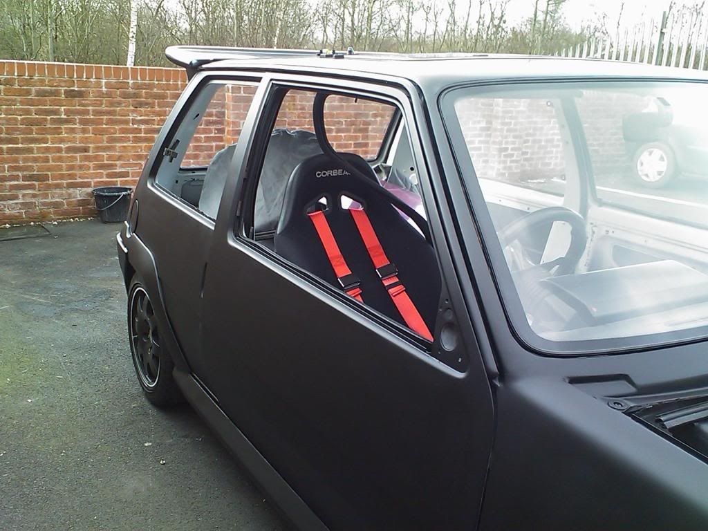

finishing off the spraying

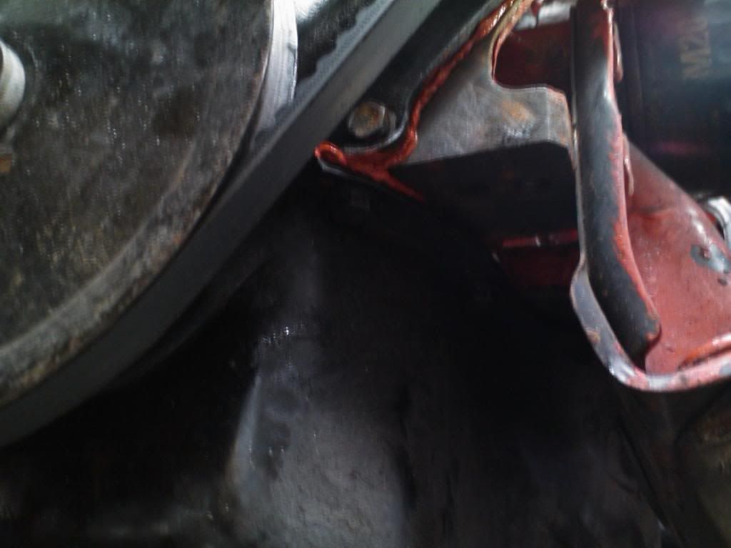

finally sorted out the oil leak from the sump and crank seal in the chain cover :P

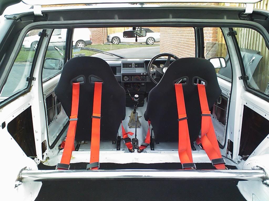

Had to remove pully, sump and chain cover to change the seals, Also checked the big ends while it was all off, then clean up apply new gasket sealent and put back together. job done :!:
Seats back in with harnesses.

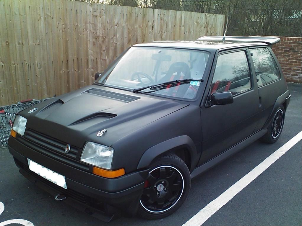

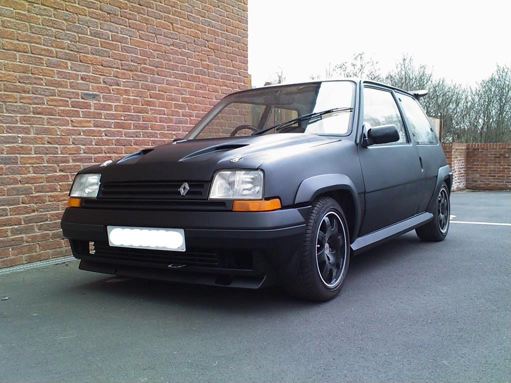

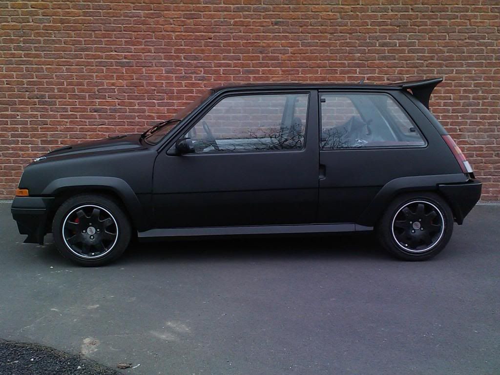

its all finished and ready for the road :P  just waiting for my tax to come :cry: , then ill be able to get it tuned :P
