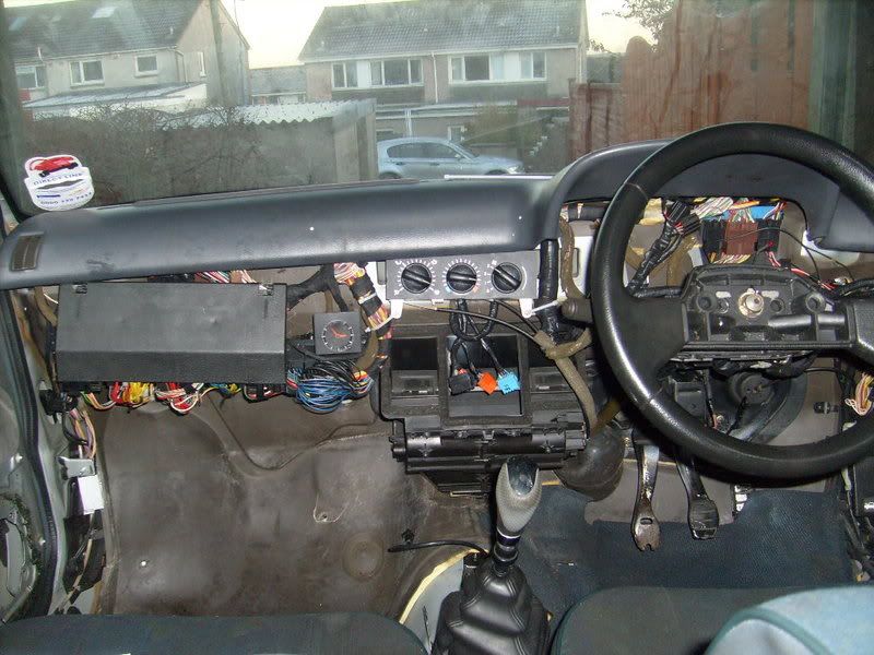

This is my dash ...custom made by me for weight saving :lol: -

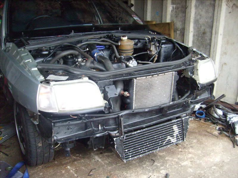

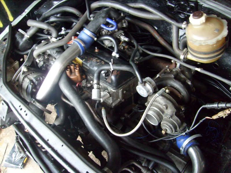

Also all pipes on and intercooler pipes chopped to size -
Another pic -
Also the water de-gass pipe has been straightened up before someone comments :)
Also as you can see by them pics i got the turbo span ok ...courtesy of your lovely help on this forum :) Thanks!
A quick rundown of whats been done -
 Well heres todays progress....
Its all wired up courtesyof my mate reco ...bar the fuel pump and radiator ...we are just going to put switches on the dash for them :)
The coil has power,starter has power ...it cranks over ...it just doesnt start. We inspected that the coil wasnt producing a spark which we recon is down to the TDC sensor. Ive been told that my TDC sensor from my old engine will fit.
The exhaust is all bolted on aswell. We had to take intercooler off to get into the alternator so ill have to hook that back up. Also im going to fluid the car up ..inc fuel aswell.
So progress is good with my clio.. hopefully it will be running next weekend :)
No pics as there isnt much to see :lol: ..thanks for reading :)
