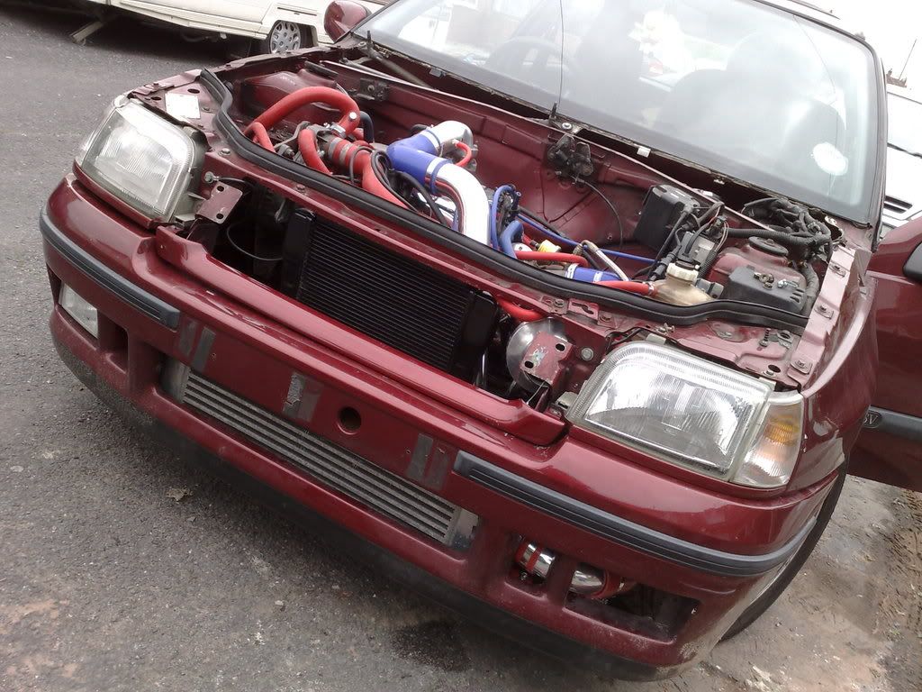

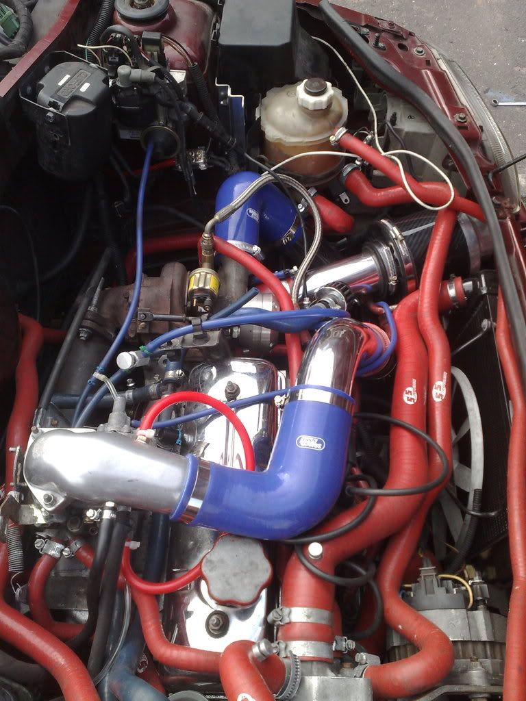

i know what your going 2 say not another clio conversion lmao
spec
fully rebuilt bottom end / ported and polished head with uprated valve springs / piper 285 cam and vernior pully / grounp A carb / balanced and lightened flywheel with uprated clutch balanced to match / T25 turbo / front mount intercooler / ktec 2.5'' turbo elbow / ktec 2.5'' side exit exhaust. shes running 190bhp at 16psi lookingn 2 have her running over 200bhp by the end of the year
all conversion work done by myself my mate built the enigne. Brought it off him as he is fitting a megane 225 turbo lump in his 5
heres some pics
all pics are from before i finished her comments welcome  8)

Looks good that !!
Looking forward to seeing the finished pics !!

Looking really good matey, keep the thread posted with all your developments and pics. Top work 8)
« Reply #4 on: 22:20, Mon 16 June 2008 »
looking good cant wait to see the end result
« Reply #5 on: 23:31, Mon 16 June 2008 »
Keep us posted...  still like these Clios..  good work  8)   how do you find your group A carb?   does it run quite rich even without pushing it?
 BTW...  any chance of getting your mate to start a project thread on here with his megane 225 conversion in his 5!!  :twisted:  sounds like its gonna be an animal  :D

it does sound that it will but iwould have thought since its a big block engine that he'd struggle to get it fitted into the 5 unless he does a load of cutting and welding to get it to fit

the megane engine went stright in he just has 2 make a custom exhaust manifold and he has made a plate 2 fit a gearbox

runs quite rich on idle but seems to be fine on boost im new 2 theses engines so im learning as i go along lol lucky for my mate knows just about everything about them  :D
