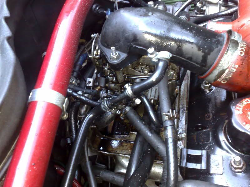

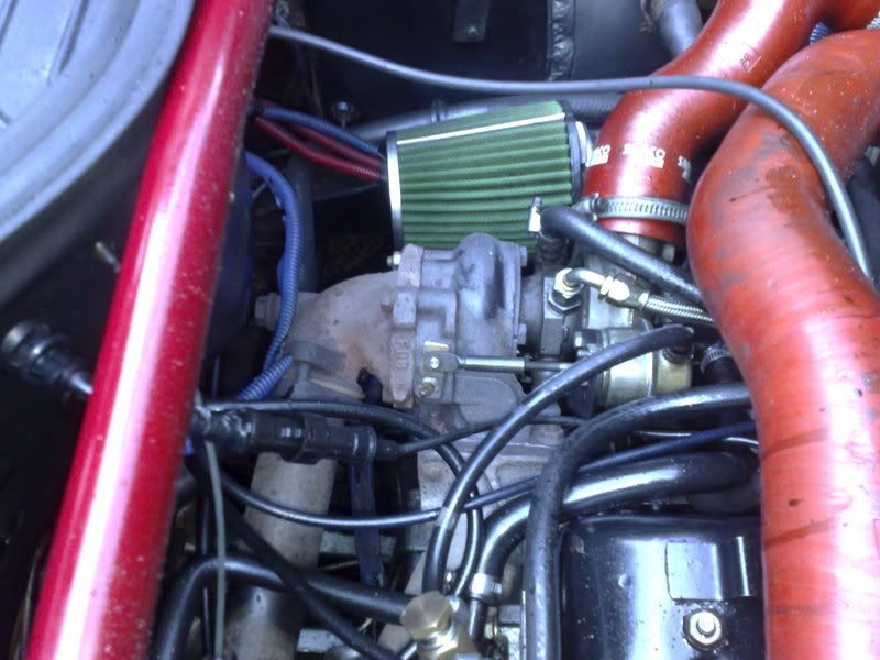

Ok so i brought a R5 , having a few problems but it mostly seems ok, dipstick keeps blowing out, and there is oil every in the engine bay, (i dont think dipstick is the only thing to blame,.
anyhow the car
and engine, the car is going to be having all bodywork etc done , so dont worry about that :), any ideas on engine problems, the breathers seem crazy how they are setup/

From the pic your breather system looks ok (standard) I would make sure it clear and free of blockages and make sure the 2 x restrictors are in place.
With regards to the dipstick does it move in and out to freely of the oil level tube?? If so just put a bit of tap around the top of the dipstick to keep it in tight or squash the top of the tube a tad to make it tighter
« Reply #4 on: 08:44, Tue 08 April 2008 »
I came from 205 GTIs aswell, the GT turbo engine isn't that hard to get around once you figure out what does what.  8)
Trust me, you will have your head under the bonnet a lot.
Dipstick popping out is usually a sign of worn rings, do a compression test to rule out the worst.
As for the breather setup, there should be a picture on here somewhere for the 'cup mod', that gets rid of the breather pipe into the turbo intake which is worth doing.
