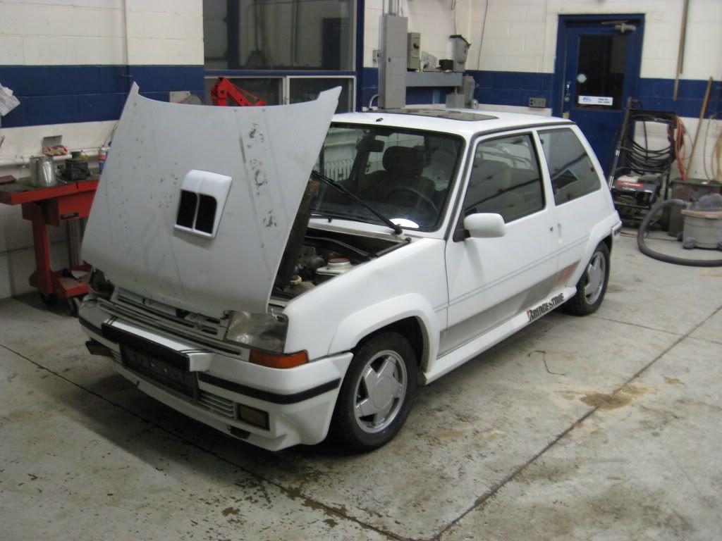

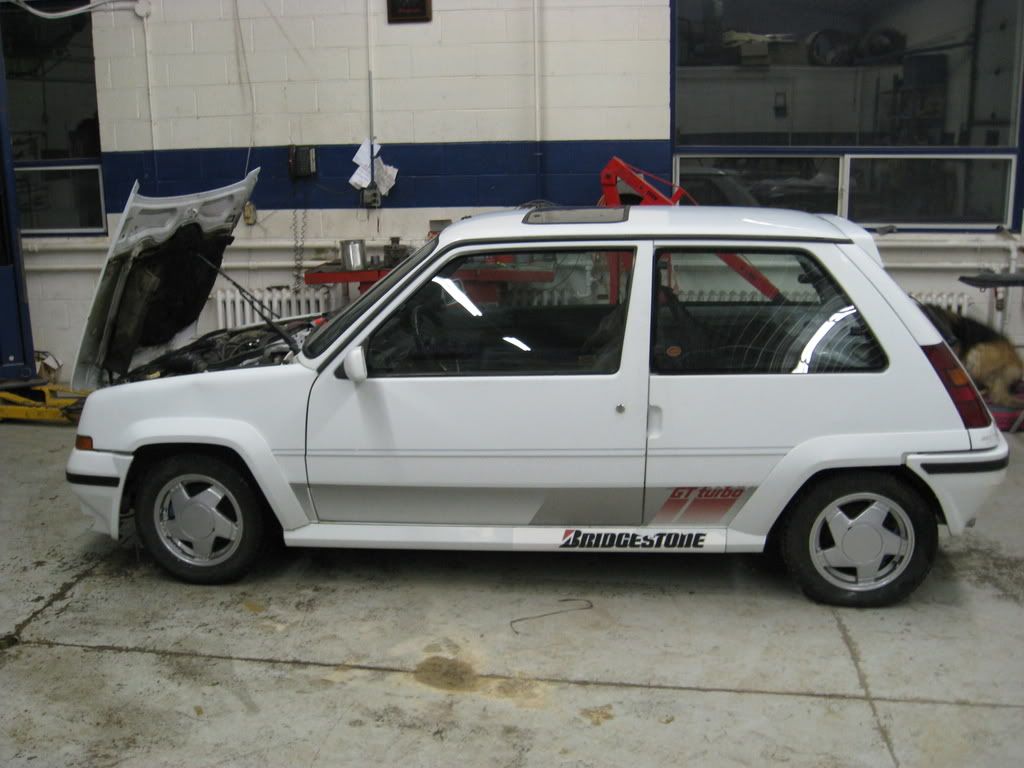

here's how the car sits as of now, we stripping it this week, hopefully it'll go on the rotisserie in a month, and I can fab up new subframe and a-arms.

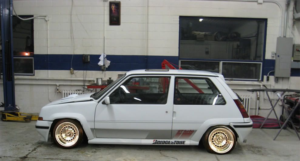

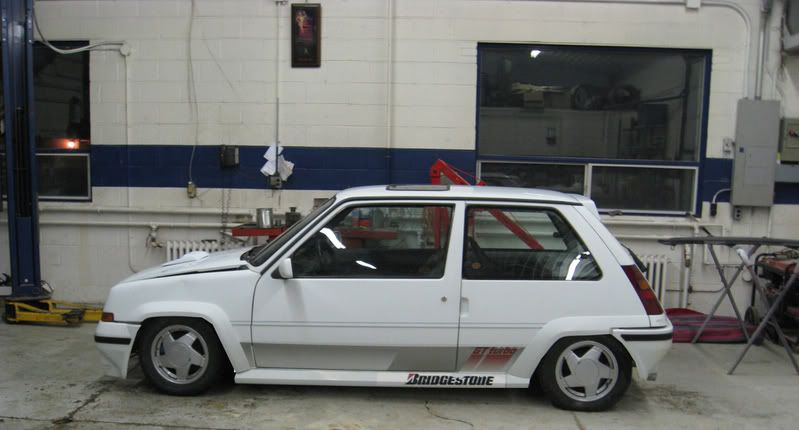

I quickly p-chop'd the car
lowered (reverse rake)
lowered + TH line

You may struggle to find a wide 'euro' style rim that fits the rear of the gtt, especially if you lower it alot.
If you want decent 1/4 mile times you will need propper drag slicks, not track race tyres (they take to long to warm up), something like Mickey thomsons or M&H, again you will struggle to get them to fit if you go for a small wheel & dropped to the max.

also loose bonnet vent looks a bit iffy :?

hehe, about the body, that's the part where Mike's expertise comes to play. I personally want 15x8 all around or 15x8.5 with 195/45/15 or 205, I still have yet to look into the whole rear beam thing, since never dealt with such design before, I was hoping may be gain 1 degree of camber at the rear and gain some toe in while playing with it.
