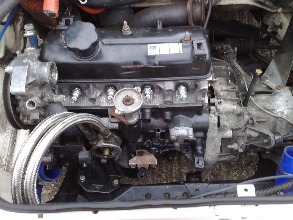

« Reply #36 on: 10:40, Tue 03 June 2008 »
Thanks to the info on the Rads. I've checked mine out and looks like it's high volume unit anyway (without oil cooler) Will probably change to alloy one at some point but funds are short...
Anyway I've finally got the engine back and has been transplanted back into my Coupe..
Although not all parts back on yet. See pics below as to how far I've got.
As you can see still a little way off just need to find some time. I'm hoping to take it to Renault World Series this weekend at Silverstone I'll probably be bolting bits on there!!!!

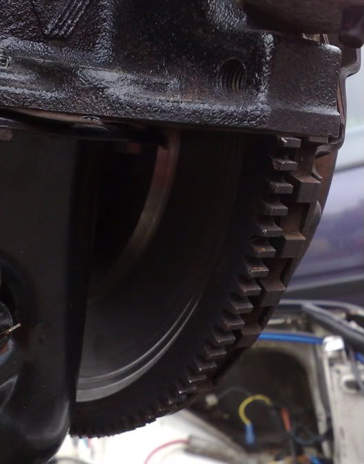

It's has has had ported polished head and inlet manifold, lightened and ballanced crank and flywheel plus all new bearingins and rings etc...
Also got a Blitz Turbo management system to go on as well (Courtesy of my team mates Scooby)
Engine Bay
Lighented Flywheel
