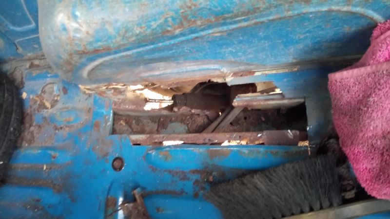

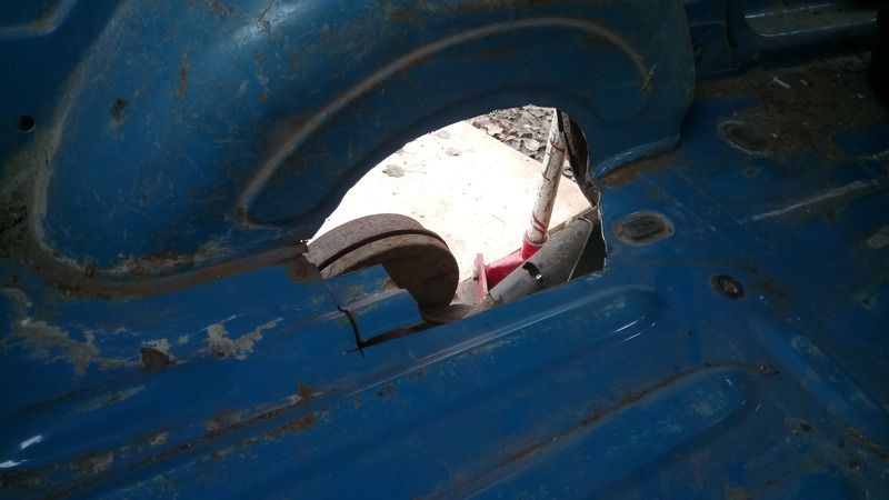

Ah well better get on with it, lifted the ply floor up as I had spotted a bit of grot by the arches. Started to cut it out then had to drop the spare wheel so jacked it up and got my first look underneath. Oh crap! Drivers floor pan is hanging out. Looks like it was welded with a large panel from inside so the original floor has rotted off and left the chassis leg in space!
After some swearing I thought ****it there aint many left so I may as well save it :)

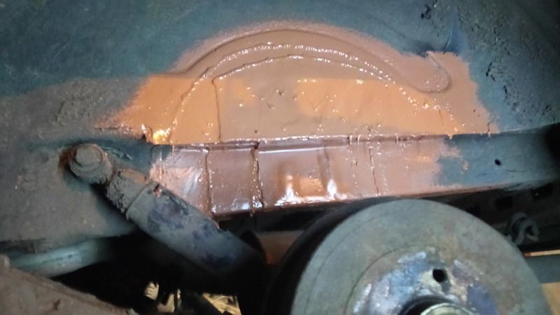

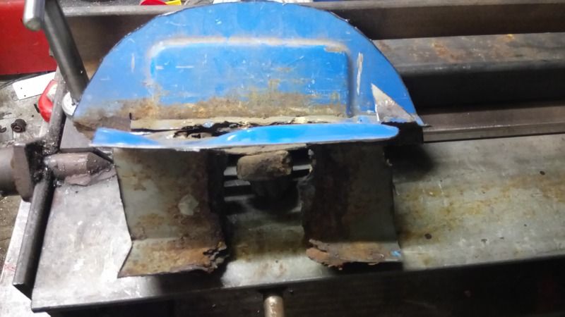

Grot by the arches is first to go.
That's the worst of it out and I now have an idea of how it was made.
A few hours later and the passenger side is in, just need to make a bracket for the bump stop rubber which will be bolted in rather than welded to reduce water/grot trapping.

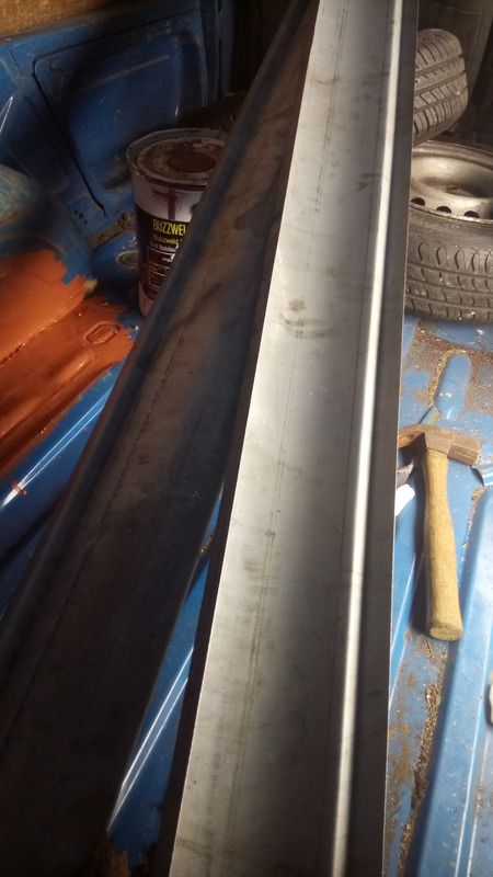

I also cut a section of sill out today and popped into a friendly fabbing shop down the road. Couple of hours later I popped back and got a pair of sills :) Not quite the correct profile but as new ones seem to be made of unobtainium they will do and they only cost me 30 quid :)
