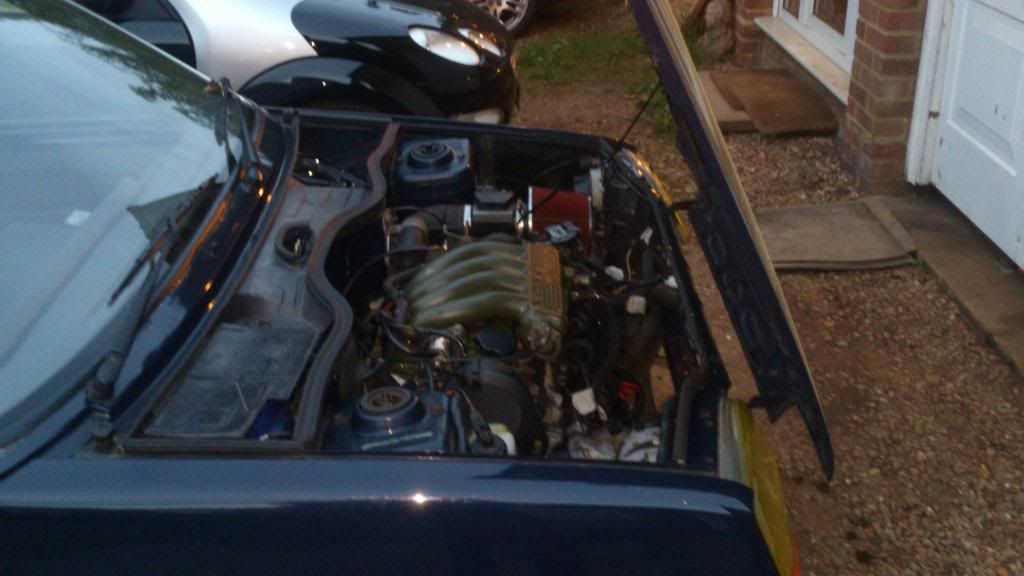

Re: Campus Build
« Reply #20 on: 22:22, Wed 22 May 2013 »
Step 2:  Fit proper engine.
Re-used campus gearbox (btw 2 dowels need to be removed to use it)
Connected both gearbox mounts
Gear shifter
Speedo drive
Clutch
Both driveshafts
Exhaust downpipe
Reconnect shocks
Starter motor
On tomorrows to do list.
Modify and fit front engine mount, its gonna need more work than i realised
Get smaller aux belt
Get some gearbox fliud
Connect fuel lines
And then try to make sense of either the wiring or the plumbing
Re: Campus Build
« Reply #21 on: 21:41, Mon 27 May 2013 »
Half the wiring done. I just have to find the fuel pump relay and interrupt it with the new fuel pump feed (i think anyway)
Whilst checking the fuel pressure its starting to seep from one of my joints, so i have to make that a more permenant fitting.
Hole cut through firewall for nice neat loom grommet.
Front engine mount chopped up and fitted
Gonna get the aux belt tomorrow and give the gearbox some fresh oil.
Then figure out the plumbing for coolant and intercooler and im pretty much done.

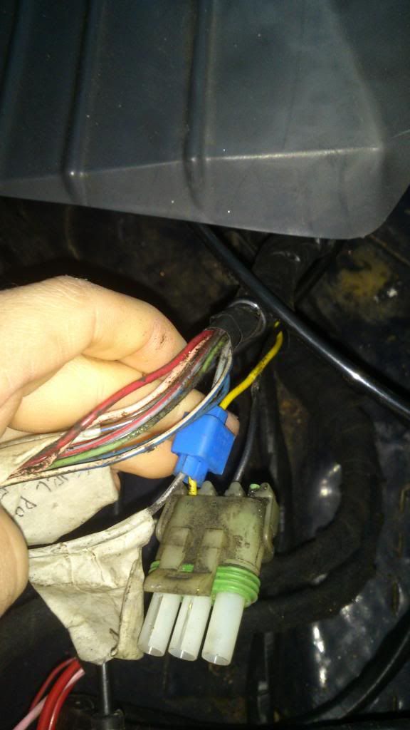

Re: Campus Build
« Reply #22 on: 21:29, Tue 28 May 2013 »
Fuck this car!  All of the coolant pipes will need chopping about to fit, the intercooler doesnt fit. Ive borrowed my mates and i cant get that to fit.
The fuel pump wire is a mystery, ive tried to tap straight into the fuel pump relay (which i figured was the one that made a noise when ignition was on). But i tried every wire down there, even removing the relay and trying every wire again.
All i get when cranking is a struggle to start then itll only run for half a second while im still cranking.

Howabout this.
If i run a line directly to the fuel pump live from the fuel pump signal from the new loom, then a local earth on the pump.
Disconnecting the original loom all together?
Re: Campus Build
« Reply #27 on: 20:43, Wed 29 May 2013 »
Ok ive figured it out.   had the fuel lines the wrong way round  :lol:
Fuel pump live to that thick brown wire with the relay missing and boom, shes alive.

Re: Campus Build
« Reply #29 on: 21:19, Sun 02 June 2013 »
Ok the cars 99% done :D
Its all in and connected up but ive got issues with the water flow, so still need to look at that, but otherwise, all done. Cant wait to drive it.
My buddy lemme borrow his intercooler and piping and rad whilst his is off the road.
Starts and ticks over like a beaut. Even with the cooling issues, its getting real pressure in the cooling and nothing leaking or popping off.
