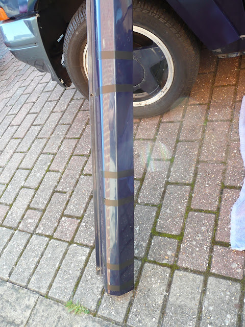

hi.. probably not the best way.. but this is how i fitted the side skirts  :oops:
First off i taped off where each mounting clip was on the sideskirt, this tape was visable all around the side skirt.
Starting where the clips were..
and going right around the side skirt...

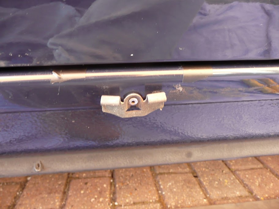

then holding this up to the sill.. i was able to repeat with more tape.. marking where the clips would mount below on the sill. You can just make this out on the image below.. tape on sill & on side skirt.
next.. i set about drilling the hold into the sill for the rivet so i could mount the clips. The hole is drilled exactly above the crease line of the sill. I was able to find this out form the original Raider wing I had, which still had one clip mount.
The rustproof rivet was dipped into underseal wax and then riveted in place thru the mounting clip.
This was completed all the way along the sill as required by the tape markings. I could then hang the side skirt on the sill freely.
then i drilled into the lower part of the sill so i could fix the bottom part of the side skirt to the sill itself. This was done easily with black self tapping screws.
