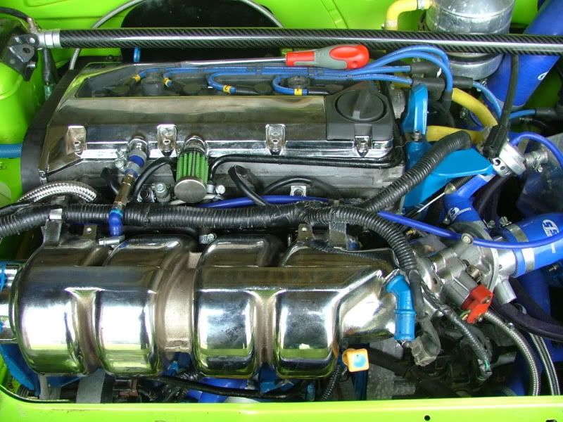

Well bought a fully forged engine last week, 6 puk clutch, some sensors & the loom ready to make up to go on adaptronic, just leaves exhaust (if the sidey doesn't fit) ecu & turbo, plan is 2871r & over 300hp
Engine porn  8)
Engine in the old car
Will post some pics up as I collect more parts...
Spec
Spec:
F7P 1.8 Litre 16-Valve
De-stressed and chemically cleaned to remove carbon and then acid dipped to remove scaly corrosion deposits from water ways.
Re-bored with main caps fitted to suit piston size.
Minimal surface reface for blueprinting
All Headbolt and Main bolt threads are re-cut and cleaned
Turbo oil drain fitting
Wossener 8.0:1 82.7mm Forged Pistons
Reworked And Balanced Crank
Brand New Megane Oil Pump
Baffled Sump
Modified Main Bearings
Arrow Steel Rods And ARP Bolts
Uprated Main Bolts
Wire Ringed Block
Standard Payne Head Gasket
APD Big Valve Head With Megane Inlets
Piper High Lift Short Duration Turbo Cams
Catcam Adjustable Pulleys
Standard Head Bolts
Cossie grey injectors
Chrome Plated Rocker Cover
Chrome Plated Inlet Manifold
Chrome Plated Fuel Rail
Chrome Plated Cam Belt Cover
Volvo 215 flywheel with helix 6 paddle center (for now)
