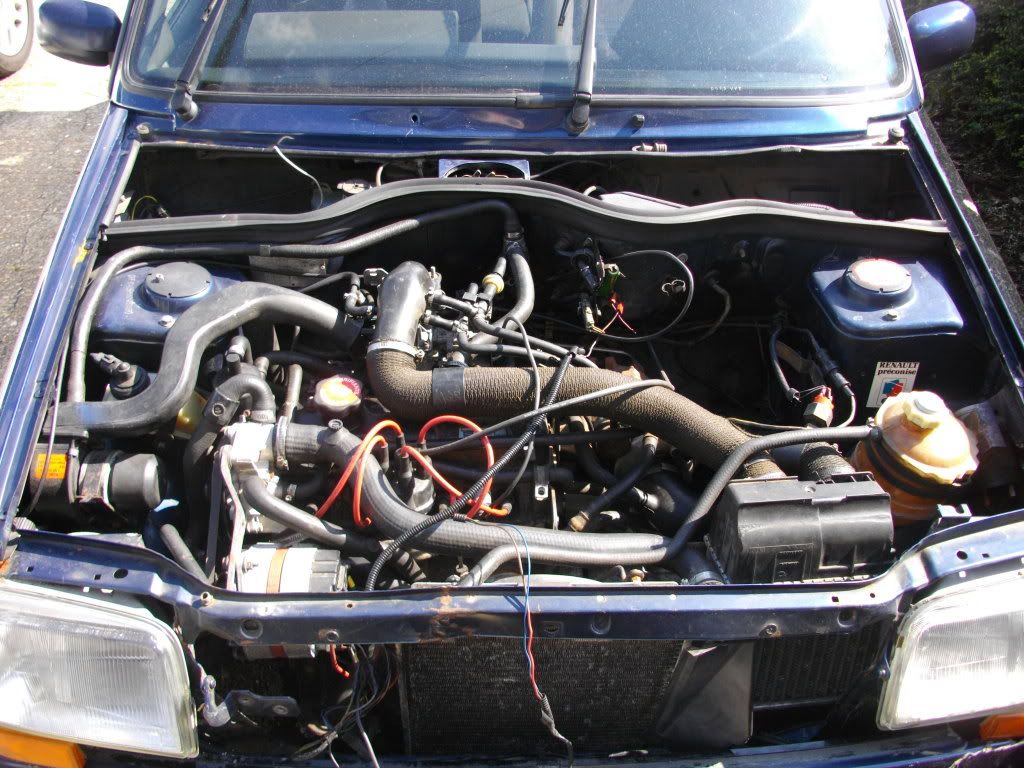

hi all i picked this up the other week, i saw it sat on a drive near by looking very sorry for its self so thought i would try my luck by knocking on the door, a few hours and pound notes later the car was sat on my drive along with 2 truck loads of spares to finish it......... apparently!!
the interior is pretty clean and the underside seems fairly rust free as it was stored in a garage till 2 months before i spotted it.
The old fella i brought it off seems to like to tinker but with no rhyme or reason so there are random bits taken off the engine which i need to refit to establish how good the engine is, the body work again has ben knocked and bumped around, i will sort this but not before the car is running so i know what i am dealing with.
i am sure i will be calling upon the knowledge on here to help with alot of this, i have owned 5's before but a few years ago so i am having to wrack the old memory box with this one.
pics of it looking sorry for its self
slowly piecing the jigsaw together now, i do need to source the front loom still as my has been cut beyond all recognision... thanks for that!
all the drive shafts are in and the exhaust bolted up, this will be treated to a new one after its mot but for now its gonna have to keep rocking the PECO big bore 4..... oh yeah!!

i am also having a little trouble with a miss fire, i have changed leads cap and arm but not sure if its the 6 year old fuel in the car which is not helping the situation either.

i have sorted the miss fire now, where the car had been sat up i think the valves had got stuck, i have come along tried to turn it over and it bent 2 push rods which the came out from under the rocker. i have replaced these now and it seems to run lovely which is a big relief.
i will get a pick of the bent ones up soon
